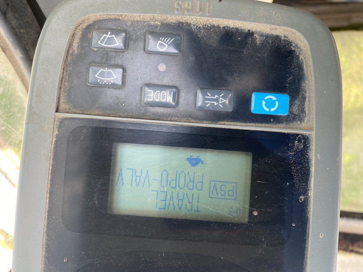

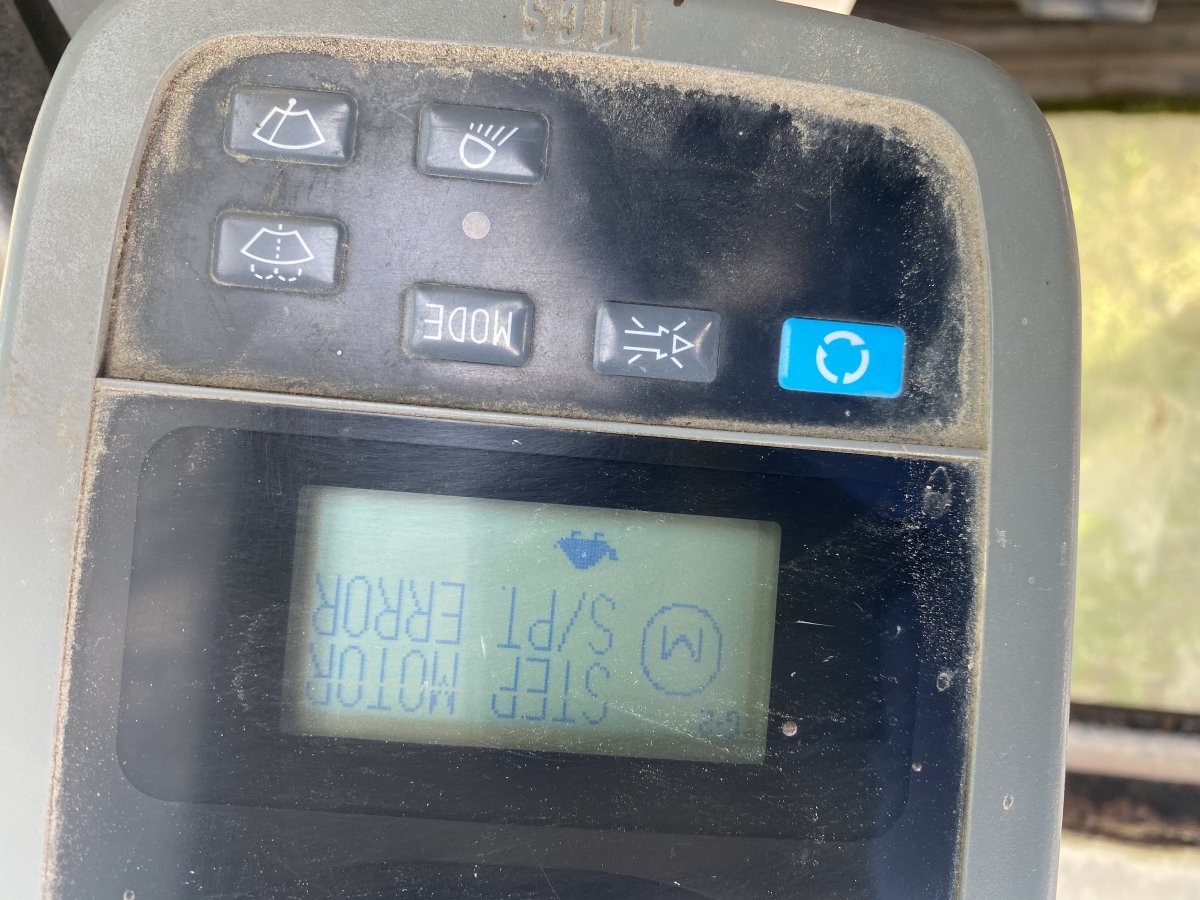

Hi got a kobelco SK135SR and we have several faults showing and she won’t rev up or shut off on the key.. main fault is ROM DATA FAILURE.. can anyone advise repair.. I’m thinking computer faults..
three options Rory ..... see aboveTwooptions, Proper repair, or Cable Control/Stop.
Proper repair is electrical engineer and some coin, I expect it's a corroded electrical plug somewhere but could be £££'s,
Other option would be to run a cable throttle and cable stop control.
Two options, Proper repair, or Cable Control/Stop.
Hi I have already spoken to them but they said they couldn’t help..you can send the ecu off to be checked ,d king agri electronics will do them
good call ... I've had a faulty alternator/regulator throw up all sorts of weird issues on kit before now too .... and'd never credit it to thatTry disconnecting the alternator, had that on a machine once, alternator was faulty and back feeding the ignition system and this was causing some strange faults!
Might be a long shot, but will cost nothing to try it.
You could try Alliance electronics, they mainly do truck/bus stuff, but worth a call?Hi I have already spoken to them but they said they couldn’t help..
