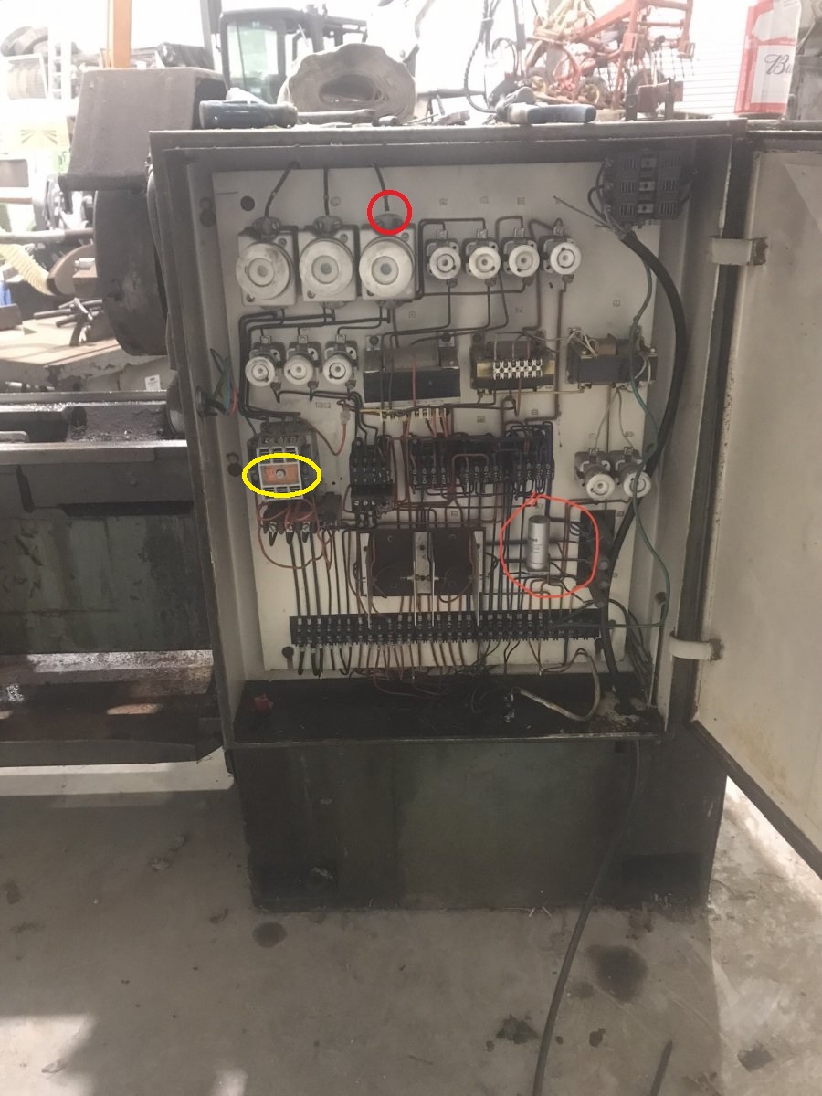

Next question - I’ve chucked some wires into the lathe and can get it to make noises if I push in the buttons inside the electrical panel, but the controls on the front don’t do anything. I’m no electrician and I’m certainly not getting heavily involved in this as I will definitely die…
What it the little silver jobby circled below? It seems to spark at random (which is rather disconcerting!)
Is neutral hooked up?
Can't see. The control side might need it
deffo I'd have thought if lo-volt, but can't see a Neutral post , so might just be transformed straight down from 440 .... a clearer pic would help a lot
see if the orange bit (circled yellow) will move inwards with a well insulated screwdriver MB .... looks to be the main motor contactor ... pushing it home (if it's a moving type) should fire up the main motor
Yeah, push that and stuff happens.

No - I can’t see where to connect it so left it out of the mix. It could well be the issue though!
Is this supposed to be this fierce?…

as in the motor fires up ???
may well be no neutral and just three phases ... only need neutral to split 240 out off phase legs ... lot of continental stuff is just 3 legs and transformed down to whatever they want
"fierce" ..:oops::LOL:.... stay well away from that MB :oops::oops:... has the capacity to do some serious damage 🥲 - has shorted to case - new one required ....
disconnect from supply ...
leave a while ...
wear good thick rubber gloves and earth it with a jump lead to be certain it's fully discharged ..
then inspect for info/details/credentials ...
buy new one and fit ;)
on edit
should find a new capacitor easy enough ..... once you have the details .. treat that with the utmost of respect that is some arc

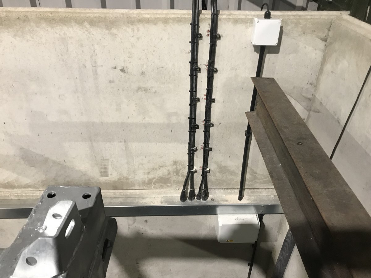

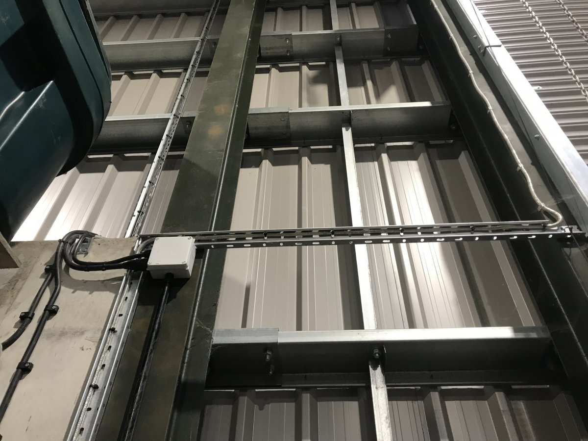

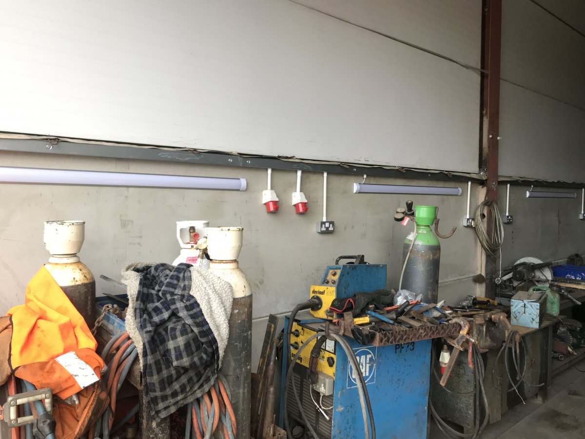

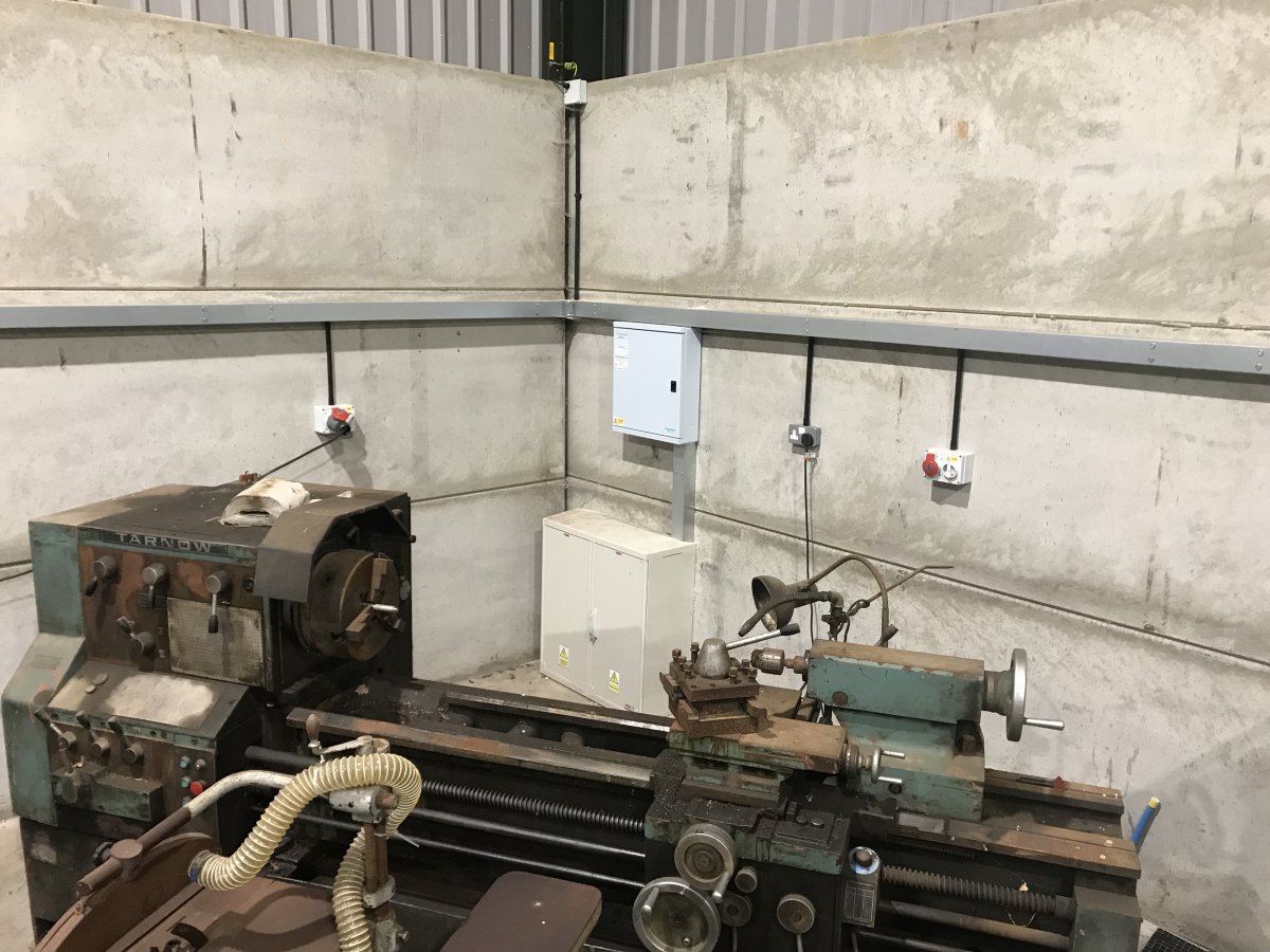

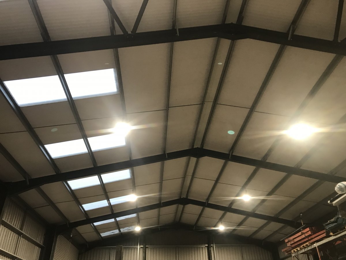

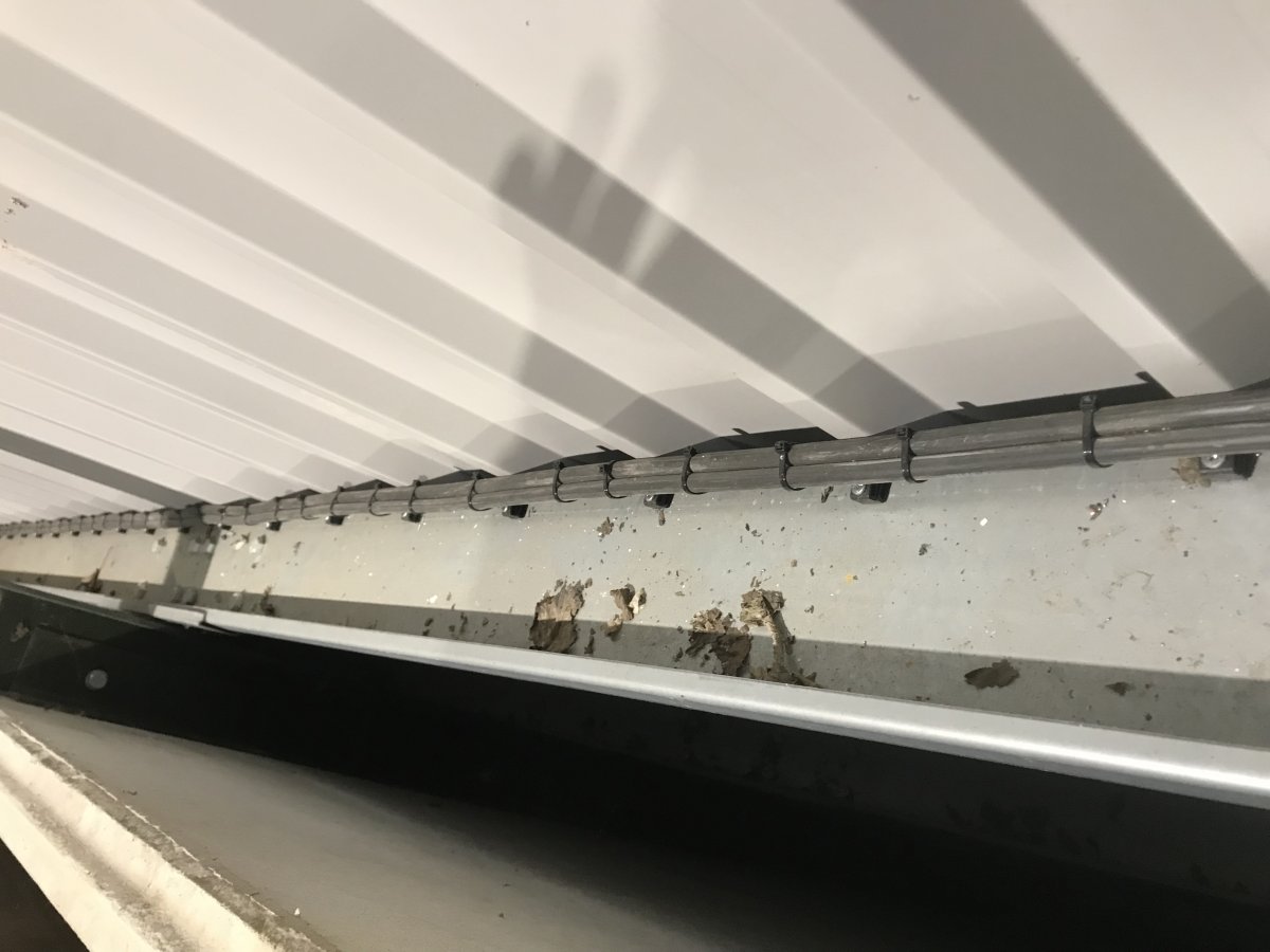

well this is my attempt at wiring took me an my brother 3 days to complete
but only cost £1k all in with 30 led strip lights👍 (have got a few left over😳)
switched from one location? ... takes a lot of time running singles out, or have you run 2 / 3 core back from each. there's no short cuts to a decent job MB .. looks tidy ...... no overheads or higher levels??
