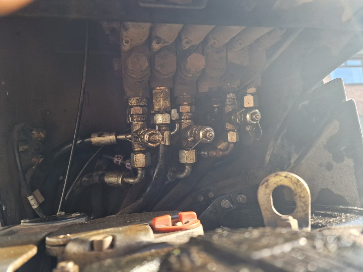

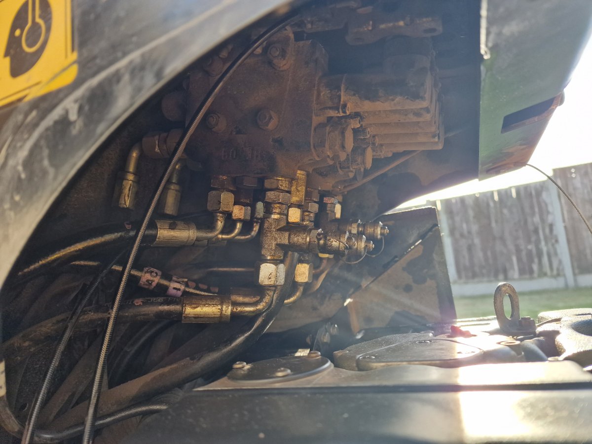

yeah the track speed always worked now its just on slow.Oh so the track speed has got less than it was? Try swapping the hoses around on the two speed track!
there is no Hoses that go to the 2 speed
Spool the other way round in the two speed!yeah the track speed always worked now its just on slow.
like rotate it? coz i it cant go end for endSpool the other way round in the two speed!
surely rotating the slice would end for end it ??like rotate it? coz i it cant go end for end
ill take alook again neaxt weekendThe slice is fed through centre from one side, you could try turning it yes!
you might be right. but i would have thought it would turn like any other tracked machine. not having to fight itThe htd5 does not turn well when loaded. Regardless of being used or new.
Do a video to YouTube and link it, for the turning issue you could be trying to fix an unfixable problem.
No, fully loaded you can move one if the levers and sweet fa will happen.you might be right. but i would have thought it would turn like any other tracked machine. not having to fight it
im not sure if they are all wrong. at the time i didn't it, i got a o ring kit from screw fix and used what i thought was a match.Are they all wrong? And are they all leaking?
the tipping and lifting are now fine.Just remind me where we got to on your dumper before the leaks!
I am guessing there was a problem originally, and the owner ordered a spool section (cheapest) and thinking it was the same had it fitted and created the problem!the tipping and lifting are now fine.

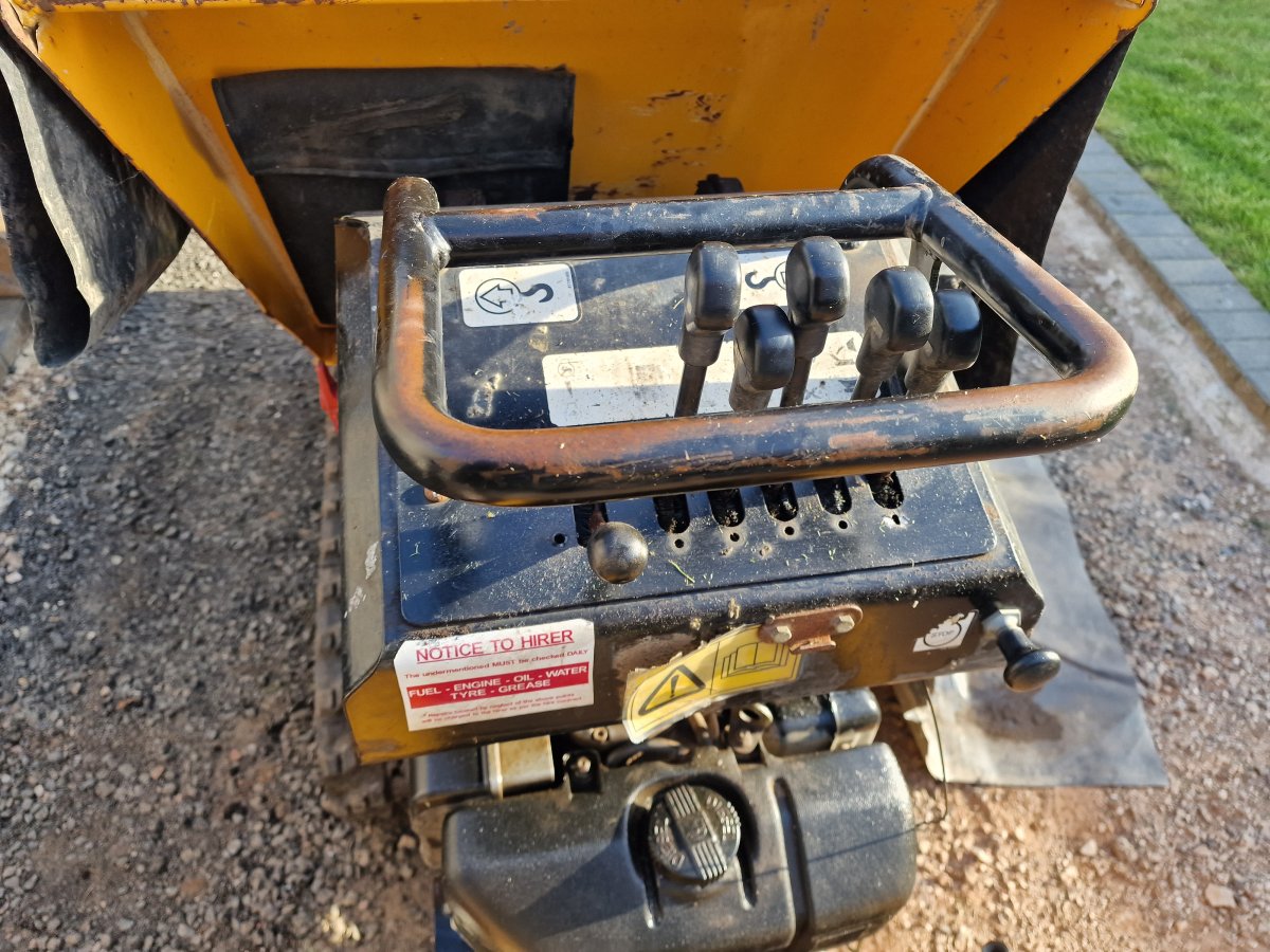

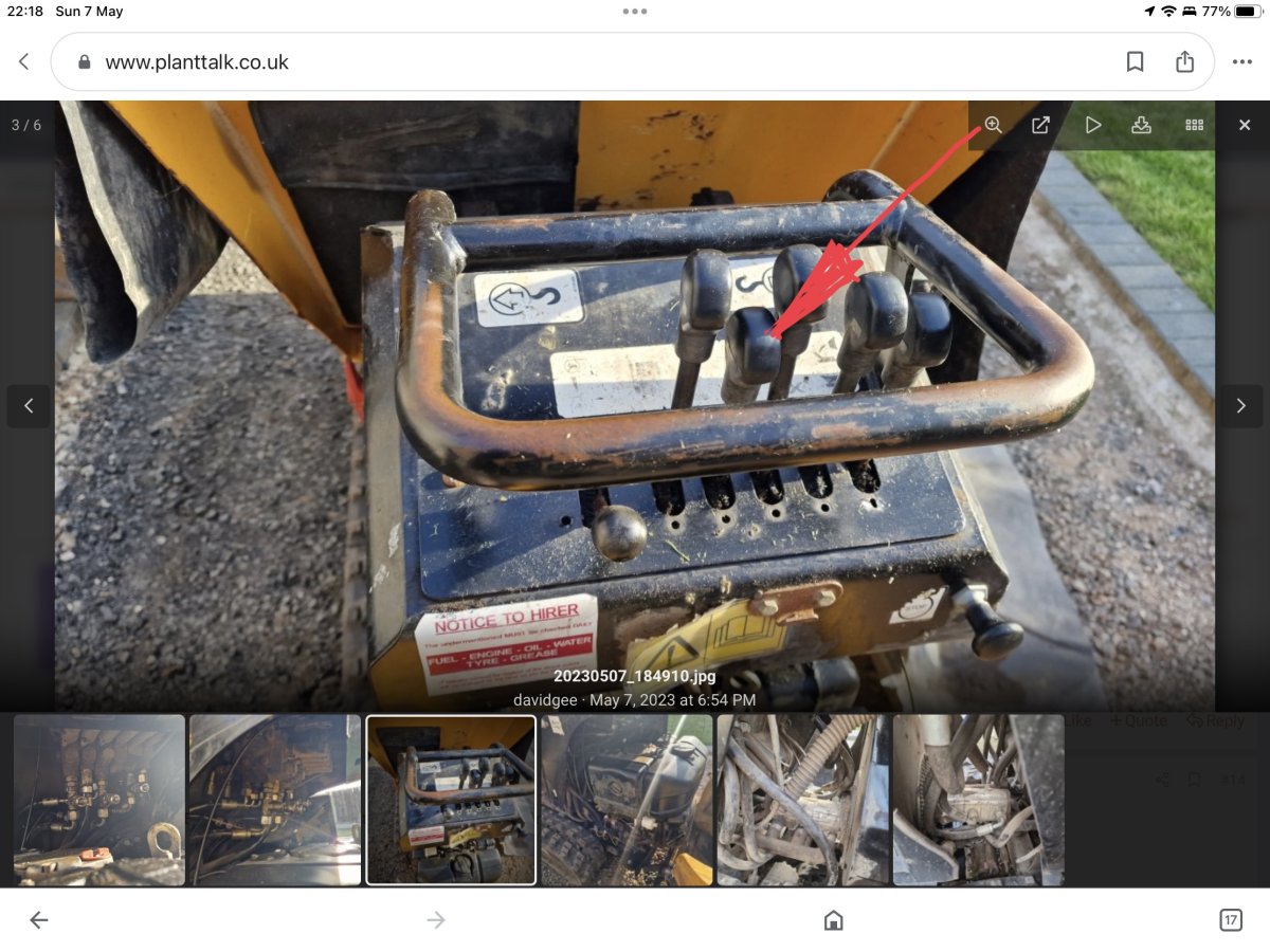

lost the 2 speed so its painfully slow.
tracking is jerking.
moved the 2 speed spool into the tipping spool so both ram spool are the same and the tracking spools are the same.
i think someone before me changed the spools around as the ram spools wasn't identical
Hi, yes i have leaks but apparently Ive just found out that the o rings i Used are not right and i need the correct ones form the Hydraforce . I'm trying to contact them now.I am guessing there was a problem originally, and the owner ordered a spool section (cheapest) and thinking it was the same had it fitted and created the problem!
So all works apart from 2 speed, but you have leaks?
