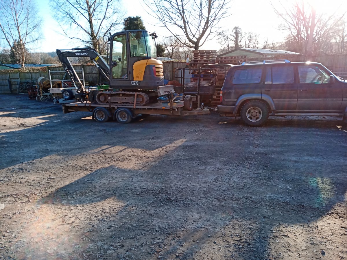

My tandom axle seams to eat the rear tyres
but this maybe why
You're hitch could be a touch high looking at that mind

Its over the top tbh. The digger + grading beam + 2 buckets + tilty + selector grab.

Even so if the loads in the right place and hitch height etc bang on it'd look right. I know of someone who ran the older landcruiser delivering diggers a few years back often had 3.5 or 4 tonners on the back no one was ever any the wiser. 😂
My tandom axle seams to eat the rear tyres View attachment 15254but this maybe why
too much nose weight, forcing you to have your hitch too high and loading the rear axle harder .... a tow bar is for towing with .. not carrying half the load on the trailer .... it's important to get the nose weight right, so you can set your tow ball at the correct height to make the trailer ride level and thus load both axles equally

That’s pretty much impossible with my transit custom, at least it is if you want to open the back doors with a trailer on. Even with the bolts in the bottom holes the doors still catch the hitch if you’re not sitting level.

I find using an adjustable ladder type hitch plate gives you the option to have a higher hitch hight on the vans, you can’t open the back doors with the hitch on, but at least the height is correct for towing. Just take the tow ball/jaw off and stow it in the back when not in use.
