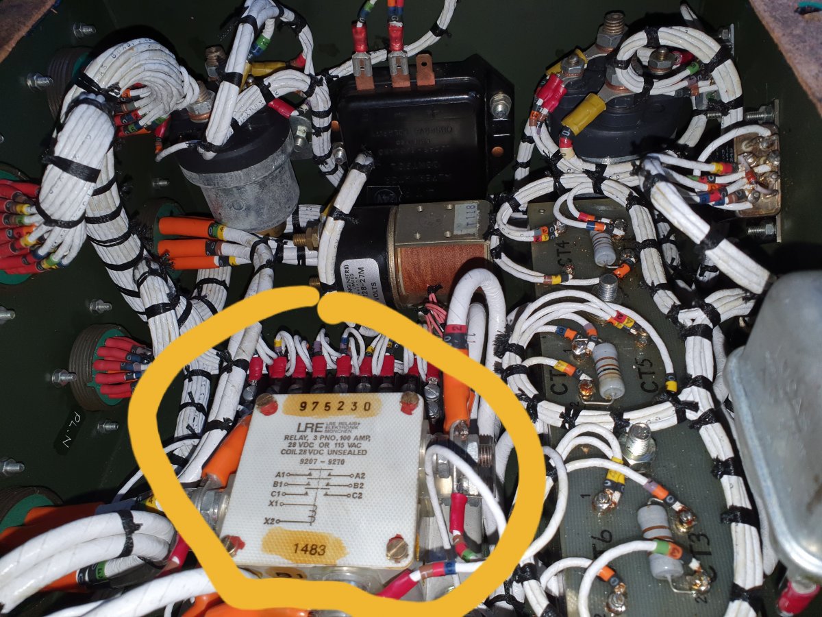

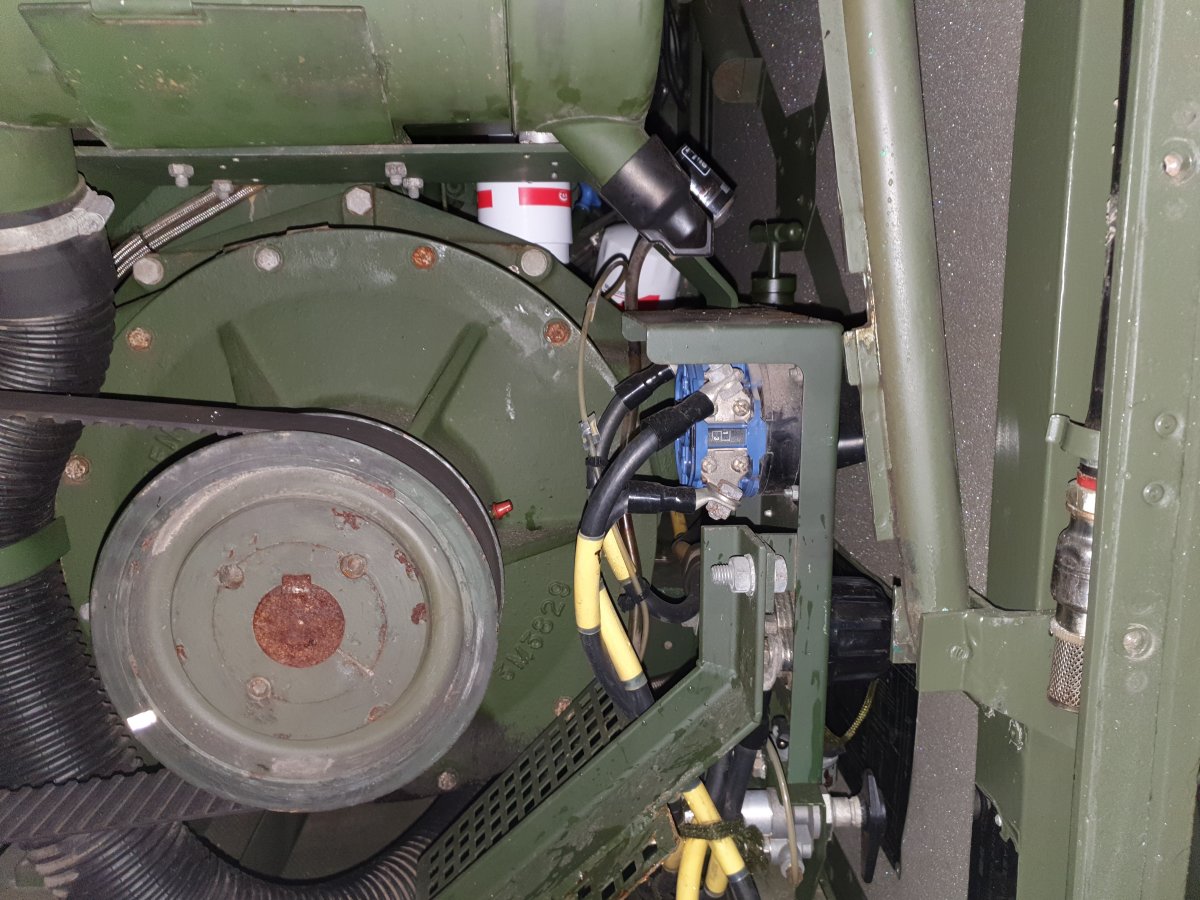

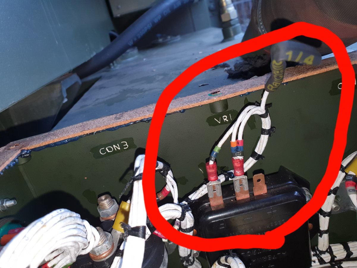

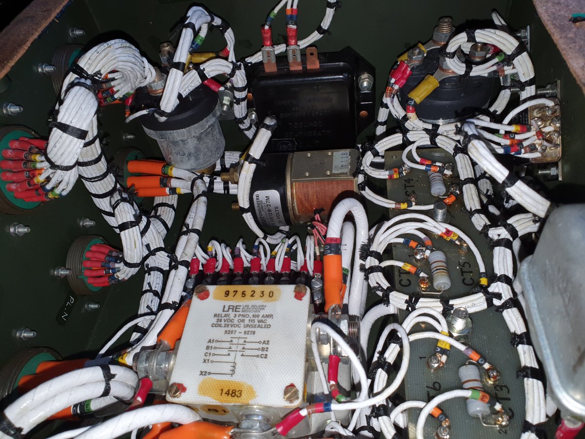

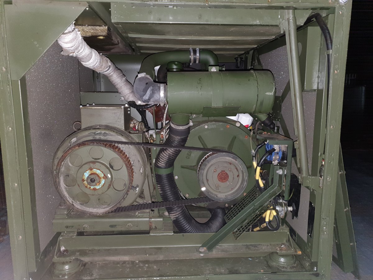

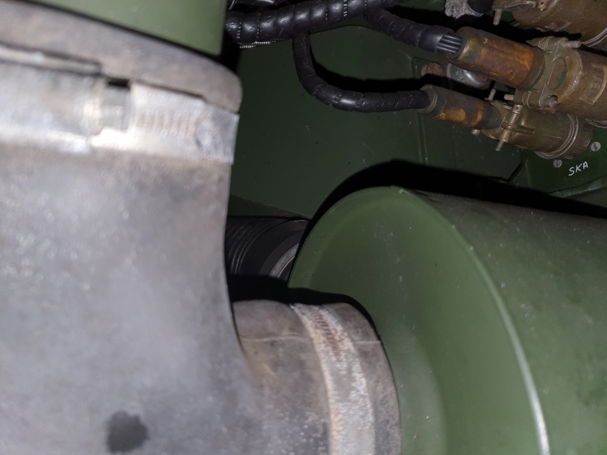

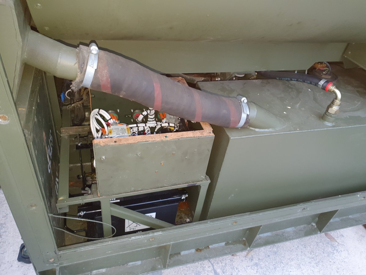

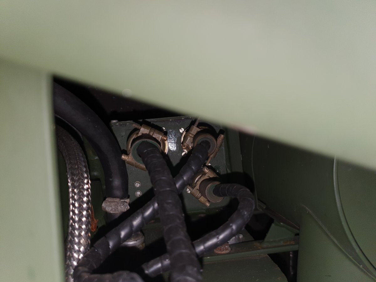

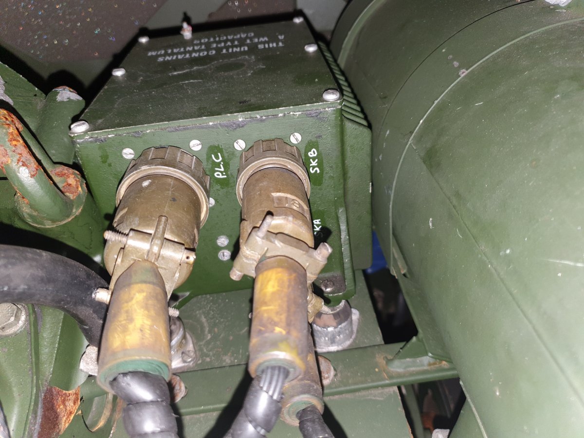

Sorry for not updating you with any news but nothing to report until today..Genny Engineer found that the Relay was not holding its energising out of Load mode..but with out any diagrams what wires are causing the issue is not a 5mins job, and jumping 24v across is to much of a financial gamble for me...one thing that stands out though is a blanked off,positive lead and a spare terminal on a black box...is it black box issue or a satey blank off from a live external socket but again to bigger gamble for me.I've sent out a help request to my supplier this afternoon hoping for a positive response.???? If anyone knows someone who knows someone with any diagrams that would be awsome..please take a look and see what you think..

what voltage is the engine electrics? ... VR1 I'd presume to be a voltage regulator .... and that 500A relay is / appears to be 24-ish volts coil. presumably using battery voltage if it is a 24V system ? .... any chance of a full pic of that box of lecktrickery bits chowing the entire contents?
Unfortunately that's about as much space I had to get any better pic..I'll post what I have which may not be any use at all, the main leads are to the alternator,,yes using battery voltage and 24v system to the best of my memory 👴

obviously pc and latch pic..fat finger disfunction. 🙈

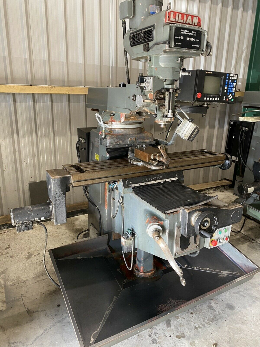

again the chap with the Harrison has this ... https://www.ebay.co.uk/itm/LILIAN-X...355177?hash=item5db9371c29:g:vQoAAOSw6qdfprgo
looks to be R8 spindle and has had some use ... but a typical example of the Bridgy copies about, from all over the world ... think Lilians are Spanish, but STBC .. @Quattromike ??? On EDIT .. or could be Korean

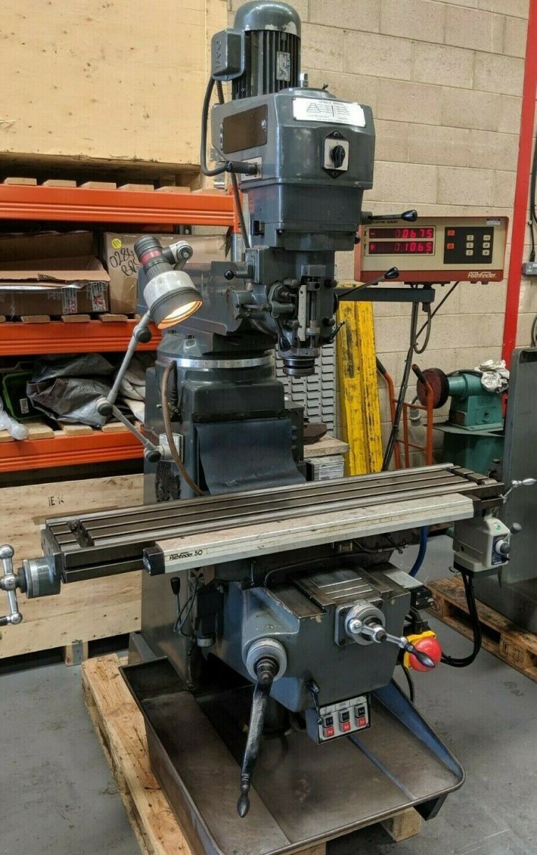

this is my AJT1 Ajax

the R8 spindle's not the most manly / rigid for anything heavy and there are hundreds of other options out there for turret mills, with MT3, INT30 and INT40 spindles. I spent ages searching for a decent turret myself and eventually bought a nice Ajax with a 40INT spindle ... it's in me thread - search Ajax ... as for price you could pay anywhere between a grand to three for some thing half tidy ... really nice, even more
