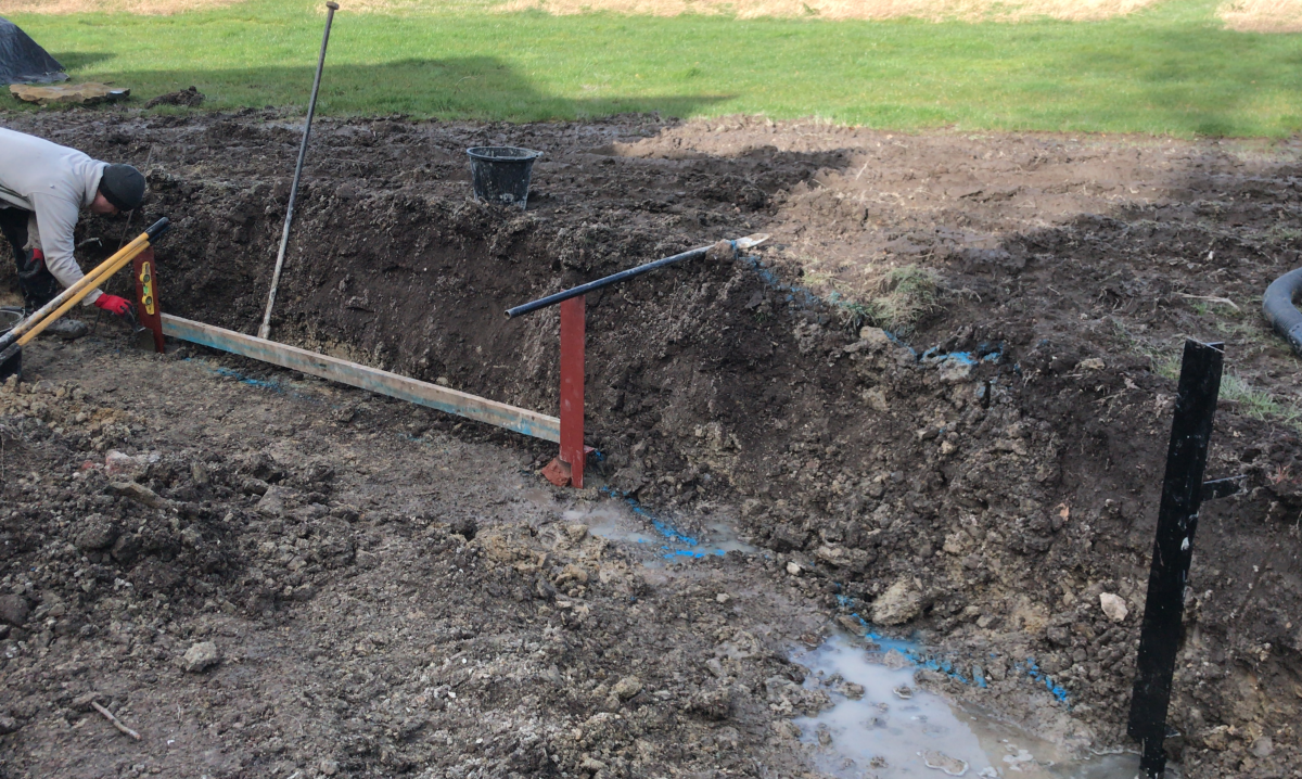

It’s a 300 wide trench Concreted 450 into the ground and dry concrete packed in behind plus a 100mm slab up against it . Tallest sleeper out the ground was 900

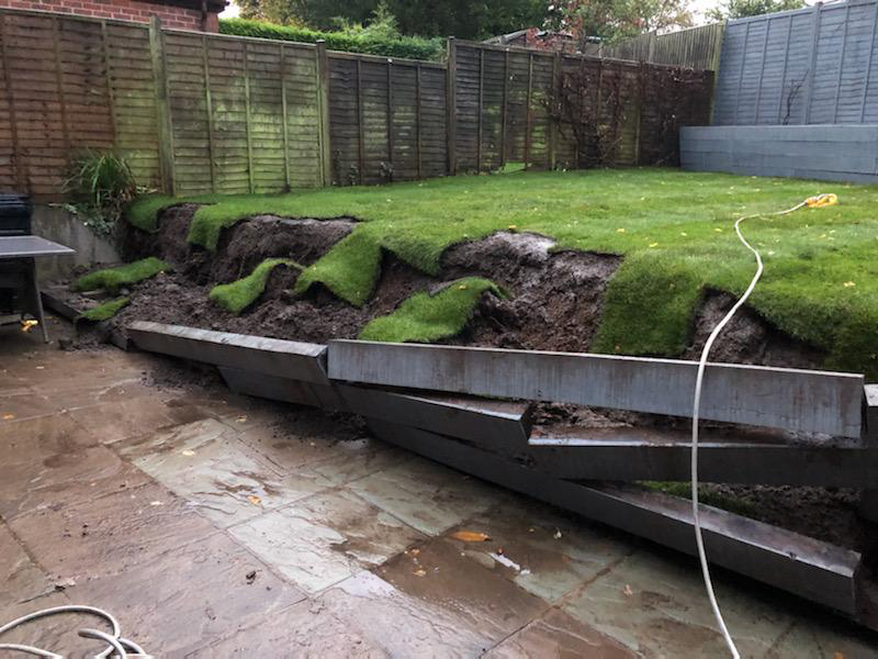

Still, could be worse. This was a job I filled in behind last week, and I could tell it was dodgy. Only 3" posts trying to hold it up! Told the bloke. He said it'll be fine. Got sent this photo this morning...

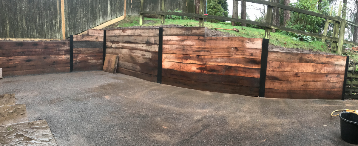

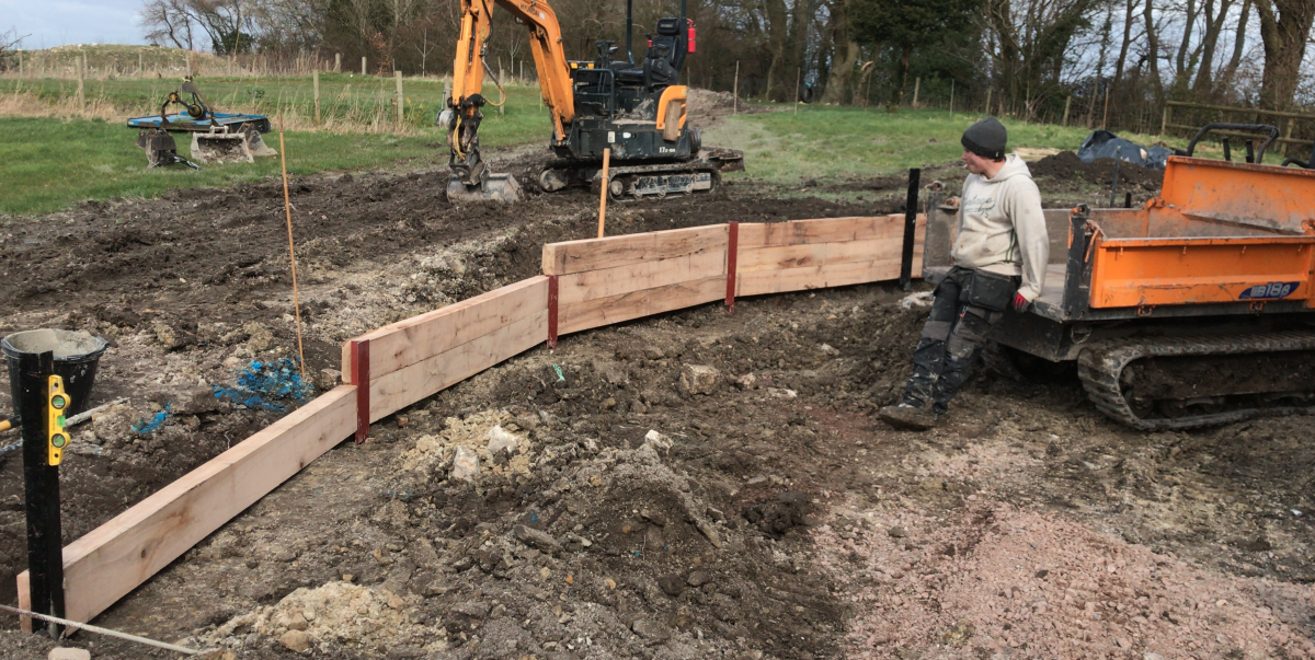

So I've welded him up some steels to do it properly....
This is how you do a billy bollocks job. You can attach ground anchors to them too for proper retaining and it's pretty fast to errect.

I tend to put em down on compacted crushed and then build them up drilling and Pinning. With a few Dead legs back into the bank to serve as retaining.

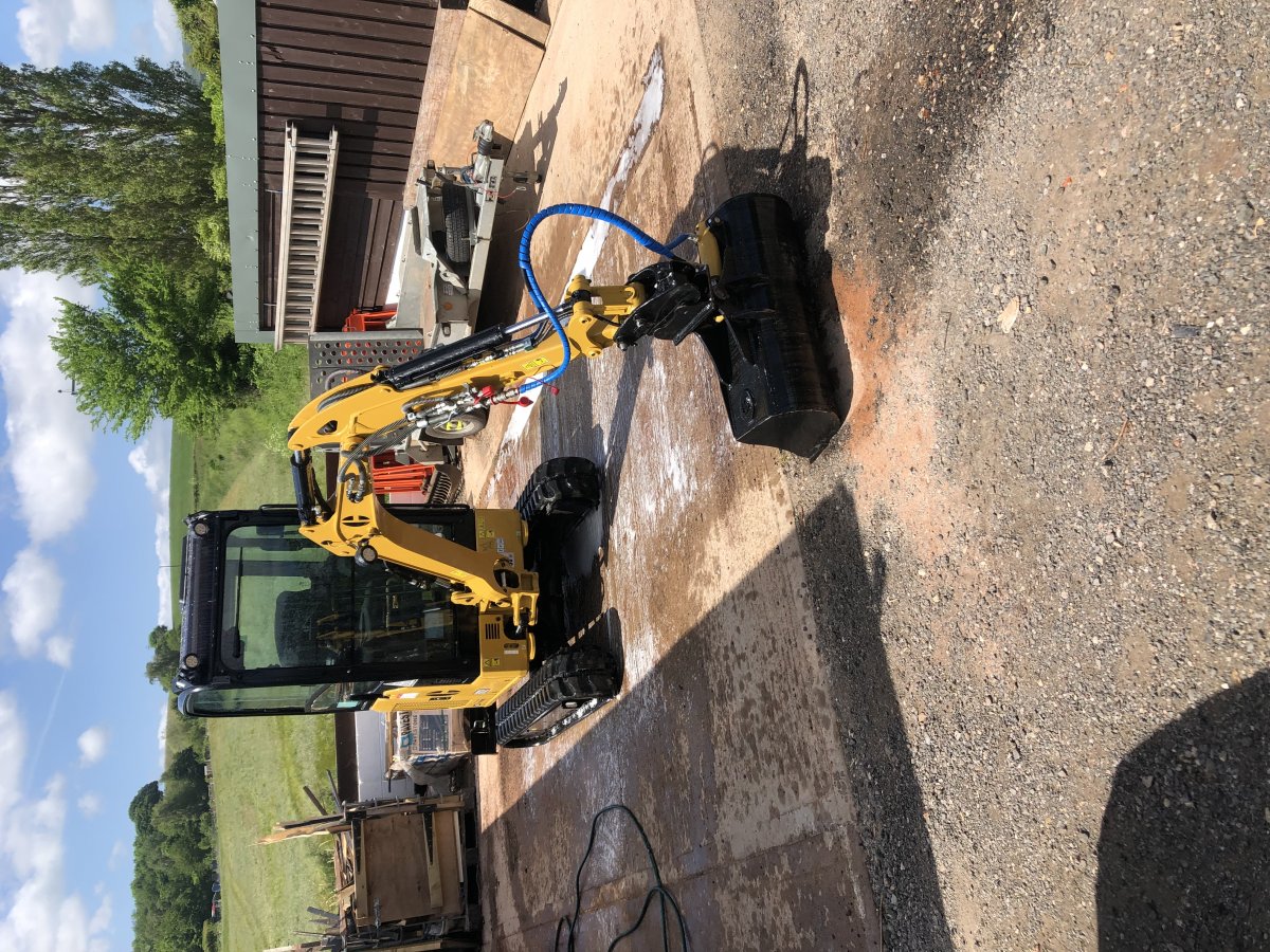

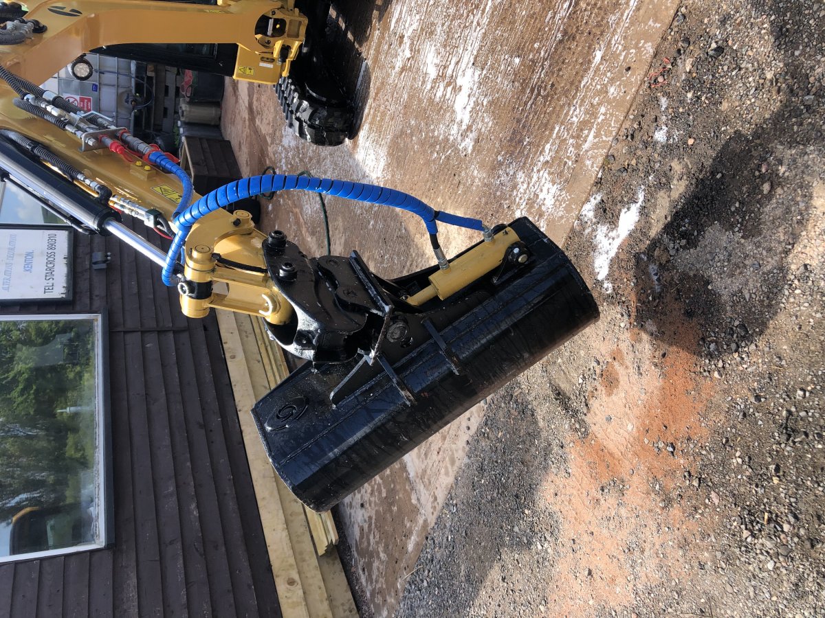

New bucket arrived curtsey of @CPS very happy with it 🤘🏽
