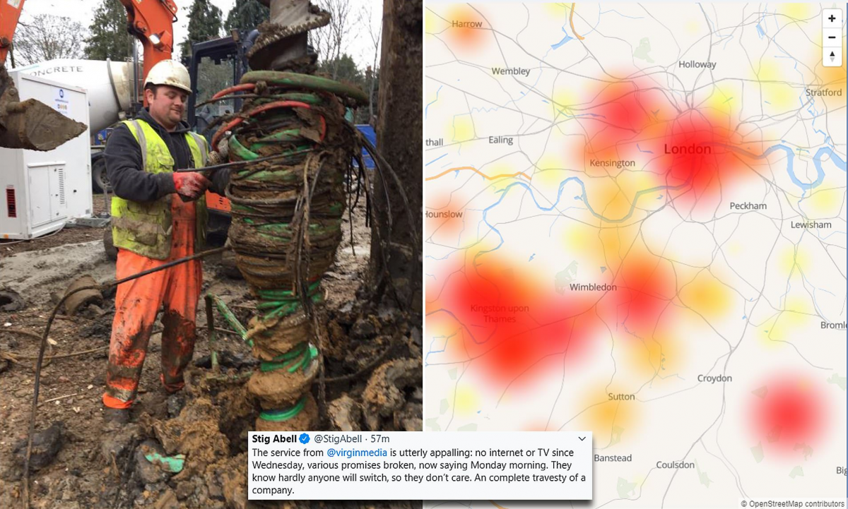

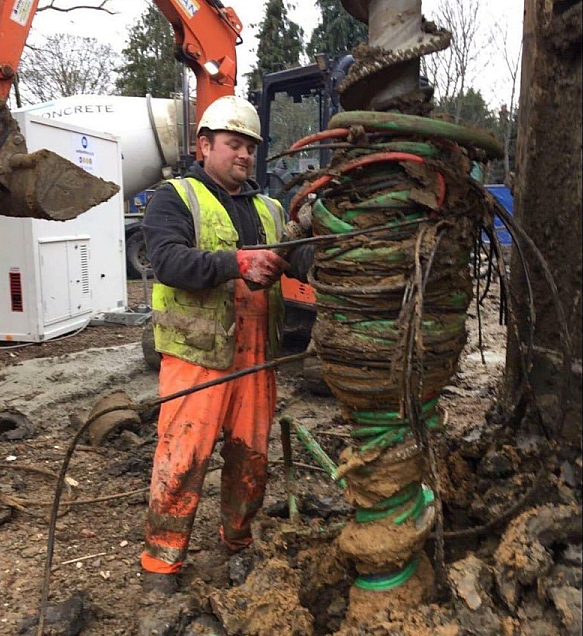

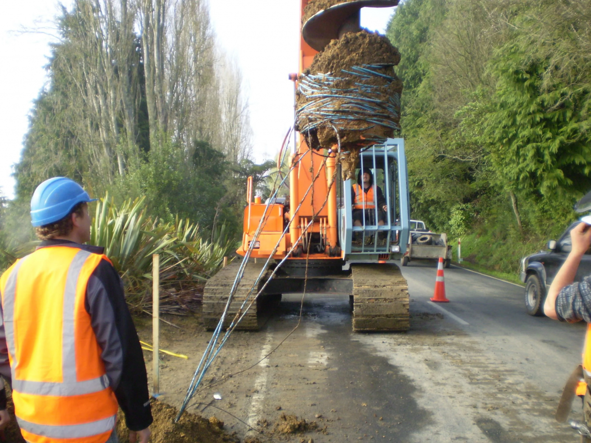

Augers are brilliant tools but you need to be 100% there are no services anywhere! Deciding to whip the auger out when someone has specified a square hole(and not given any other reason why) then hitting a unmarked fibre optic cable will undoubtedly send you in a world of pain! After hitting a big gas main with one (site was deemed disconnected from the mains!) I tend to stay away from them!

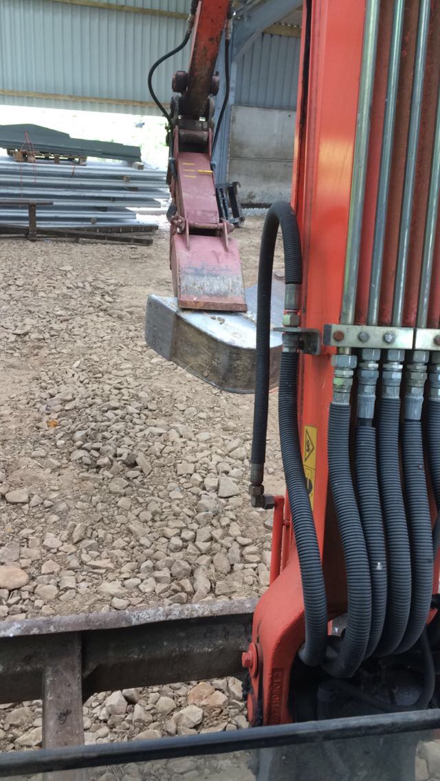

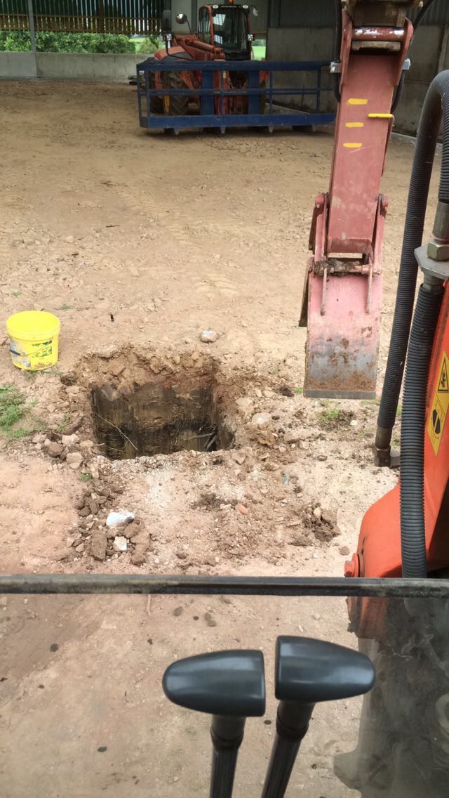

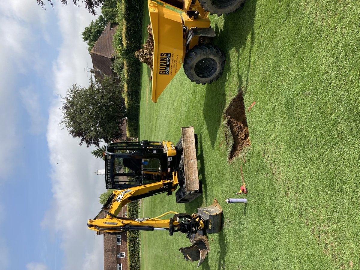

I have no idea why they want a square hole, I don't ask, I just dig. Its likely to come from some sports England spec somewhere. And yes I dig them with the machine. Why would I take an auger along as well and then get the shovel out to square it up? Come on Rory!
The socket I have to install is only 600mm long so not the biggest thing and they want it just below the grass so the mower will pass over it. Its a two day affair where the first day you set out, dig and put the sockets in place with some post mix to hold them in the right place. The 2nd day you pour concrete, topsoil and reinstate the grass. A home by 12 kind of affair. Cant complain. Ill take more pictures next time of the process - I didn't realise of all the work I do, this would be the most interesting! 😆

I was impressed with your square hole but only because I thought you had done it with the non engcon equipped digger🤣
@Gunners Thinking that 8 Ton JCB and dumper you've had would look quite smart with Gunns Contractors on the side of them mate. Fit in Quite Nicely with your 8026 and dumper.
No doubt mate, and it was nice pretending I was a big time contractor for a few weeks while I had them. If the bigger work paid as well as the smaller stuff then I would run a similar setup.
