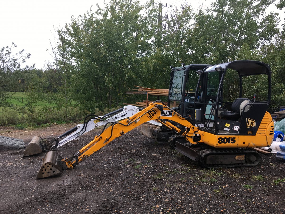

Had the opportunity to put one of the long arm Bobcat E19's next to my 8015 today. You can see the difference in reach, although according to the spec's, the Bobcat wont dig any deeper than the JCB, I guess reach at ground level, doesn't necessarily mean it can dig deeper? Nice machine though, the cab is lovely and great service access with the side opening panels.

not such an extreme crank on the boom helps that a lot

That is true, but one has the boom lift ram under the boom and the other has the ram over the top. So there’s possibly more to the geometry than meets the eye?

I wonder if the ram location is the reason. Clearly the e19 there and take micro and 216 also have boom ram mounted on top and they all have flatter shape to the boom. From what little experience I've had of top mounted boom I've found machines with them to have a less useful working range (hence i stick with conventional layout up to now) i guess it's a compromise which is probably worth it for a hire company.

I did a quick check via google and was around 500mm deeper with the e19 long arm over the 8015.
Jcb 8015 2044mm bobcat e19 2585
My 8015 goes to 2.5m I've done it several times! Maybe the newer ones with the ram over the boom like the bobcat dont?
Most of my old machines have only ever done around 2.1 to 2.3 depth regardless of boom on top or not.
Im not going to disbelieve you but to get 2.5 did you put blade behind and jack it up ect.
Also hitch will alter dig depths from quoted to actual

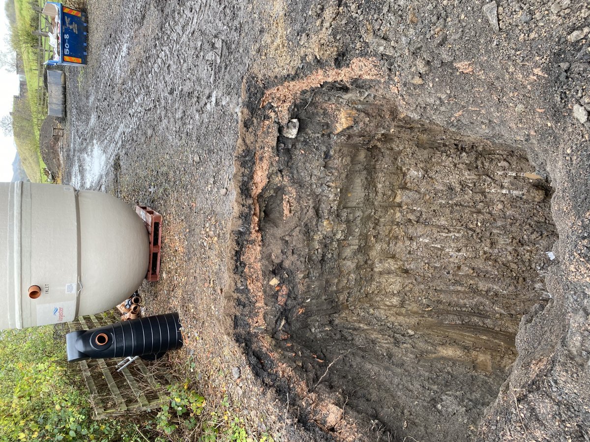

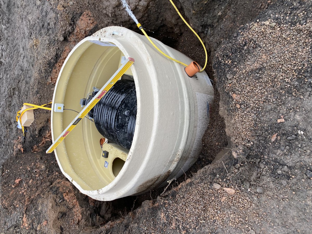

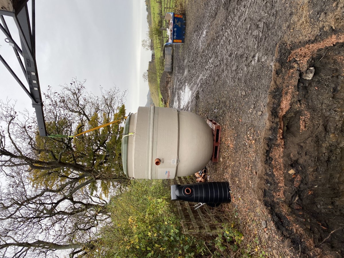

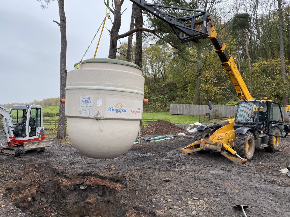

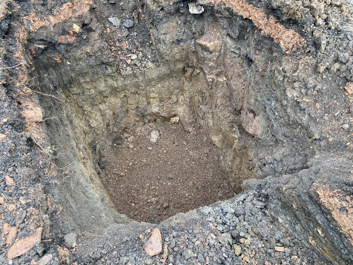

Just to throw this into the mix,
dug out a hole today with the Takeuchi TB219 to a depth of 2500mm for a biodisc septic tank.

Wouldn't do that with 8015 without digging a patch down to sit the digger in.
I think people are misinterpreting the point of my original post here. I wasn't saying the 8015 is better than the Bobcat. Just using it as something to compare the long arm against as that's what I have in my yard. There have been several discussions recently on here about the Bobcats and the advantages and disadvantages of the longer arm Personally I was surprised the Bobcat wouldn't go significantly deeper that the JCB, given its long arm and I invited your thoughts on boom geometry in general with the trend towards putting the boom cylinder on top of the arm.
I know what I can do with my 801, and I know what it owes me and what its earnt me. I wondered what you all thought of the Bobcat not the JCB!
@hiluxman You have a good point that the quick hitch will help a bit with dig depth, and I quite probably did have the blade behind me when going deep. Due to the shorter track frame length on the JCB, it needs the blade to the rear to get the most power down in hard ground. The Bobcats track frame must me a good 6" longer which gives a noticeable improvement in stability when tracking it on and off trailers etc.

Not missing you're point at all but there's more to it. It's the combination of dig depth, reach and loading height that makes the difference with the longer arm and also the ability to still be able to work close in. I had an 8015 before the 219 so i know how much more productive the longer arm is for my 1.5 tonner work. Would be interesting to know how all the long reach 1.5 tonners stack up against each other in the real world. You'll have to get a few more machines in the yard.
