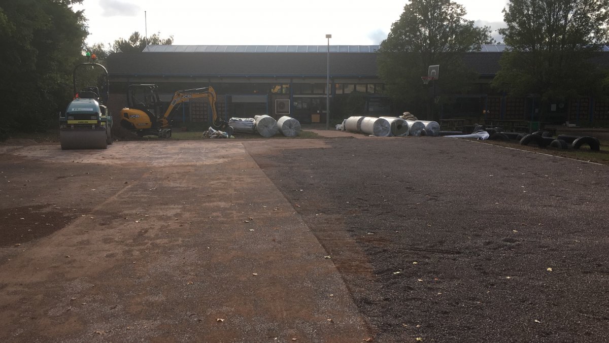

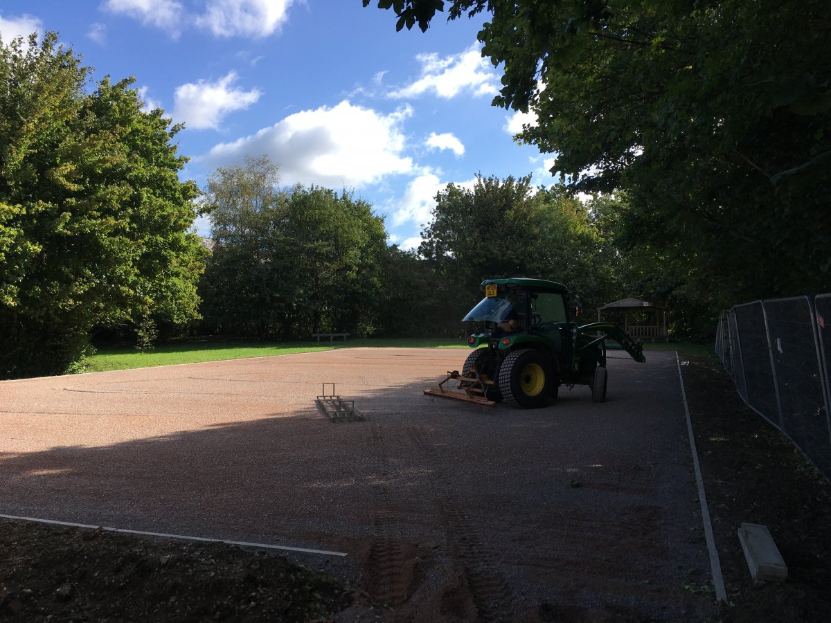

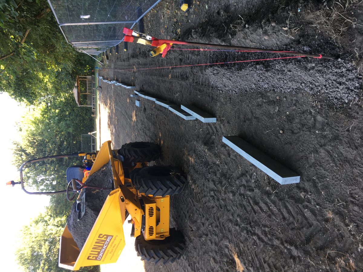

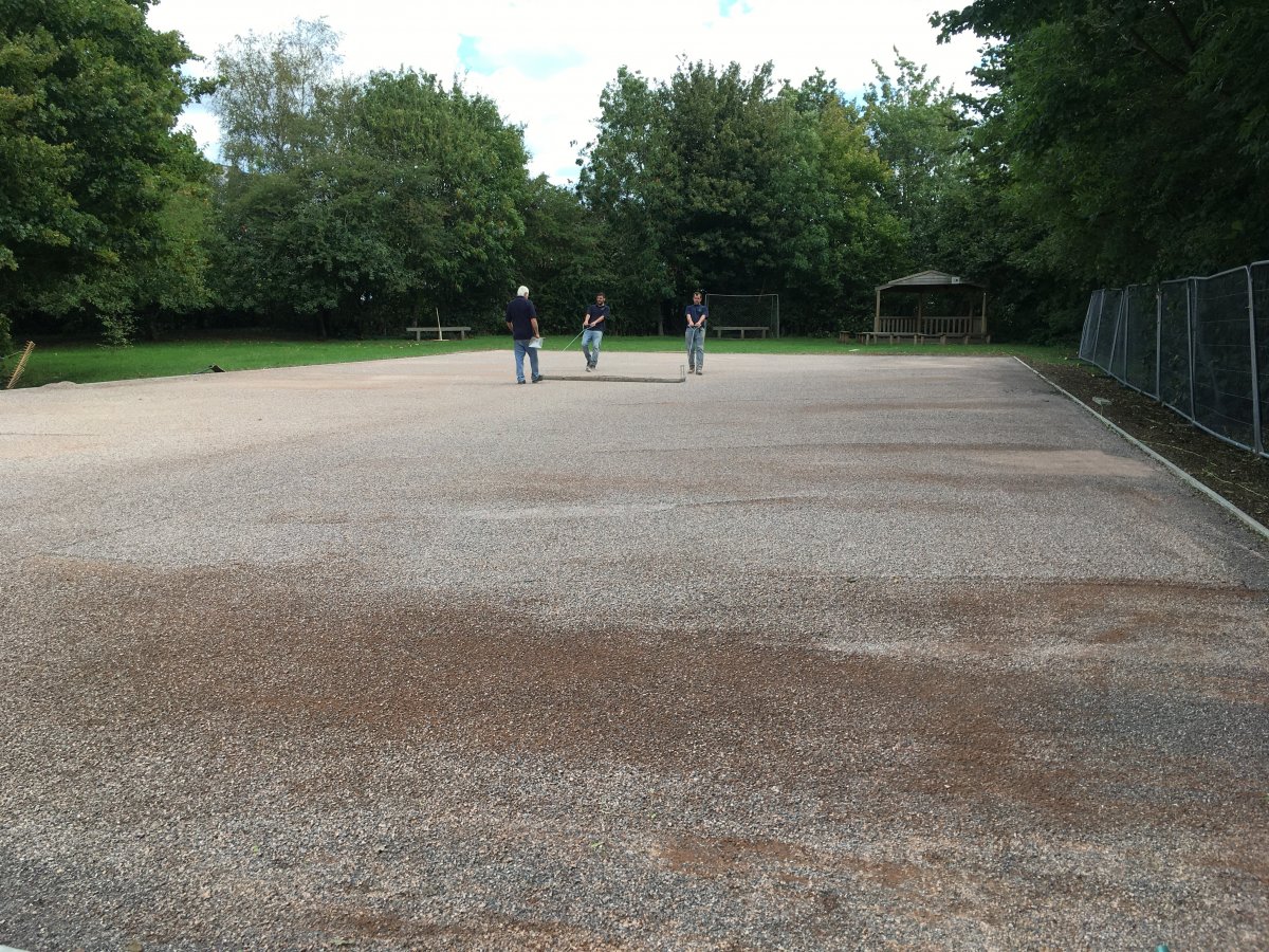

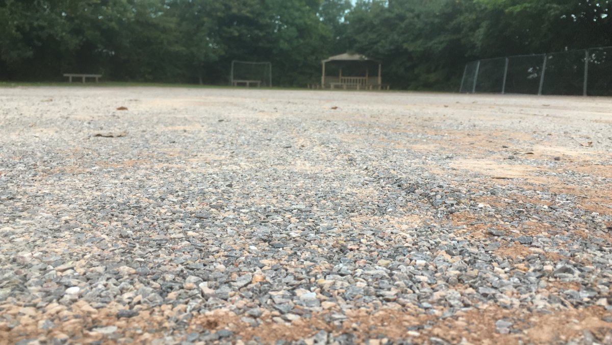

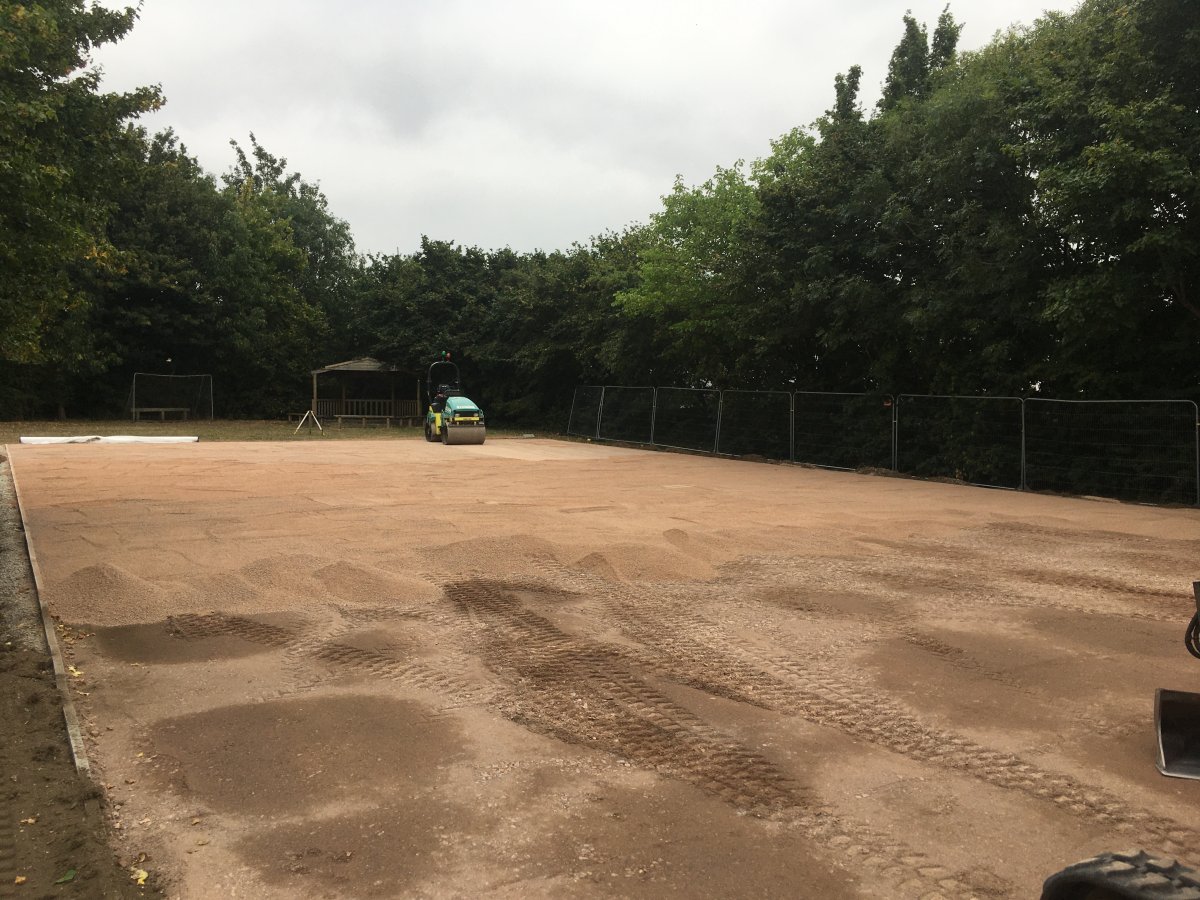

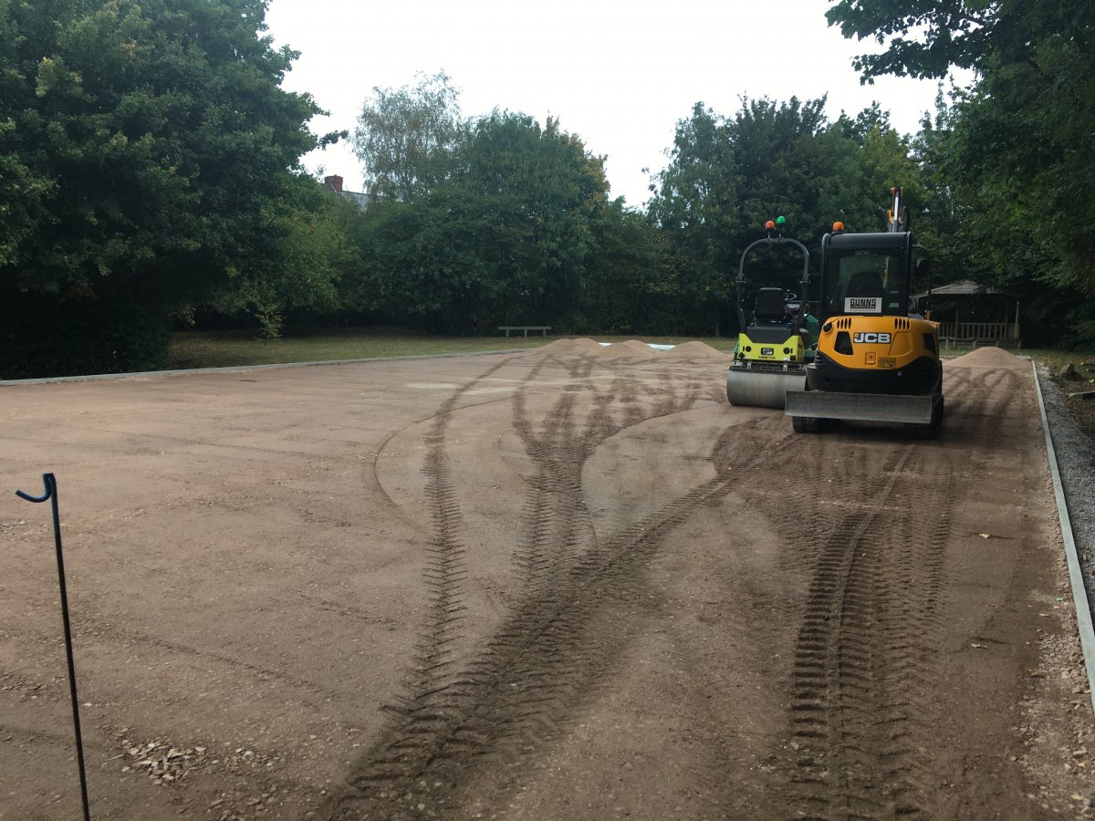

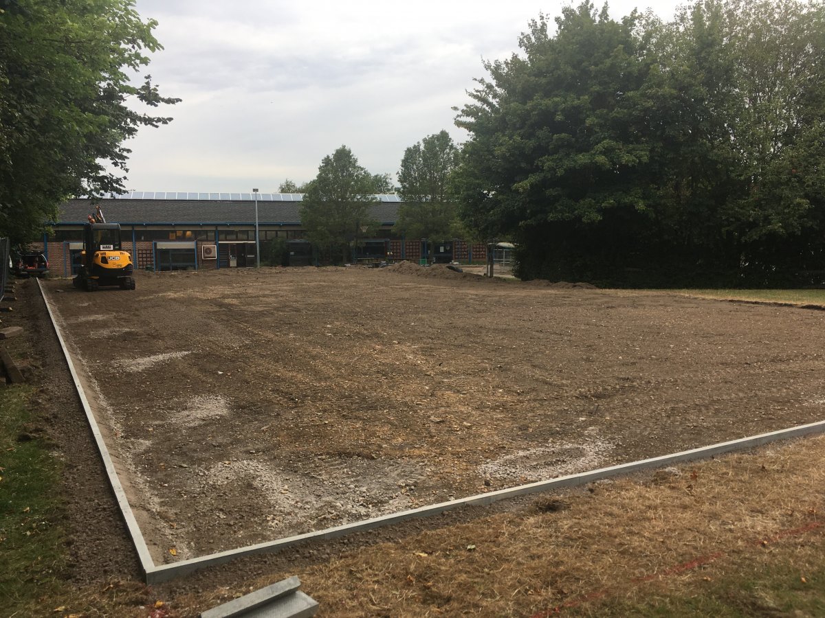

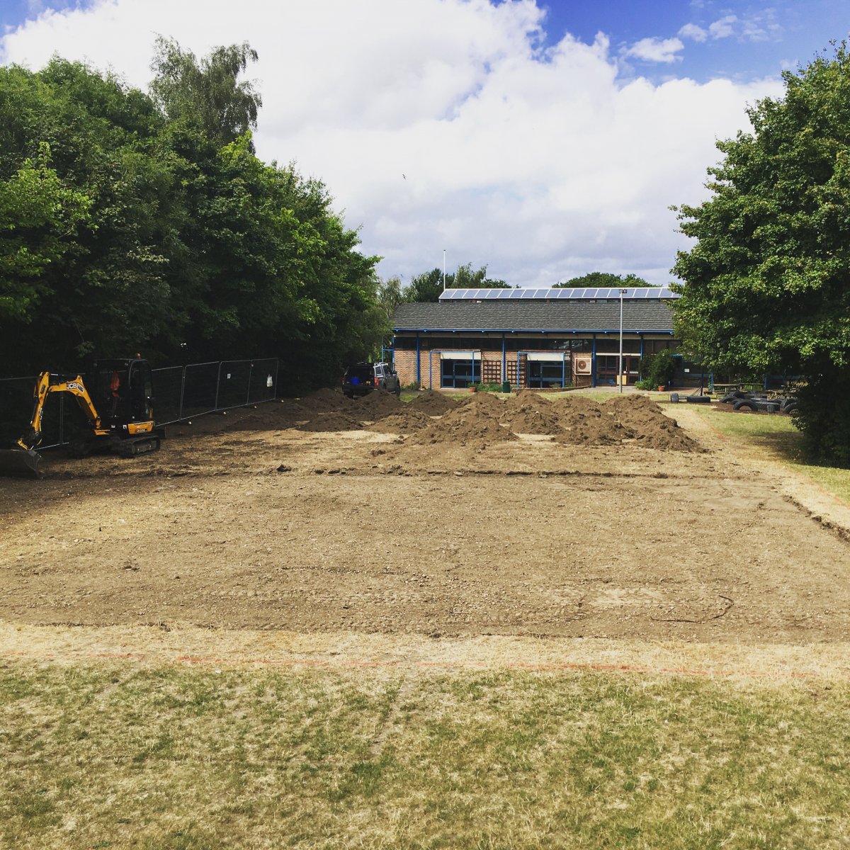

Here's some more pictures from the job I will never forget!

The 6mm tolerance seems very tight especially as that stone looks like it has very few fines in it. I'd normally beat death out of something like that then trim it down to get the best tolerance then a light vibe roll and a couple of passes dead rolling to make it pretty
In hindsight, I do wonder if over filling it, then trimming off would have resulted in a more consistent final roll. The final layer had 50mm of 6mm limestone to dust, which created its own problems as the limestone was crumbling under vibration rolling and creating these waves. I rolled it in every dammed direction I could but it wouldn't settle, just kept pushing it around. Then a big rain storm hit and washed all the fines down, leaving me with just the 6mm stones to play with.
Keen to hear other peoples methods of achieving this kind of result, I'm always open to new ideas and certainly don't know everything.
i have done a couple of jobs like this graded with the level bar on the digger with laser receiver on it then tractor level bar and then just dead roll you will never keep 6mm down still with the vib on i have seen it done with 6mm clean that's even worse like grading water
