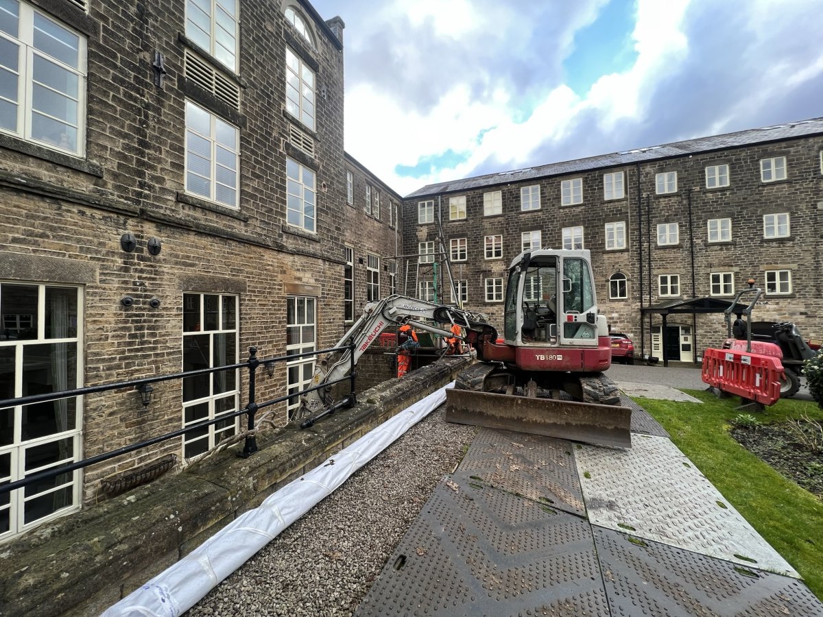

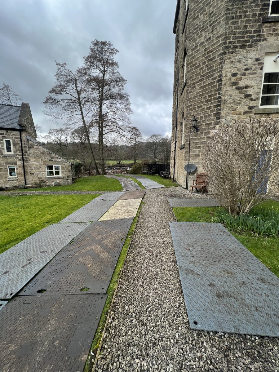

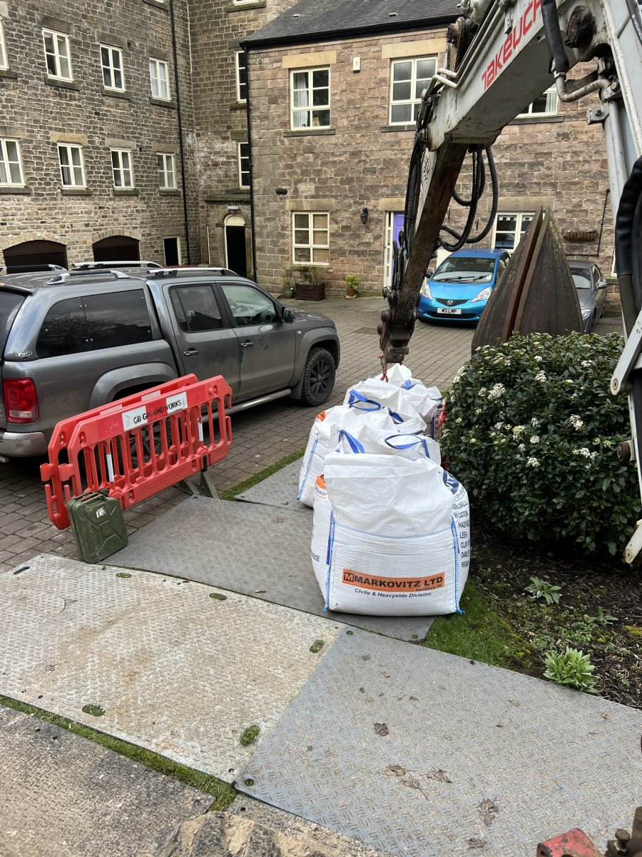

Have some as well we tend to use these style for the muck while running on the thicker ones

These are similar to the ones I have. Nice and light and bendy - but you wouldn't want to run machinery across a wet lawn with them as too thin/soft. Anything more than a Micro/track barrow needs heavier ones.
Similar to mine we used 3t dumper loaded on terrible soft grd last few weeks, I'm genuinely amazed how flexible they are

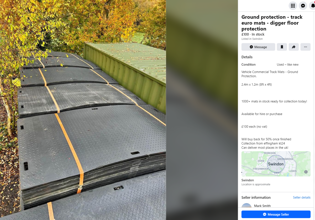

Basically new price?
Your link is for low density 10mm boards 1100mm wide. The fb ones look like medium density 1200mm wide maybe 15-20mm thick?. Big difference in function. Still not cheap at £100 though!
Groundboards are like plywood.. all different qualities and thickness and difference in use and difference in cost

He says 1100 wide, 10mm thick and 22kg in the ad, I did see it says MD but the ones in the link are 24kg so similar density? And visually look the same - single hand hold in each rather than the more common two (which mine have).

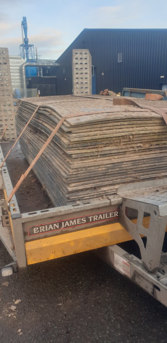

I’ve gone extreme with the last ones I bought .. 300kg each 🙄
