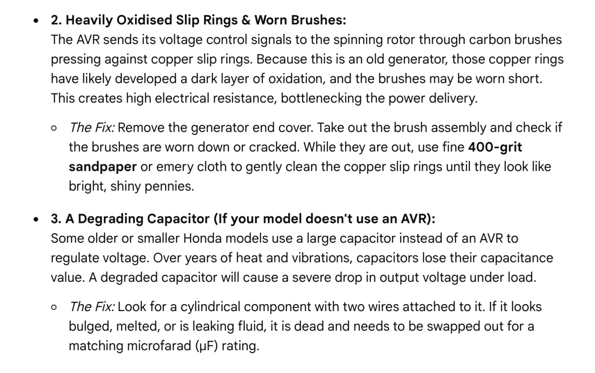

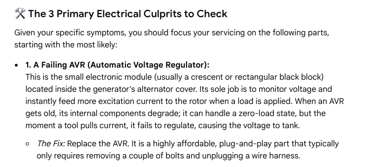

Feeling brave after my fix on the wacker is there anything I can do with my old genny. It runs fine, starts easy enough but when I plug tools in they are not running well. The motor sounds fine its not struggling but its like its not putting out enough power to the tool. AI is giving me a few things to check or fix. Is it easy enough to do these?

all pretty straight forward stuff Jim .... have a look at the commutator first -- if the copper surface isn't 'shiny', coudl well be an oxidisation issue - also check the brushes for free movement and length ..... AVR is, as said, a POP to swap out

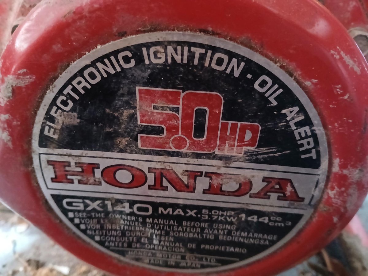

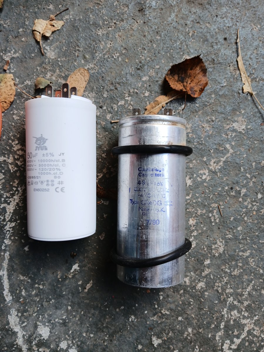

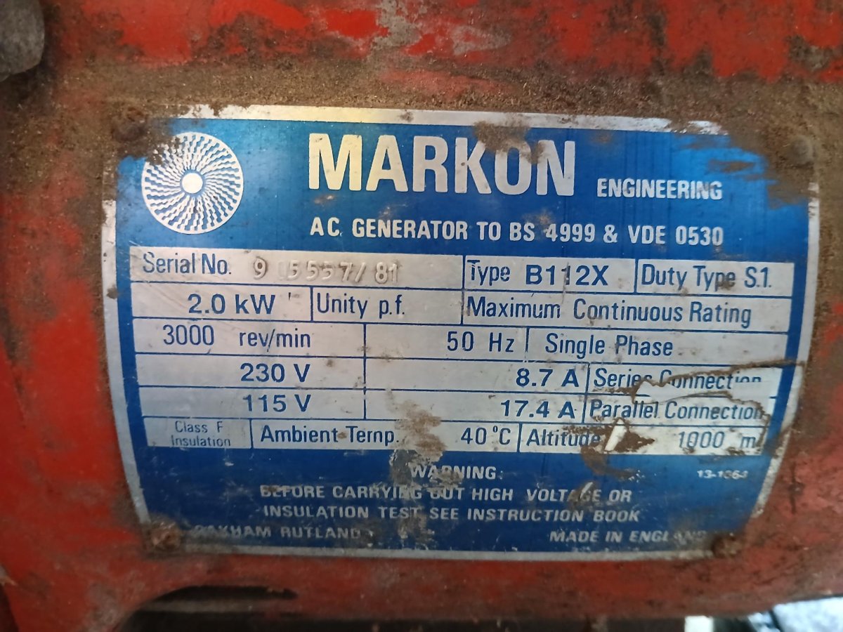

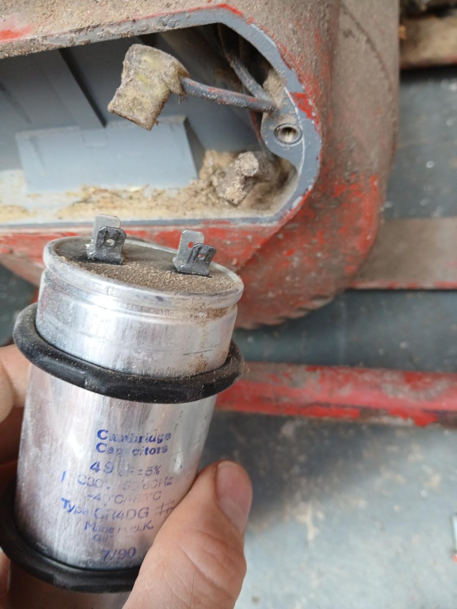

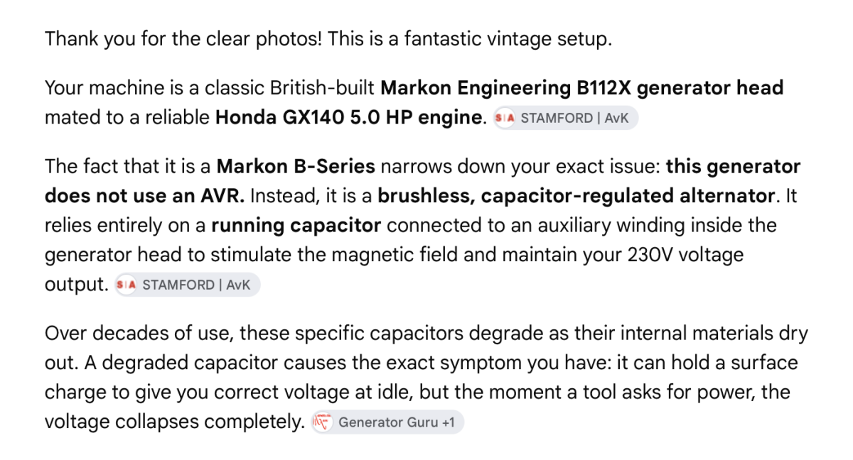

Well after a more in-depth chat with AI and photos of the plate on the Genny it ended up telling me different. I've now ordered a new capacitor. While out there i've checked the oil and its black and about 1/3 up the dipstick so found the drain plug for this so will drain off and change. Probably wait till new capacitor is here and its powering tools ok with that.
It was running okay but we had a breaker plugged into it Friday and it was noticeably underpowered

's 'cos it's only 2 Kva .... breaker'll draw more than 2000w .... would struggle with a 2kw 9" grinder
alright for drills, saws, lights, etc.
I've a 2.4Kva, Hodna which'll just about run a 9" ... runs the boiler fine when the leccy is off though :giggle::giggle:

So do these capacitors wear out or are they either working or not working? As in if the tools are getting power from the genny its working.
a AI said, they do degrade (or explode even :oops:) but if it's nadgered it won't excite the genny and you'll get no output ... the fact it wouldn't run an overload/ran it badly would indicate power is being generated .... could try poking a bare lead with a finger :p:oops::ROFLMAO: - or running something of a more suitable size for the 2 Kva capacity;)
This type of cap is quite similar to a lead acid battery in the way it works. As they age, the electrolyte dries out and/or deteriorates, so yes, the capacitance drops off and the gens output drops - same as the run cap on a motor.
I bought a cheap 2kVA with a briggs engine. Seemed to work fine, but tools had no power. A quick test of the output shows only 160V. A new cap and it was back at full capacity.
