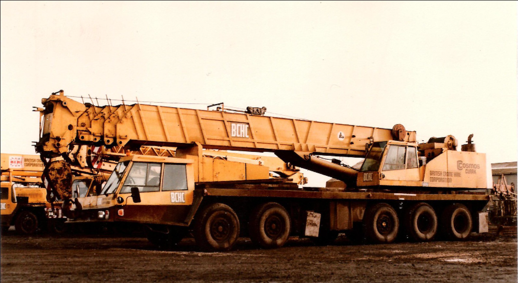

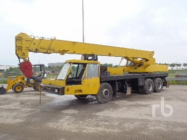

Clarke Cosmos 725 Bri ... 25 tonner .. fast on the road, servo op, scissor riggers, hell of a boom (but like a banana full out :oops: ) ... operator and erectors dream
also did a 75 tonner .... local outfit by the name of Leta had one ..... 'til they cut a factory in half with it, reaching over the building for a boiler on t'other side and stood it on its arse .... got 'repaired' and shipped abroad.. everyone knew it and no one wanted to buy it in the home market ...... got some paper pix somewhere, using it on a job, 'fore its demise :rolleyes::(

What was it like in the cranes, Gra?
Never seen one before, Gra, but as you say the boom doesn’t look the deepest for the capacity.
drove well .... real fast on the road, but they were fairly light by 25t standards, but had a big rigger spread
the droop in the boom was ..... exciting!! :oops: .... but reach comes at a price ... 'least it did then :giggle: ...... never seen one with its swingaway on ... most got left in the yard ..... God knows what it'd have looked like, full stick :oops::oops:
