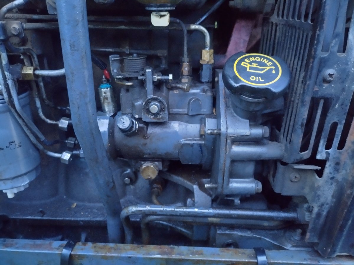

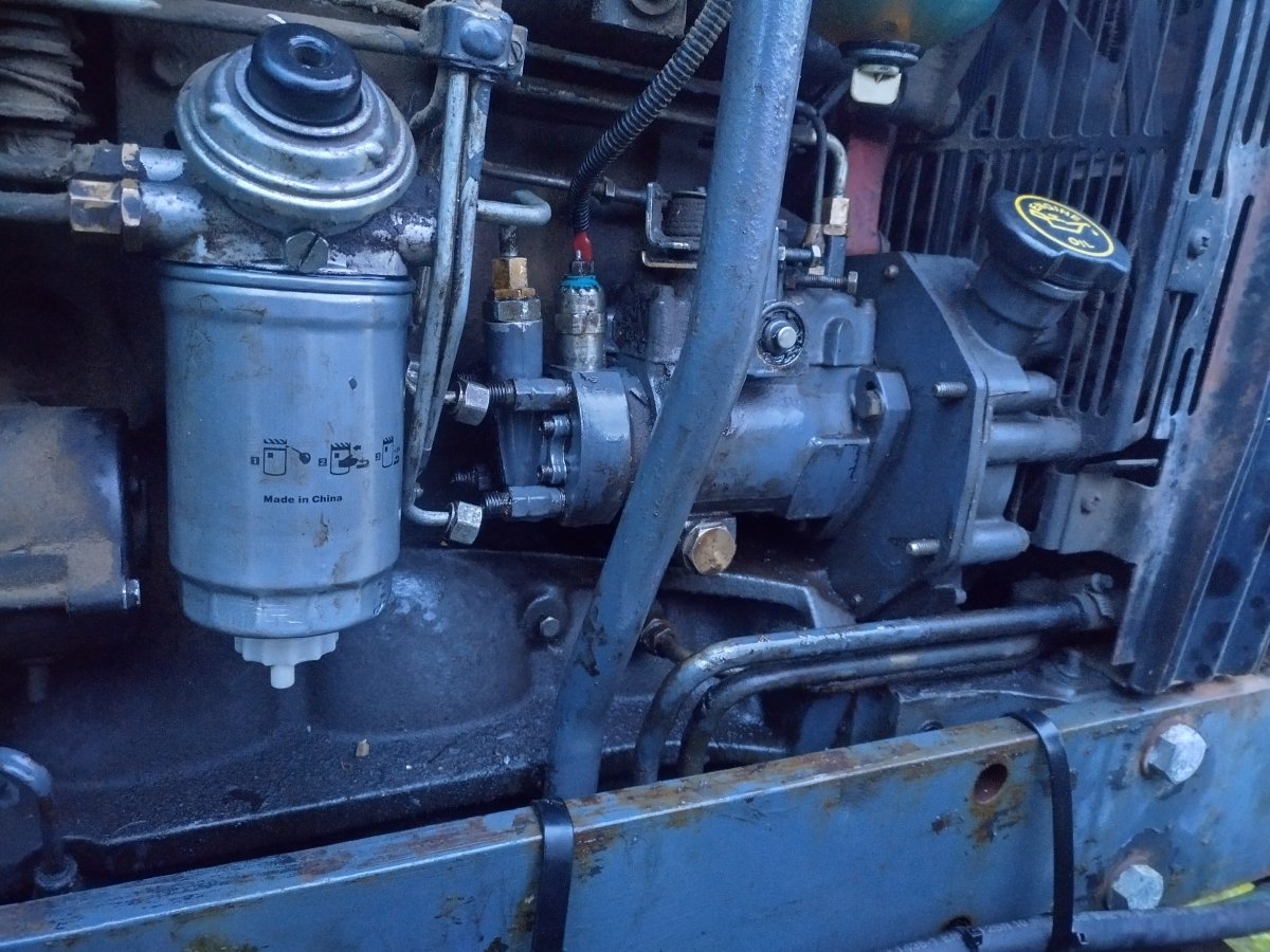

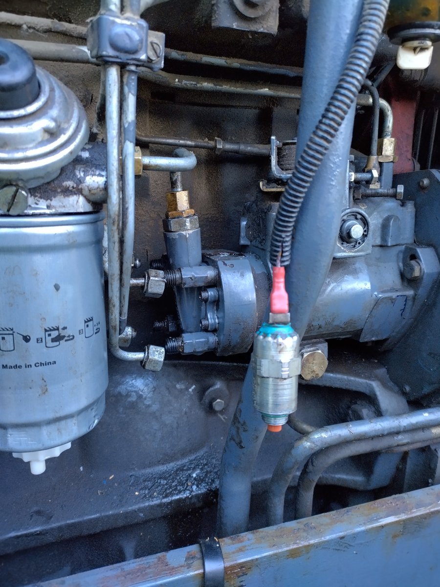

Just had a look at the book. You are indeed correct. It is a gravity feed from the tank, i'm thinking maybe stuck vanes in the transfer pump on the back of the pump. Seems like no timing procedure is required either for pump removal.
