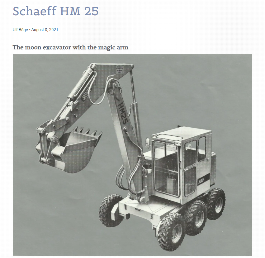

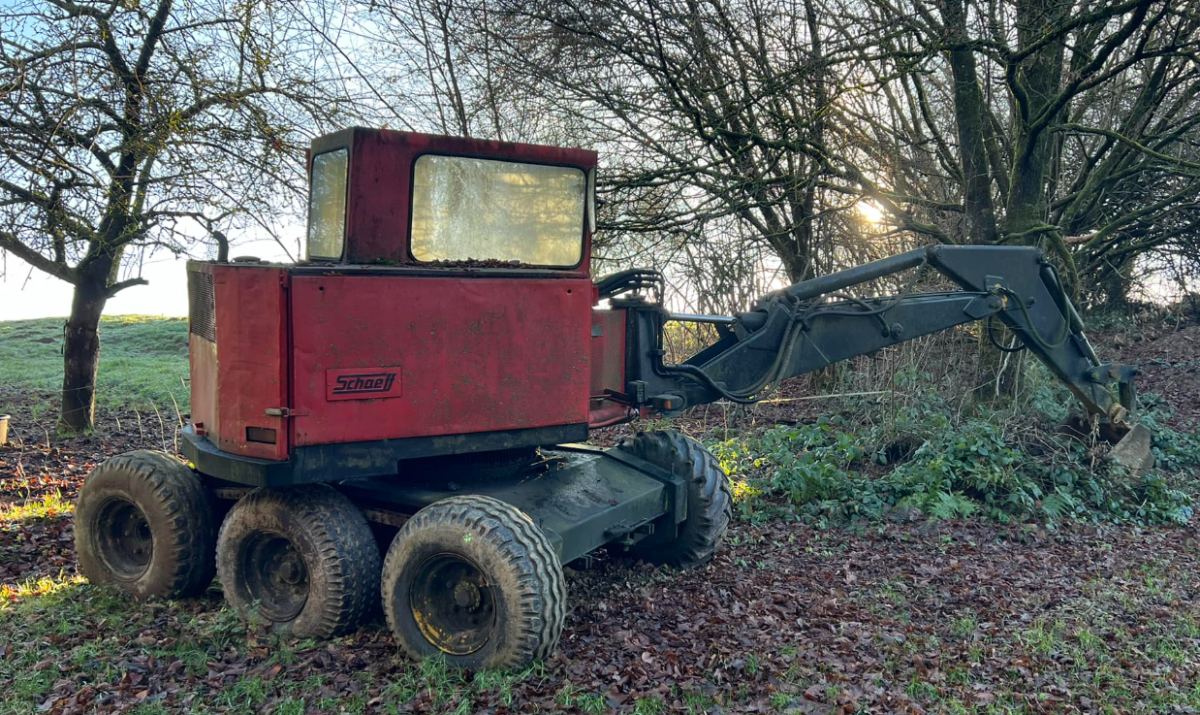

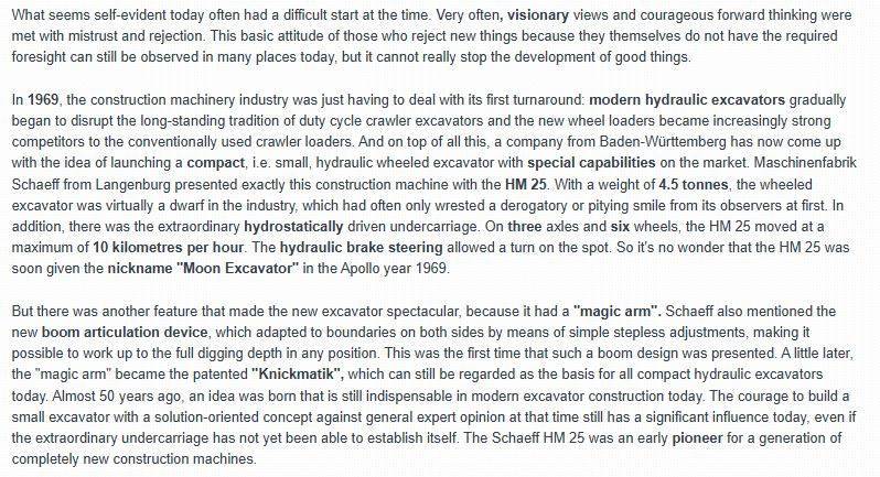

just tripped over this little beast .. must be skiddy steer -- @doobin you're the Schaef expert ... any ideas??

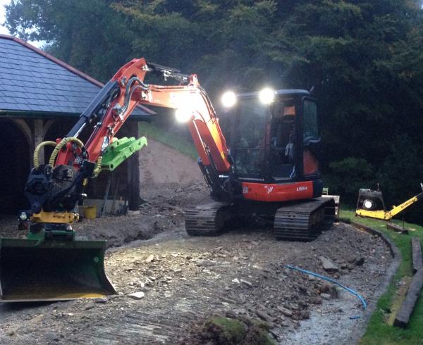

Chap I know down this way. Not a very nice thumb as far too wide but. It's also a manual thumb so pain in the arse to active. Tbh I just wouldn't want to run a thumb and tilty because just feel like it's all too much bulk out on the end. I think you either go down tilty and attachment/grab route or stick with basic bucket and thumb combo.

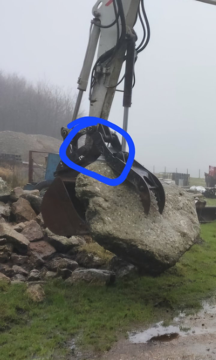

Why do you think rocks would be such a problem though out of interest. I can't really see the difference between digging forces and clamping a rock against a thumb- surely something like digging out a large stump would give a tilt far more grief?

Not the forces so much and bad to tell without seeing/using it but tilty in this space is potentially vulnerable for big stuff no ?
