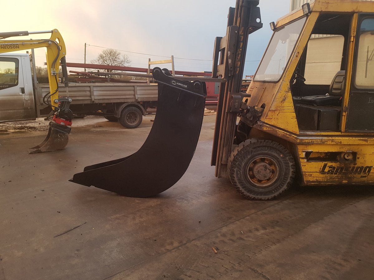

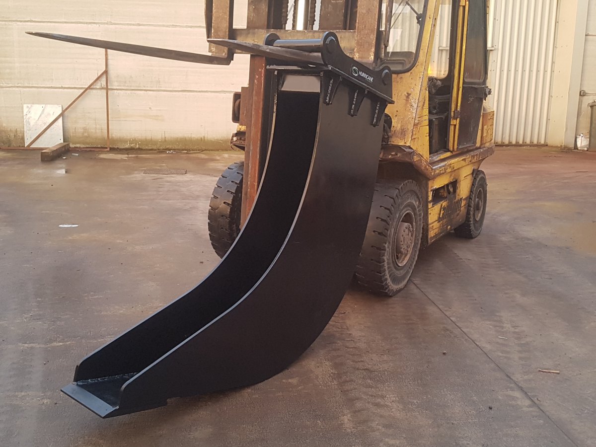

I like that, very nice, would of been perfect for filter drain work.
Its what I was looking at having made, tapered to 200mm wide at bottom BUT as nobody seemed capable of making a decision about fin drain or where we were going next I continued the way I was doing it with 18" and tucking it into 1 side.
