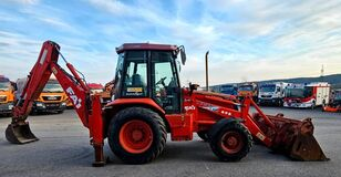

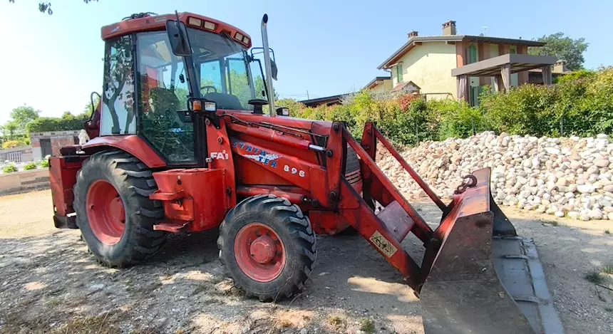

Hi there. A fellow local of mine is looking to buy a Fai 898 backhoe for use in the countryside as a utility machine. The backhoe attachment itself doesn't work, so he plans to remove it, mount a counterweight at the rear, and use the tractor—along with the front loader—as a forklift (using forks) for loading, unloading, and moving materials; basically, using it as a mechanical workhorse. What do you think? Obviously, since it has a rigid tractor-style chassis, it’s a bit clumsy to maneuver in tight spaces. Is this a good deal or a lemon to be avoided? Thanks.

what is wrong with the back end ???
It needs to be dismantled and overhauled—specifically the hydraulic pistons, pin housings, bushings, and the boom articulation points. The rear excavator arm is in rough shape; it has seen heavy use and is worn out. The front loader is still functional and efficient—obviously worn, but usable. The engine isn't a powerhouse, but it has no obvious defects other than the wear and tear expected from its age and workload. Thanks.
