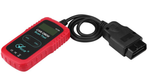

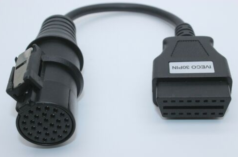

Does the Eurocargo have an OBD2 port? (I think they use a 30 pin plug)
A fault flag can be cleared with an adapter (bluetooth, USB or wifi) to an laptop or phone, or a reader
(not a recommendation for that particular device)

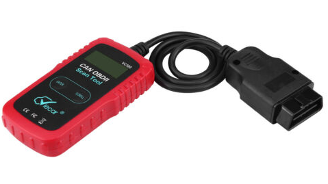

Thanks for the reply...................I dont know if it has a OBD2 port or not and cant find any info on net - will have a look sat morning
