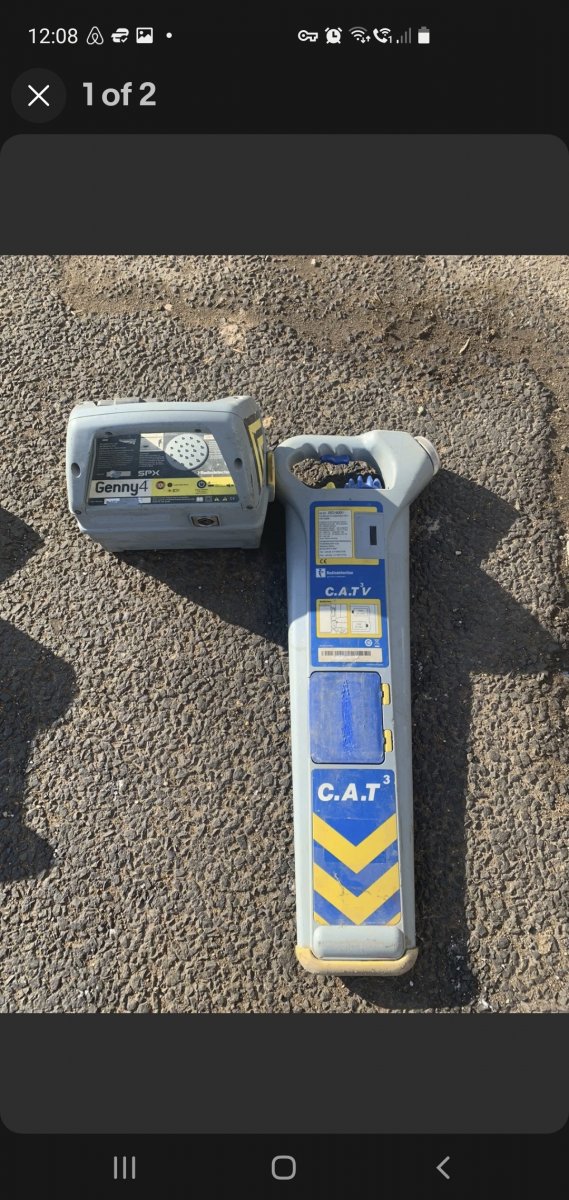

Interesting to hear about everyone's experience with buried services. So on the site I was asked to bury another electrical cable, when digging the trench discovered another electrical cable... this one looked seriously chunky.. thank god I took the tooth off my bucket is all I can say, very little indication it was there when digging as all the soil around was completely undisturbed and the warning tape right on top. With this in mind, and everyone else's experiences, I'm absolutely going to buy a cat and genny. My question is, can I get an old one of ebay or should I be buying the latest generation (no pun intended) new. Given new is 1200 ish vs used @ 300 I know what I rather..

ive got the cat4+ and genny but its not a lot of cop if you cant connect the genny. I've scanned before in a back garden (had maps from western power nothing there). indicated nothing found an armoured to a shed (long gone) that was still live.
bucket with no teeth best insurance.
If you've got a digger you must have a cat and genny end of. Cat by itself is about 10% as effective as with genny so bath are a must imo. There's always a way get a genny signal onto a cable even if its a lampost down the road.
Second hand kit isn't a problem as they need yearly calibration regardless. Sunbelt rentals do calibration and repair.
Spx radio detection cat 4 is the nicest to use I find. The Leica auto ranging are horrible. The + version just has the ability to download data incase of a cable strike to ensure it was used. So for a one man band a standard one is just as good and take a photo of using it

Would this do the job?
Mines in for calibration now
Tbh in not sure calibration is a necessity, they either work or they don't imo. A lot is made of what's going on inside but put simply a genny is just a signal generator and a cat is just a signal receiver. Calibration is more an arse covering exercise imo.
Totally agree but if not in date and you have a strike makes matters a lot worse
I disagree we had one went away for calibration. Came back a vast improvement. The accuracy was much better and it was better able to filter out the random signals from stuff bouncing it around in the ground.
thats assuming you know where the cable comes from.
Take one to bits have a look at what's inside as far as i can see other than cleaning a few connectors like battery terminals I can't see there's anything to adjust

plug it in and press calibrate. assume they use the same software made by CAT.
They have to come from somewhere and there is always a sign. They may the other side of a house from where you expect but then that's the point in using cat and genny
Basically it's a test then imho.
