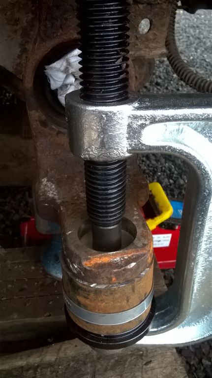

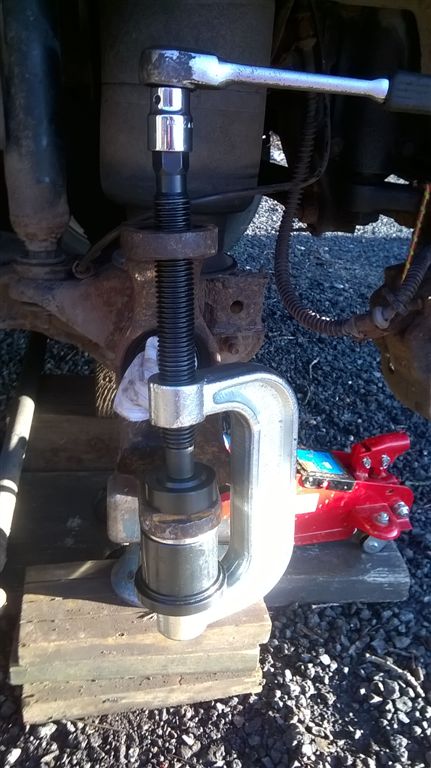

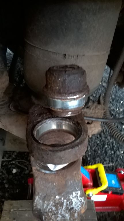

have managed to get the off side of the P38 back together in the odd dry hour or two .....
ball joints too some pressing out ....
bottom one was a bitch

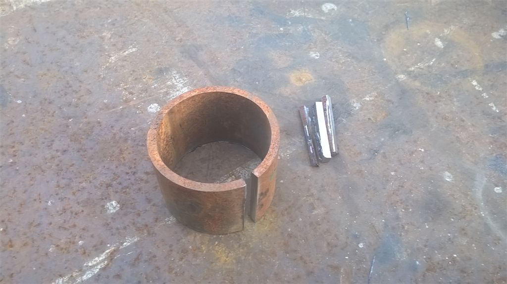

and had to make up a sleeve to suit the job .... what came with the 'new toy box' just wasn't up to it ... too big to sit on the very limited face ....
slit some 76 chs and closed it up ...
jubilee kept it nicely tight and adjusted tight to the ball joint ..

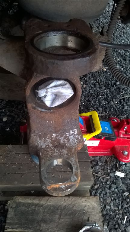

remarkable how good a condition the seats are
as were the threads in that tapered seat collet, once I'd gotten it out on the bench, cleaned it all up and put the 1mm thread file over it ... was winding in/out a treat, so saved meself some silly money on that .... local factors wanted thirty eight quid plus VAT per side :oops::mad: .... was functional enough to reuse anyway, even if it was missing its 6 flats .. it went back in OK

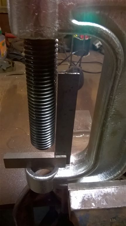

pressing the new balls in was a bit of a challenge initially, 'til I sussed the press clamp had snook out past QC without a cursory glance ...

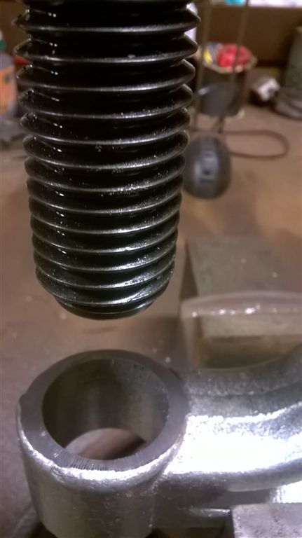

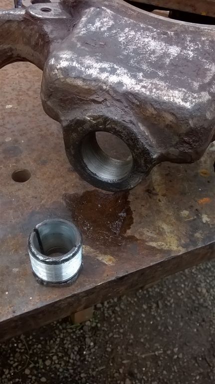

some time spent with a file sorted the seat out ...
followed by a bit of die grinder action to get the bore right for the tooling to sit square ... next time the Ajax is in use I'll bore the whole thing out a mil ... just did enough to seat the tooling square, for now ... worked a treat
bottom one in .... on to the top ......... an' I've run out of pix again :(:rolleyes:
