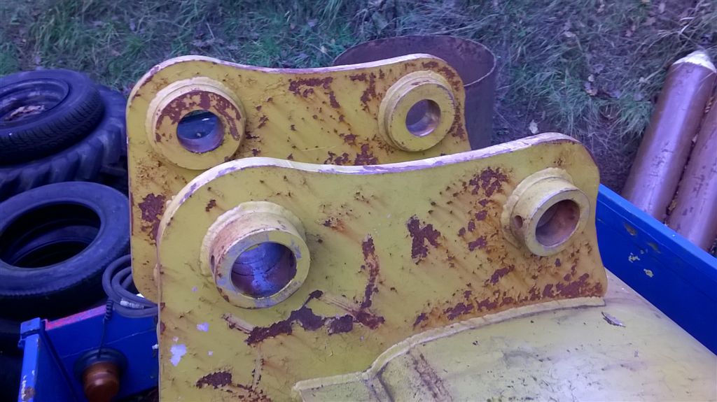

thought i'd have a crack at getting the pins out o' the SEC .....
hard fought, this bugger was, :( even after a bit of a clean off ..... but got the lil' sod eventually ....
T'other one was a POP .... aside from being 'kin heavy ... would not want one of these on yer foot :oops: toe caps or not ... had to start with the right lil' b'stard :rolleyes::unsure:... but at least the easy one was a pleasant surprise :giggle::giggle::cool:

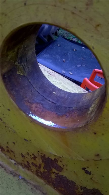

.... as suspected ... not through bosses .. face fixed and plates bored at pin sizes .....
got them all cleaned out and polished up a bit, before giving 'em a good coat o' grease, ... as the bloody rain kicked off again .... and the day light disappeared :cry::mad:

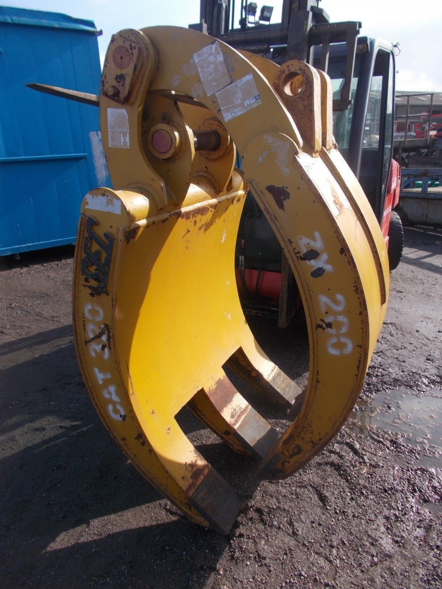

regrettably these are at 18" ctrs ..... 'Drema's Miller is 400s, so can't just either, bush it down, or get the pins reduced in the middle 280mm :( ... but as said before, I have a few ideas :rolleyes: ... just deciding on the easiest / most convenient / least effort way to get there .... the one quandry I really have is whether to adapt, so's it'll revert to original or simply alter it permanently ??? :unsure::unsure: 'sahelluva weapon though .... build quality is real nice :cool:
Pins cleaned up well on the bench .. even the grease ports took lube and ejected what was in there (y) ... went round this with the gun while it was in me mitts and all took very little TBF ... I'd be surprised if this has ever done any work :rolleyes: .... now all I need is some dryness ...... absoluuuutely lashing it down here again ... bouncing off the Veluxes upstairs ... can hear it down here -- above Pam's TV volume :oops::mad:
Not as big or cheap as mine though Albert
granted ;) ... but ..... not as dear as this one either at ยฃ2250 :oops: https://www.ebay.co.uk/itm/SEC-Digg...776235?hash=item2ada1a31eb:g:79cAAOSwLlVana0b
and'll be a POP to pick up under the Miller, once I've sorted it :giggle:....... plus it's full hydraulic grip :cool: and about the right size for me 15 tonner :)... that beast of yours is under a 22 tonner :oops: :p and's gonna take you an hour or two to mount whenever you need it :cry:

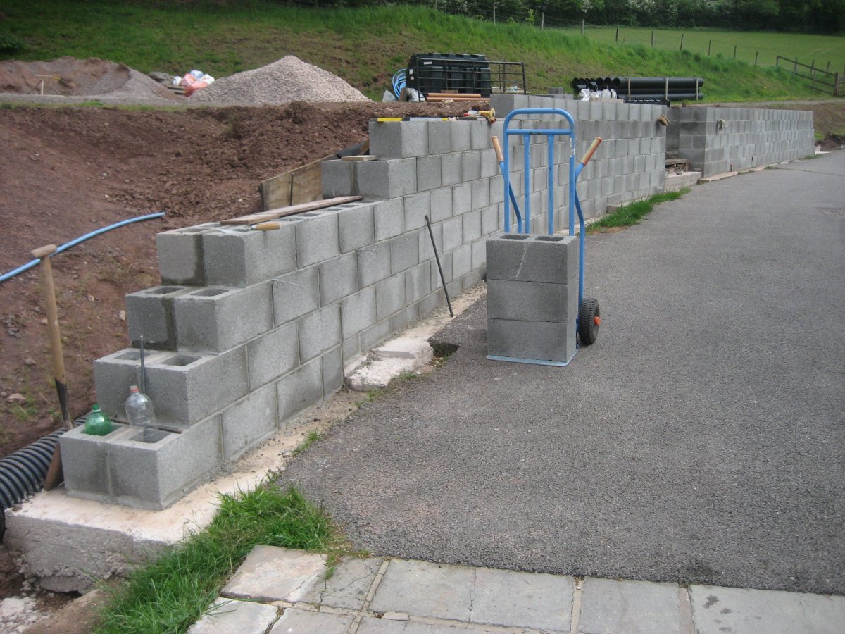

love his BLUE hi viz :ROFLMAO::ROFLMAO: ...... and them pissy lil' hands'd struggle with 1200, 9" hollows:rolleyes: aside from mixing and laying all the 36" wide founds .... tha's not a wall ...... this is a wall :giggle::giggle:
IMG_3023.jpg IMG_2970.jpg IMG_3043.jpg IMG_3023.jpgIMG_3043.jpg IMG_3044.jpg IMG_3088.jpg IMG_3170.jpg IMG_3166.jpg IMG_3193.jpg IMG_2987.jpg
As fast as I could get it up SWMBO had me back filling it so she could get on with creating her flowery bits :rolleyes: :cry:

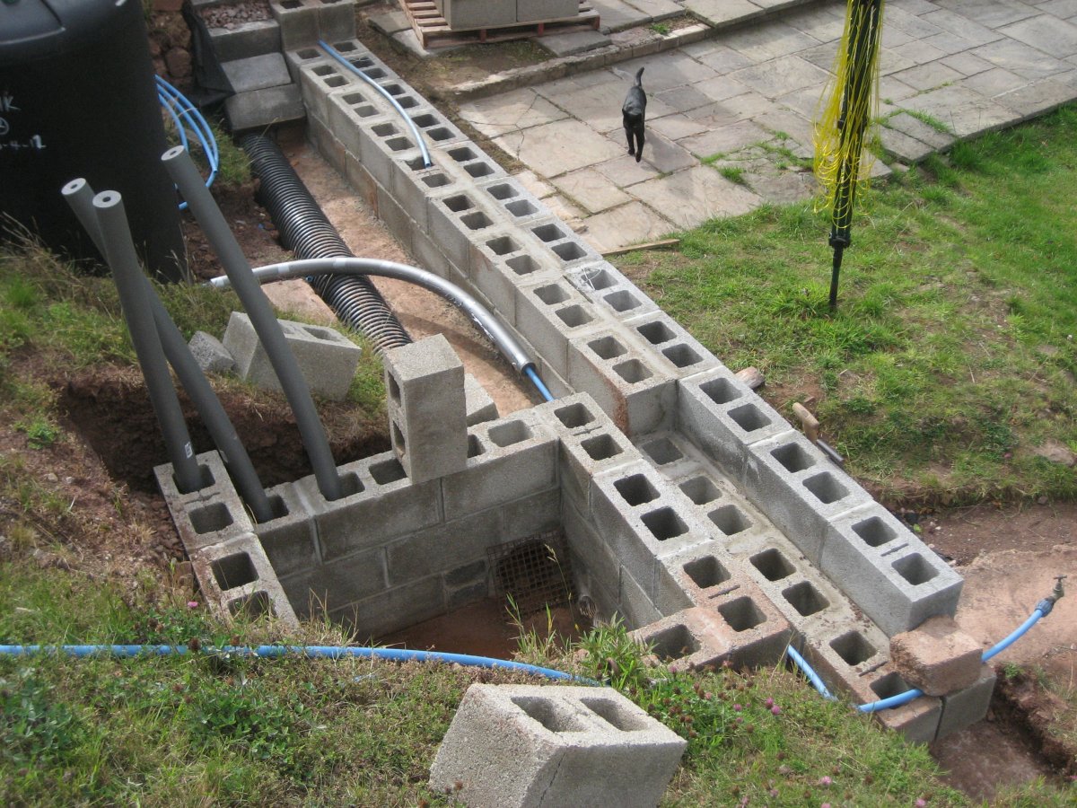

that's mine Alex .... down the side of the drive
never laid a 9" hollow before .... got reasonable at it after 1200 of the buggers .... concrete filled ... mostly - still got some left to fill on the outer skin ....(when i feel like mixing it all )
it's also the one that needs stone facing - 80 m2 ... if the ****ing guy ever turns up :mad:

Looks good - I did wonder given the massive overkill on the drainage, had your fingerprints all over it... how goes the bit with the neighbour?
๐Ÿ˜‚ ๐Ÿ˜‚
Slow mate ..... has pissed down here solidly for several days ....only decent-ish day, yesterday and didn't turn up .... they'm about half way up on the corners ...
... as for drainage ... it's needed, believe me ... the previous retainer fell down due to lack of it -- before our time thankfully - just :rolleyes:
