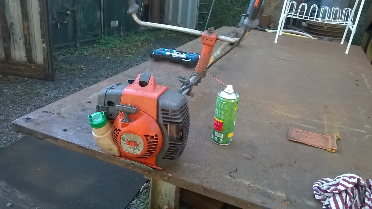

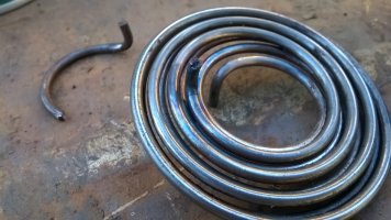

Bit of a 'pottery' day today, recovering and Pam decided she wanted to strim the edges of the lawn after lunch .. got herself togged and harnessed .. gave the Husqy a yank or six - she's not quite got the knack of a cold start, despite being shown many times -- having listened to the efforts I had to go and give it the required 'yank' for a first time start on choke .... gave it some and it just went click, click, click - bugger !!
Summat not right in the pull cord dept.

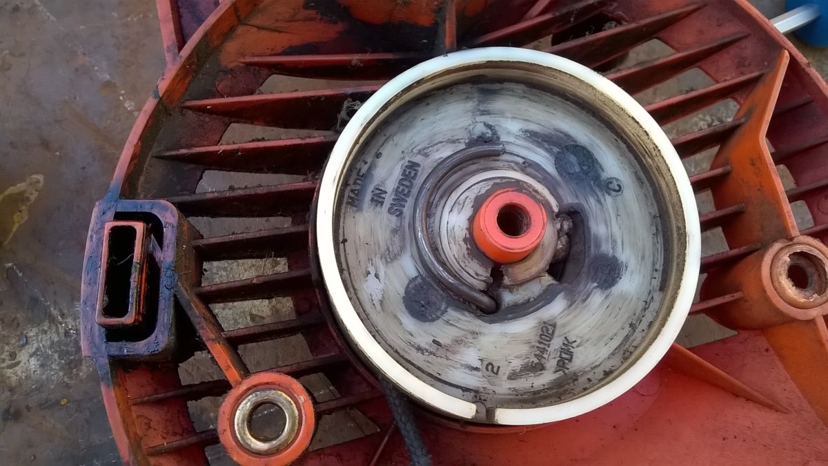

So .. bench time for the Husqy .. got it all apart and seemed to be fine - suspected the engagement pawls - got that assembly off and gave it a good clean with some carb cleaner - moved a lot free-er - little bitch to remove - all back together to try - nah!!
back apart and pulling at the cord all moving fine, so took a hold of the drive plate and it weren't going round under load

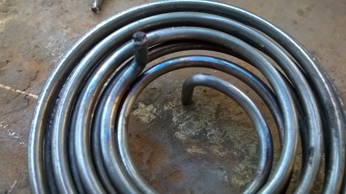

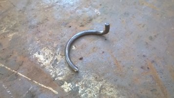

so pulled that apart and it's got an anti snatch set up in there with a double wound spring - very clever - #cept the one drive leg'd given up the struggle
so ....... into the vice, little blow torch out and warm up the busted end of yon spring - hey presto temp. repair, 'til LS can get/send me a new one
re-assemble and test drive
