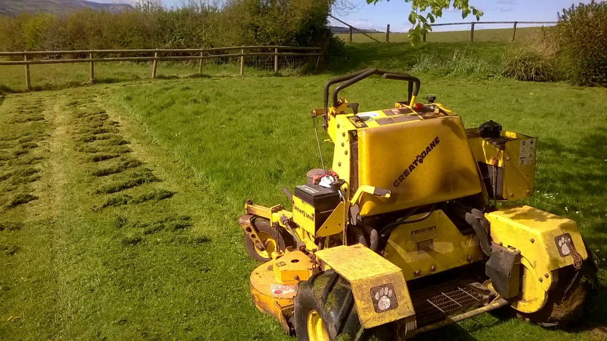

Harper left at three with mummy and I was out coaxing the Dane into life in minutes ... not a bad start for a nigh on 6 month rest ... look out lawn-here we come ... rain or no rain
got about a third of the way round and it stopped cutting :( and started smoking :oops::mad:
thought I'd done the first belt of the season ... cover off and it's fine, so hoisted the deck up and shot back up me patch and put the arse up on ramps, to get a look underneath ..
huge solid clod of cuttings jamming the one blade ... fought it out with a small pry bar and we were back in business ...

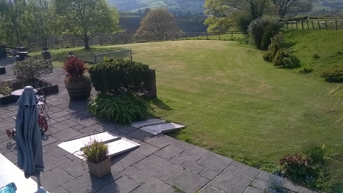

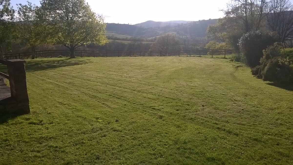

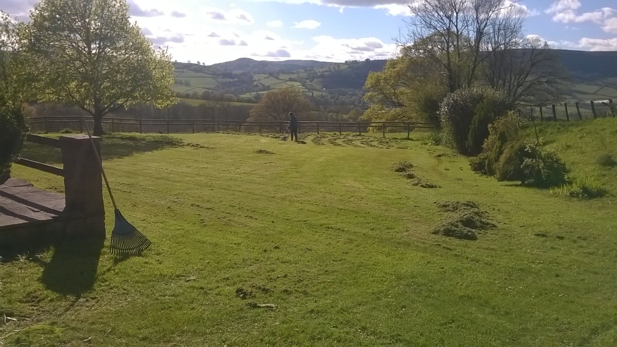

finished the lawn and did the grass beside the drive, in an equal state of over-growth, plus the bank the other side of the drive, which wasn't quite as bad .... parked the Dane and headed down the lawn with a barrow and a rake to start collecting it all up ... to find Pam hobbling about with a.n.other rake :cool:
she'd been at it whilst I'd been mowing the rest (thankfully) and having barrowed up all she'd piled up, didn't take the two of us much more effort to finish it off
been a lovely afternoon, sunwise ... cold, blowing like fook and drying it all nicely ..... it's gonna get the Countax round it tomorrow, once the frost has gone ('kin cold here tonight) and see how it looks after that ... found one spot to be avoided and dug a gert trench with the herring bones ... will deffo keep the Countax away from that tomorrow :oops::oops:
Fair play to the Dane, it did a sterling job today of massacring some serious growth .. now to get it back to looking like a lawn

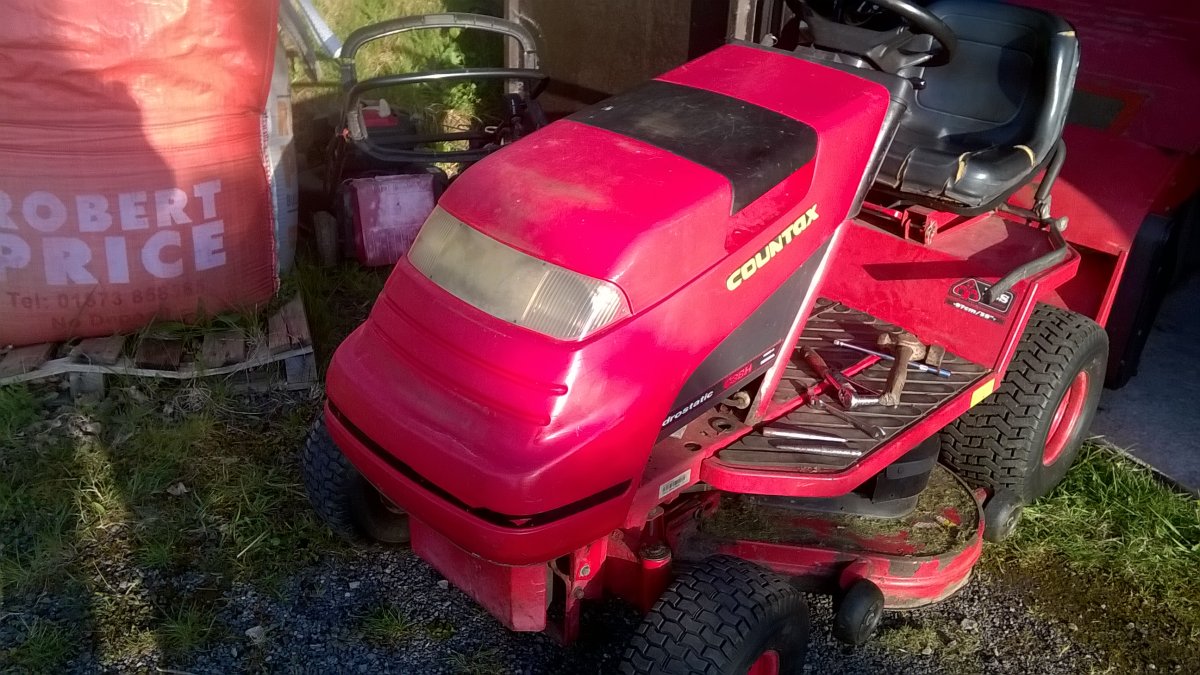

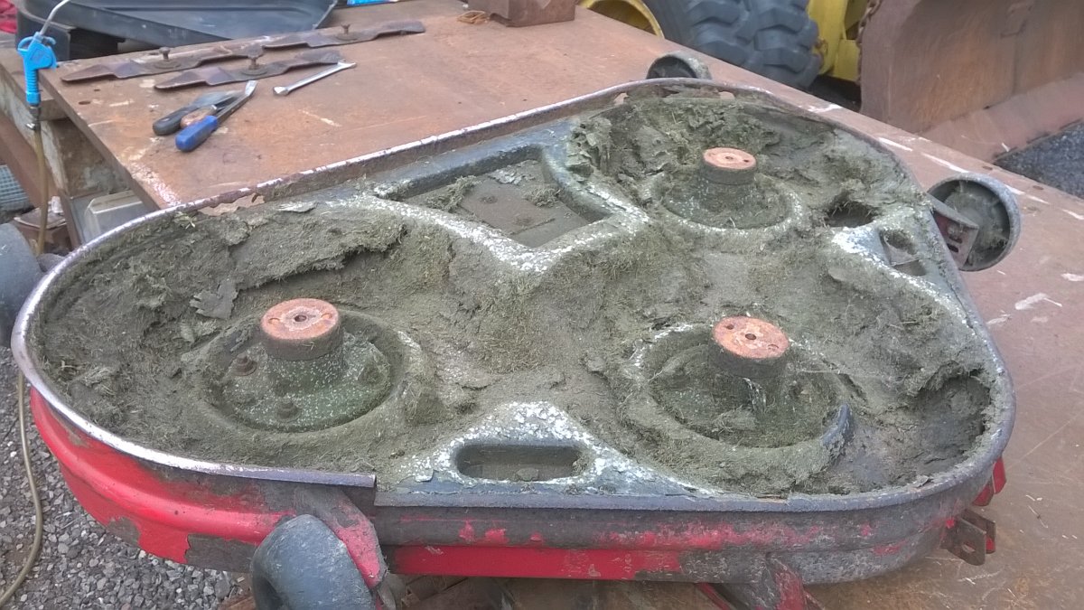

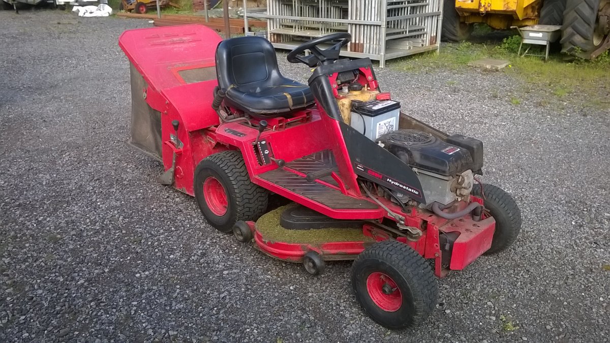

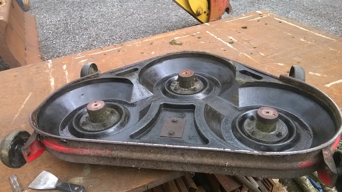

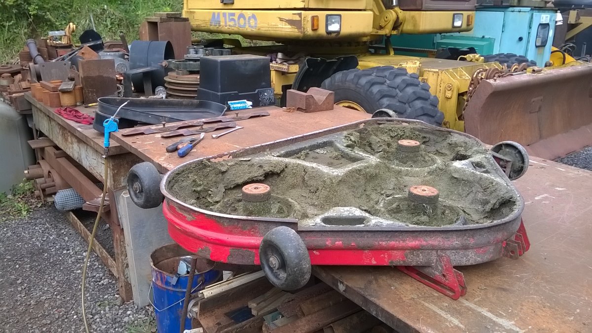

first job of the day ... deck off the Countax and clean it ready for its first cut of the season ...
WP_20240421_12_52_14_Pro.jpg WP_20240421_12_52_18_Pro.jpg WP_20240421_13_11_30_Pro.jpg
and back together
took me two cuts and three circuits to get it all down and all collected up ... yet another major pile of grass
but worth the effort

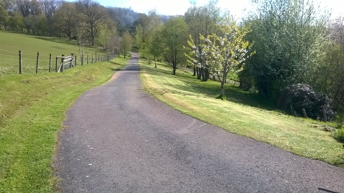

then ran down the side of the drive for four lengths to get it down and collected
bum hanging off the uphill side, keeping the wheel on the deck and forward momentum going .... any further down the slope is just hard work maintaining traction

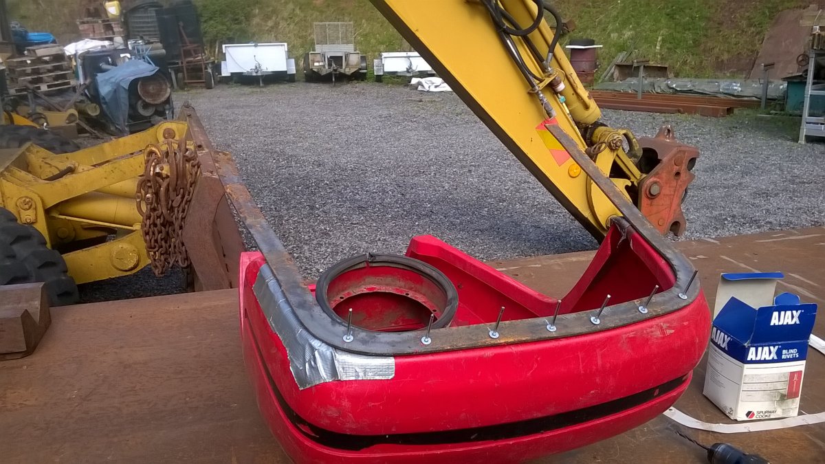

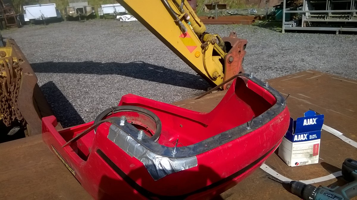

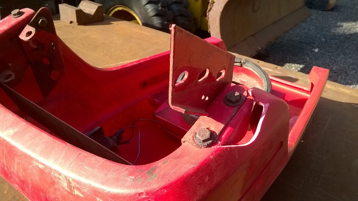

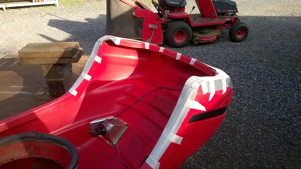

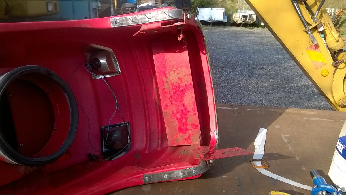

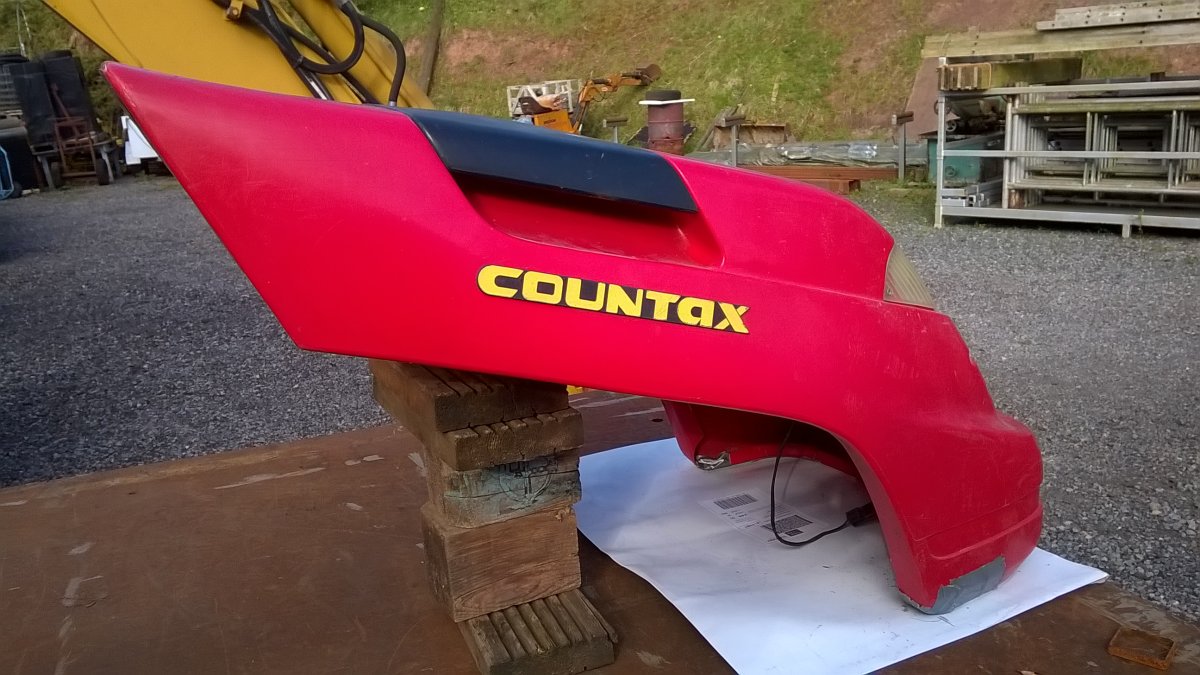

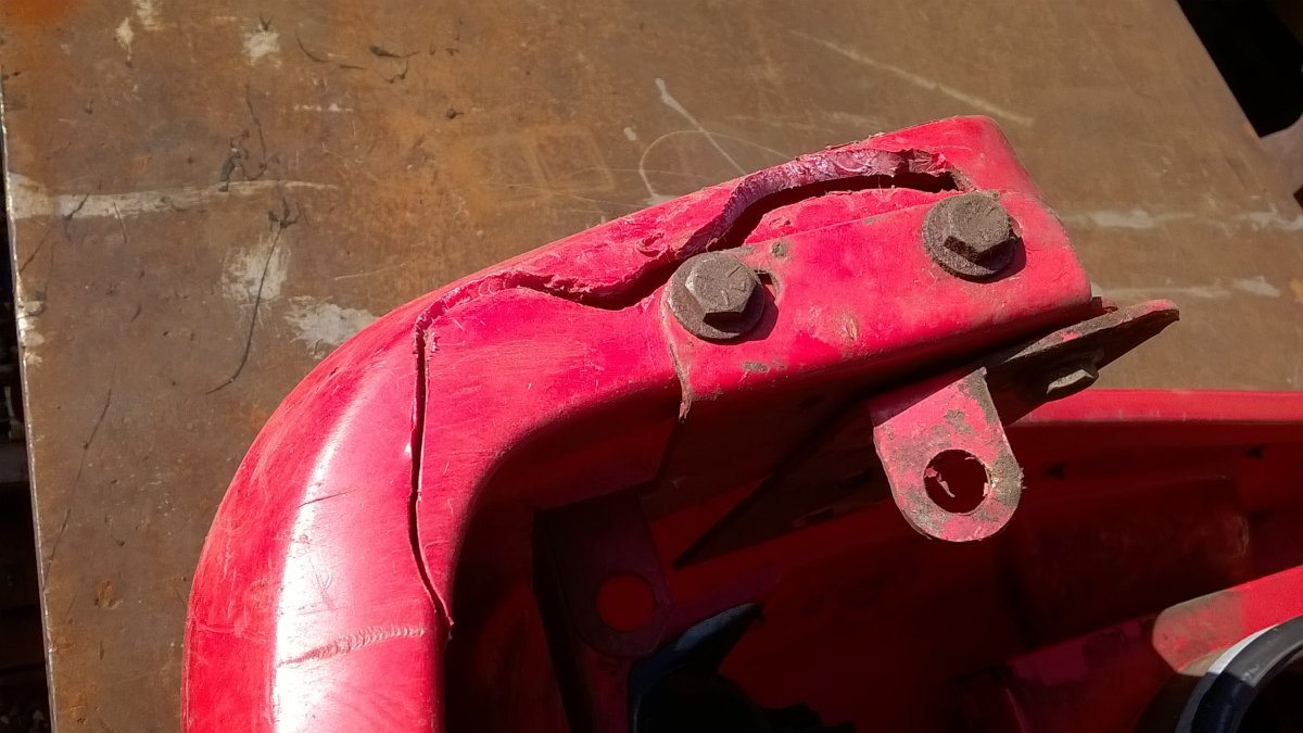

thought I'd give her an oil change while it was nice and warm so headed back to me patch and the tool box ... flipped the bonnet and it damned near fell off :(

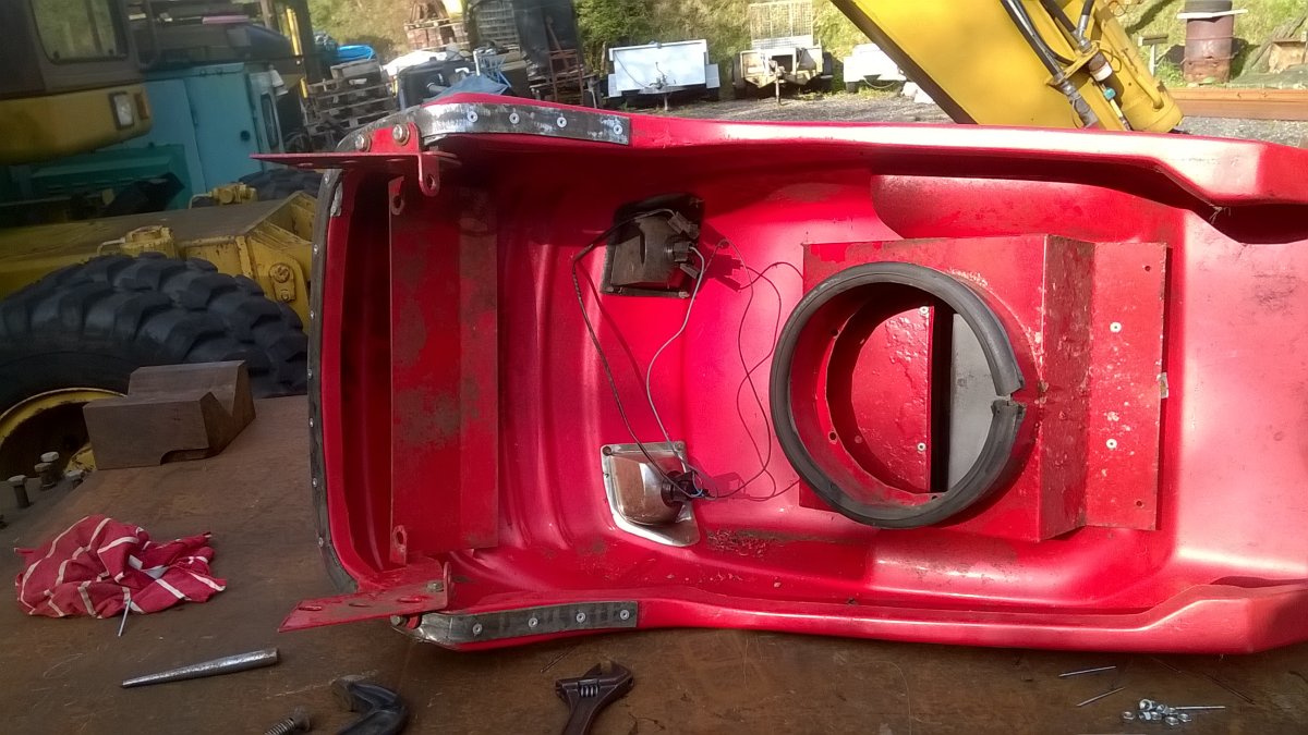

the plastic has obviously succumbed to the inevitable and given up the ghost :mad: ... no choice other than get its support system off and inspect the carnage ..... pretty poor design really, but has survived for the 14 years I've had it and many before that too ... having found the bar code label this afters, its two days short of its 27th birthday :oops::oops::oops: (was mint when I bought it s/hand)

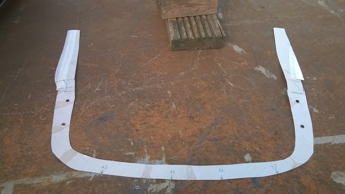

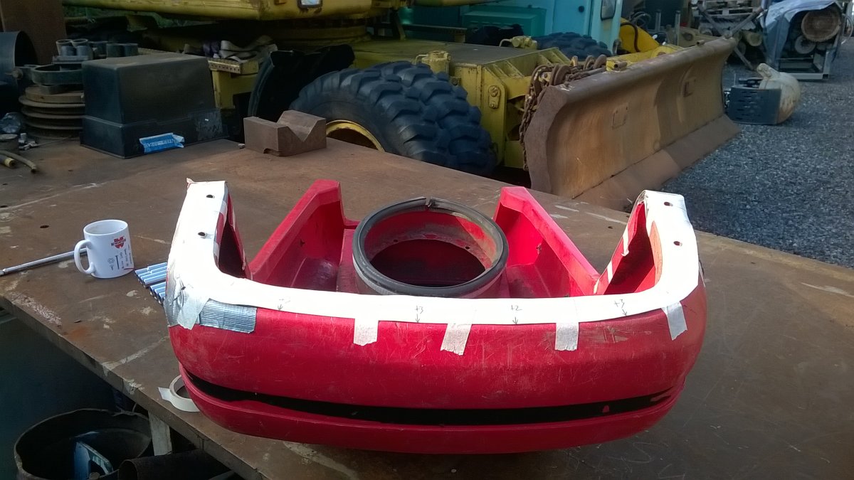

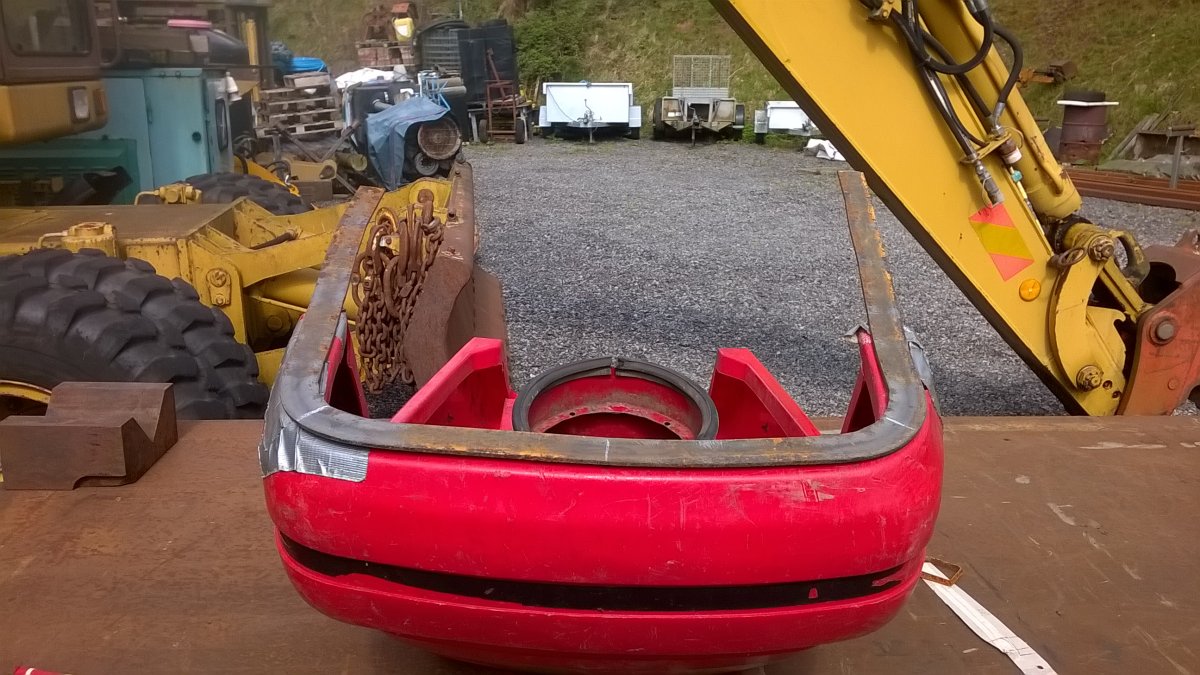

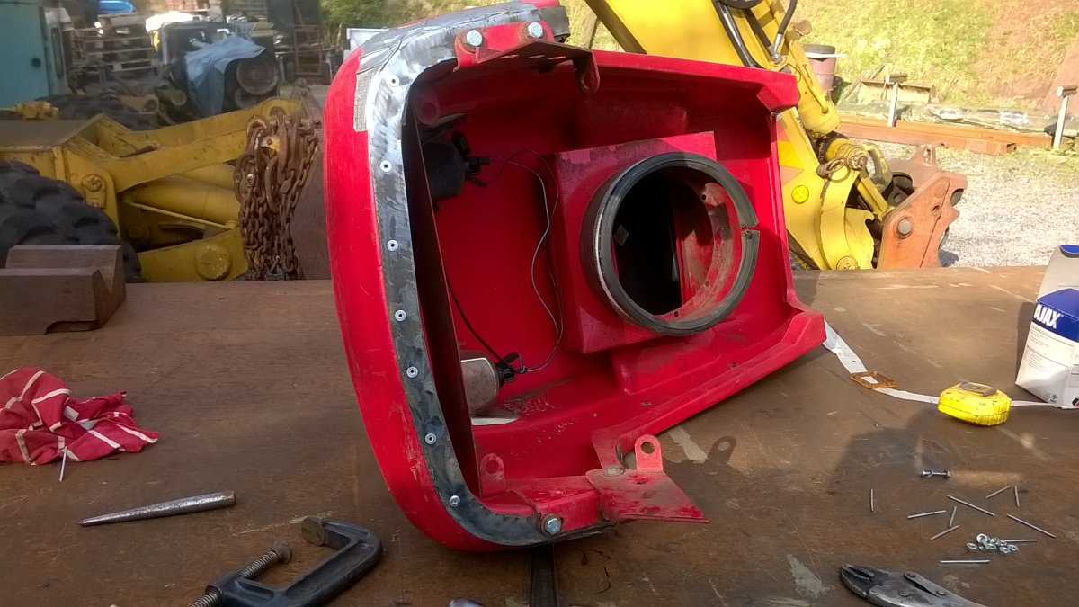

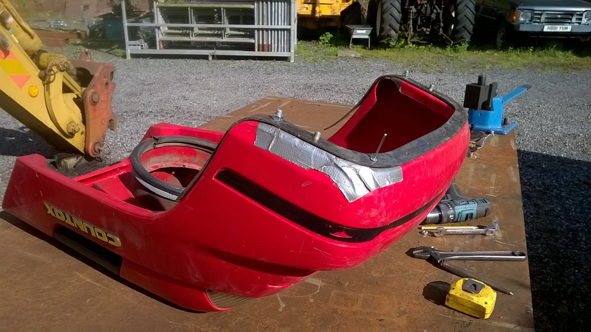

bit of head scratching and decided it was gonna need some re-enforcing to get it to go back in place ... so stripped the ironmongery off and duct taped it all back into place to set it up to make a template of what was needed ..
drawn around and snipped out .. set it in place for a further suss
now just need to replicate this in steel, shape it up and fix it to the offending beast
watch this space :rolleyes:gonna take some creating :( and attaching :unsure:
View attachment 59664 View attachment 59663 View attachment 59662
and back together

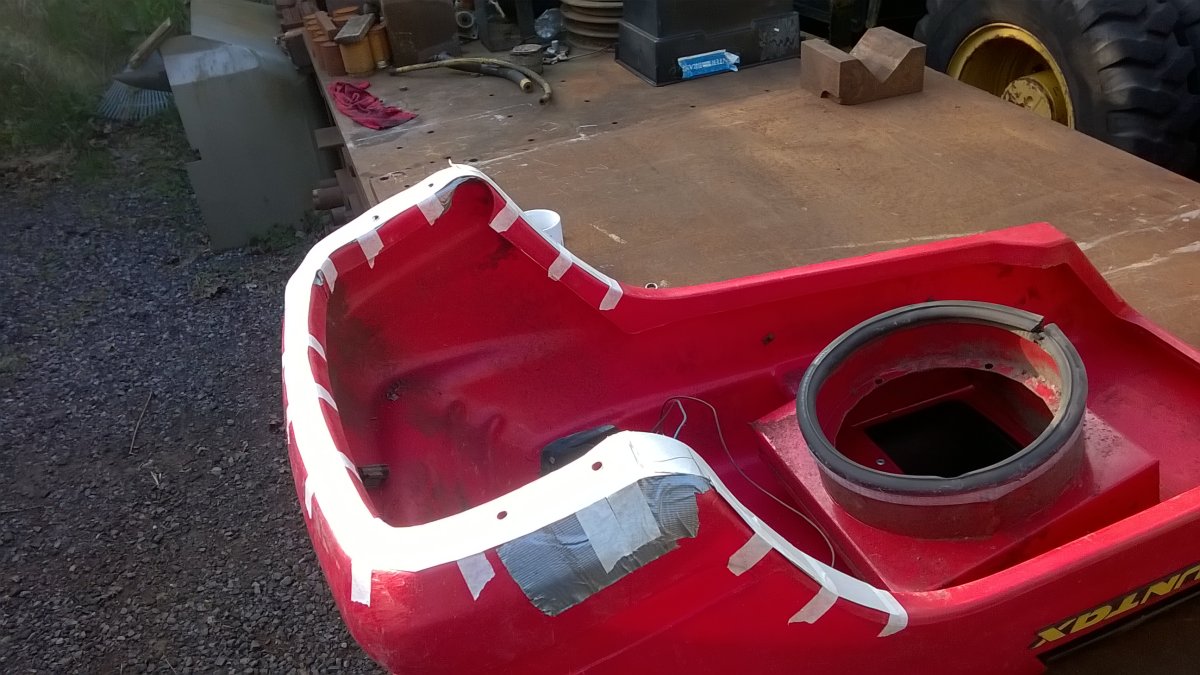

View attachment 59670 View attachment 59671
View attachment 59669 ...
View attachment 59667 View attachment 59666 View attachment 59665

You should have cleaned the deck before you parked it up last year. Naughty boy

I've got a Weller heat gun I've had since I was a teenager, with plastic welding heads for it .... this is gonna need more than a bit of welding to keep it in once piece :rolleyes: .. has the entire weight of the bonnet attached to those two points, plus all the leverage as it's opened :(
I did ....... then did one more cut .... remarkable how much gathered in that one cut .... it's usually a lot worse after several weeks mowing ..... good job it has the plastic mulching liner, but even with that the deck is looking fairly sorry in places.
Is there any reason you run it with the muching liner Gra?
I found mine lifted better when it was laying down a swathe of a longer grass blade for the brush sweeper to collect.
The brush sweeper had more trouble with the fine clippings, especially when it was wet, they rolled up in balls and rolled in front of the sweeper. :mad:
was in there when I had it and have never thought about taking it out ...
TBH it's probably holding the deck together these days ...
when I can get around it regularly it's not an issue and I could do with replacing some of the combs in the collector too

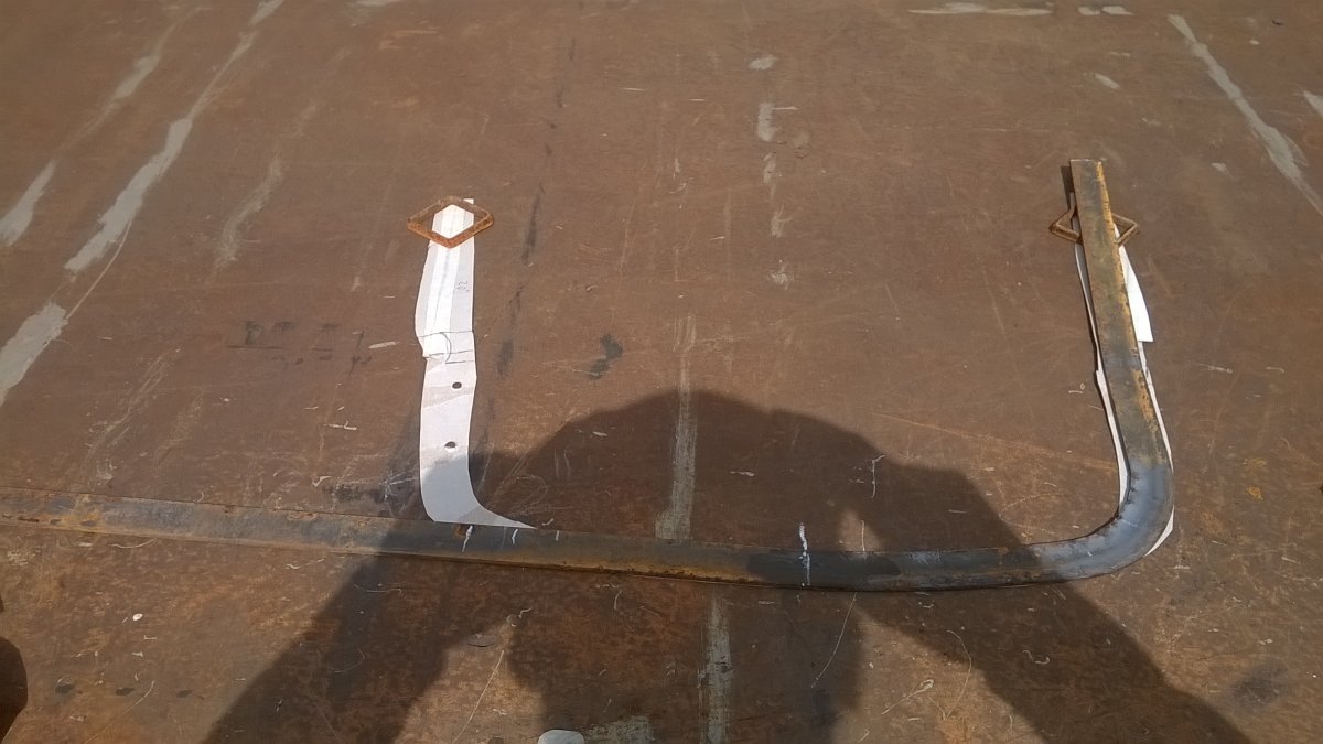

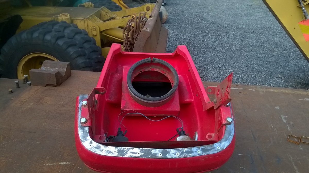

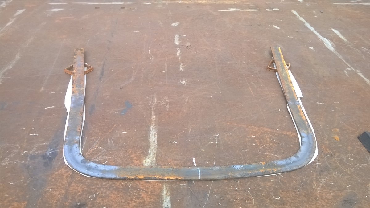

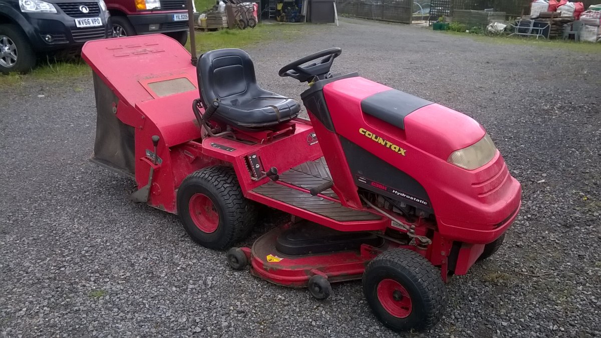

masterful metal manipulation :giggle::giggle: bit of a horseshoe for the Countax's bonnet repair
took a bit of persuading into shape in all three dimensions ... but got there slowly

a lot of tweaking later and got the hinge back in place
and everything fixed in place ... did consider giving it a coat of summat, but time was pushing on to tea time and really did not want to be coming back to it .. so thought sod it .. it lives indoors and could always give it a touch up again
and the bell tolled -- for tea :rolleyes::giggle:🍽️🍽️
so it was a back to it job - tidy up and then enlist Pam's help to get it back in place
went on a treat and is the firmest it's ever been ......... and back in its stable :giggle:(y)
