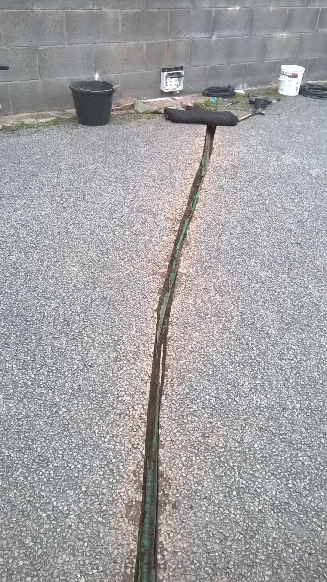

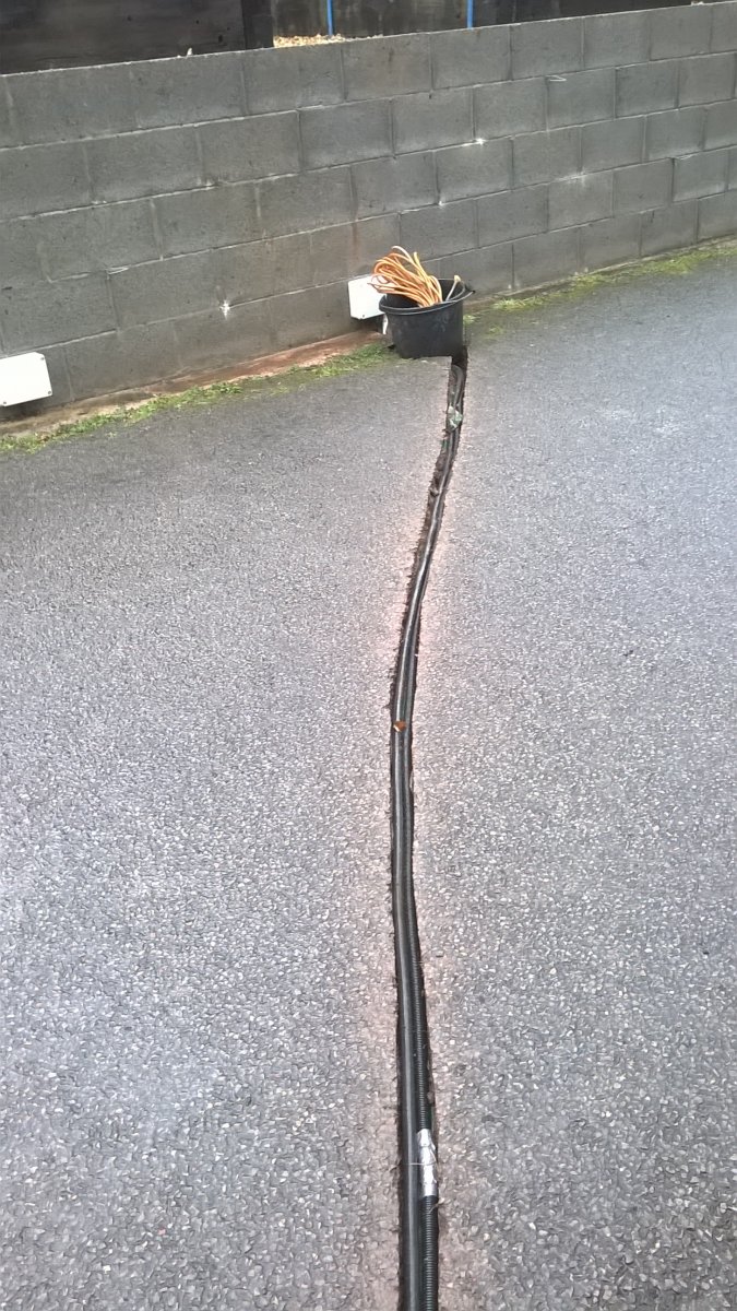

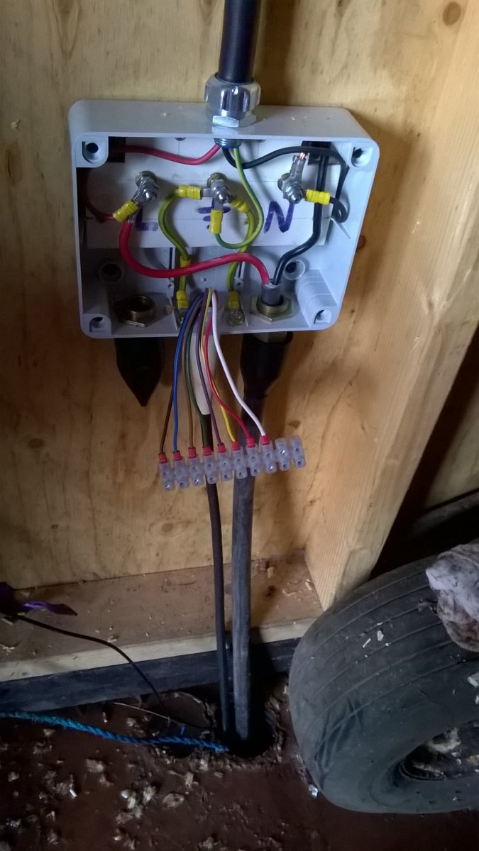

Like a cripple this morning ..... too much time on my knees yesterday :( persuading the cables into their new home in the floor, making connections, sealing and securing everything ....
this channel contains our oil line from the tank (now in't black shed and the boiler in the house ....
would've been happier to see it a few inches deeper, :rolleyes: but I wasn't gonna disturb the oil line and it's only two to three inches wide so doesn't suffer much in the way of loading ;)

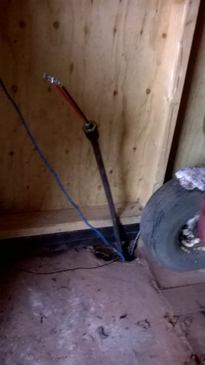

the 'python' and a.n.other conduit, for lighting control, took some wrestling into place .. :unsure:
especially at the house end ....

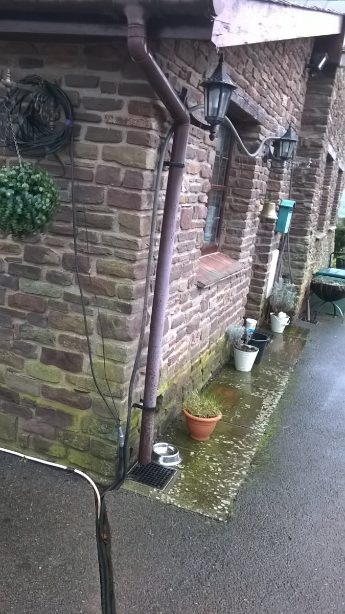

was pretty rough here yesterday and we were getting rained on by this point, so it got strung out/coiled up out the way (that barge board's looking a tad ropey) :oops:

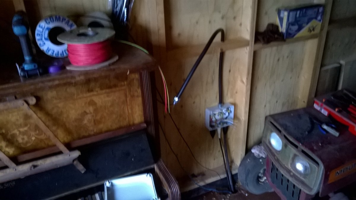

Was gonna run them both along the bottom of the wall in a similar gulley, to the oil pipe's one, between the wall and the flag stones, then up the wall in the corner ..... but ..... couldn't get the buggers between the drain gulley and the wall:( ...some one'd gobbed a load of mortar in the gap :( ......so a rethink is being had :unsure:

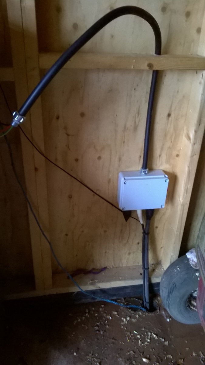

did manage to get the shed end trimmed, glanded up and terminated, ready for its box, before the light beat me :cry:
Today has been seriously wild here .... horizontal rain and howling winds :oops: .... can't put anything down unless it's bloody heavy ;)
got the box onto the shed end .....
a feed up to the consumer unit laid in ready, for when it arrives ....

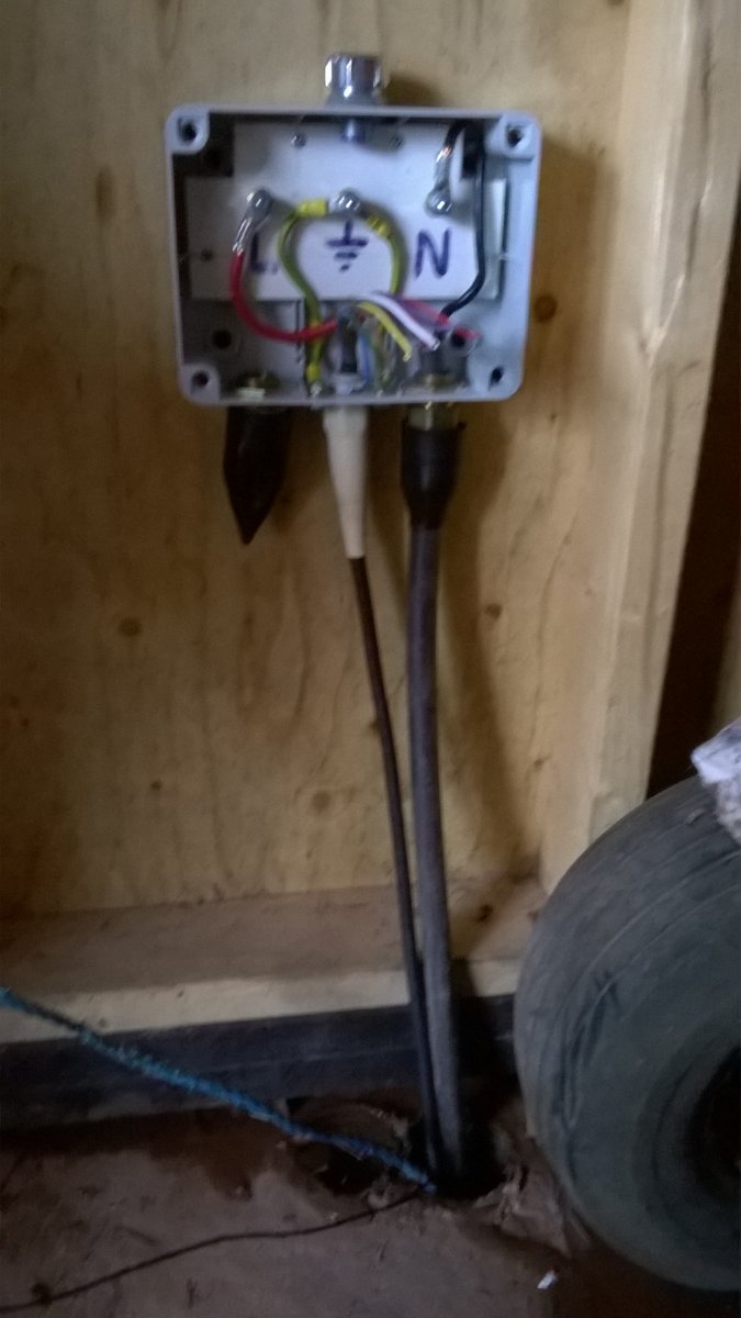

I love Anaconda:love: .... much easier to wrestle than pythons :giggle: ...... everything got terminated .....
and 'buttoned down' for the night
any suggestions for capping that duct off? :confused:..... but'd need to be able to open it again if need be .. in case :rolleyes: ---- expanding styro foam???:unsure:
the second gland and duct is to allow a.n.other cable up the patch to provide a new leccy feed to me boxes, as and when they get relocated ... soon hopefully :rolleyes::)

Use steel wool to plug the duct, the long tailed feckers can't handle it................................

looks like you had the same sort of rain as we had :rolleyes:....... 'cept yours was frozen :oops::LOL:
I like the steel wool idea (y):cool:

Fill the duct end with steel wool as mentioned, cap off with one of these https://www.amazon.co.uk/dp/B00AO76BYS/ref=dp_cerb_2
You can get them in various diameters to match your duct diameter. Gives you a pre-cut for the cable and the option of adapting if other cables have to be run later on.
great idea Boyo (y):cool::)
this is 60mm ducting so I'll have to measure the internal tomorrow :unsure: .... plastic tube end caps also spring to mind now too :rolleyes:
a good dose of wire wool behind 'em too for Ratus Ratus :mad: ..... in case ..... no chance of anything getting in t'other end in the wall ... the box is covering it ;) ...... and sod all came out when the snake went down it :LOL:
