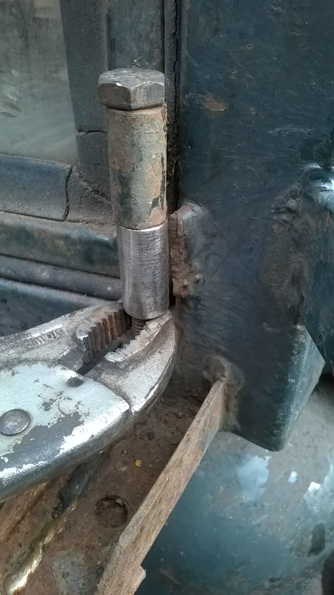

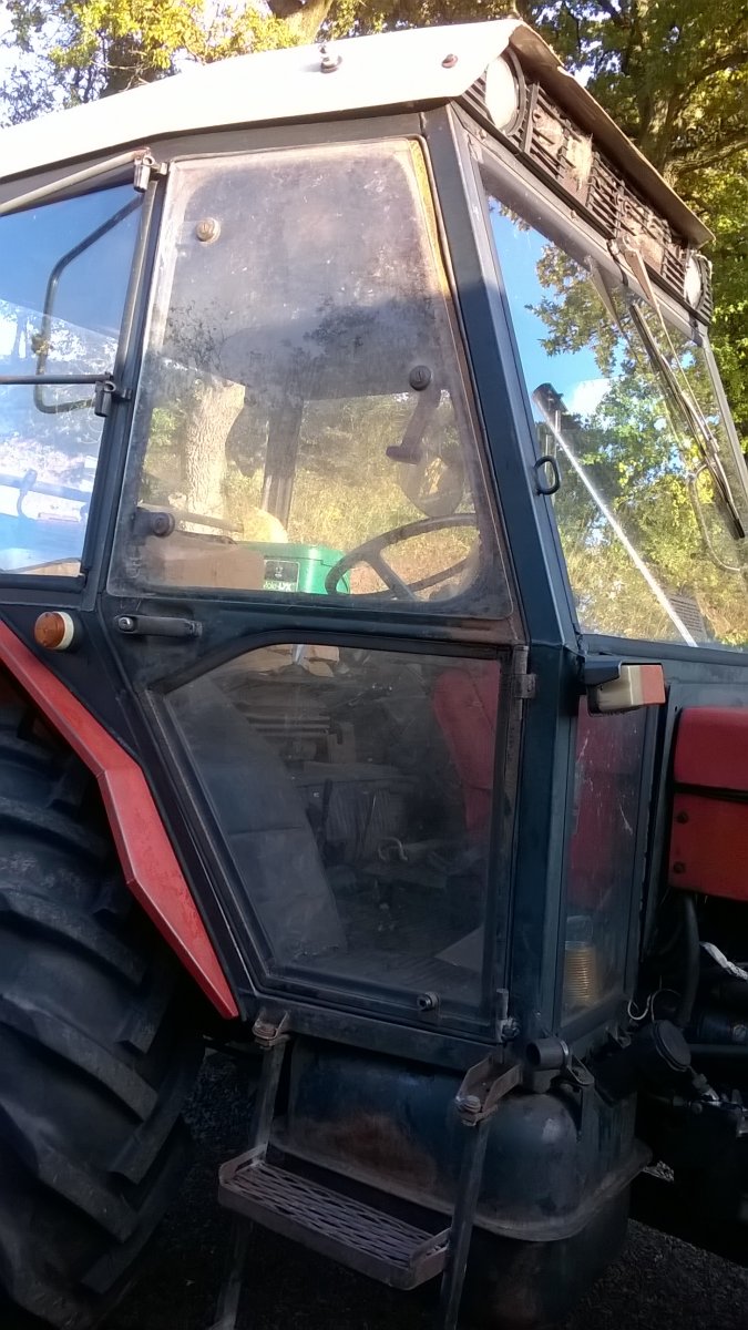

the Zetor has a door missing ... not lost as I have it, but now't keeping it in place, so knocked up a new lower hinge pivot
and set about persuading it to stay where it's needed ...

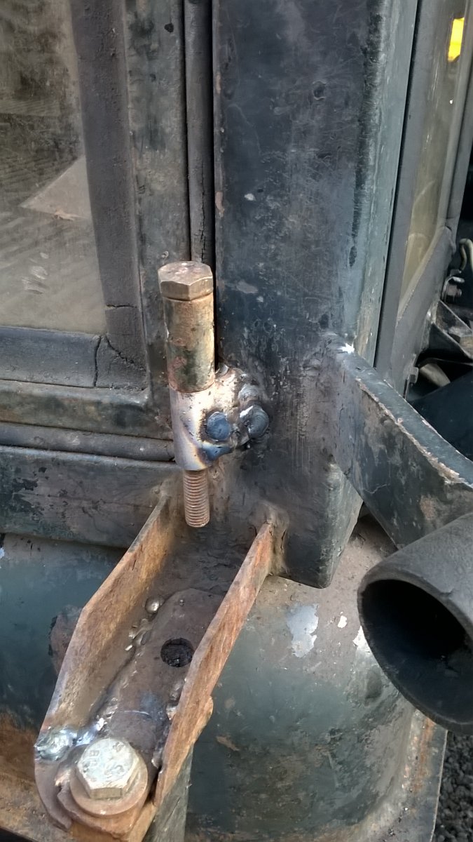

little bit of a fettle required to 'pretty it up' a bit
but it ain't gonna fall off in a hurry ... and no the step bracket is sod all to do with me ... a couple of new ones required, I think, or sorting back to somewhere near OE/as supplied ... did sort the steps out a tad though, before they fell apart ....
after straightening 'em out to somewhere like they were supposed to be ...... they no longer flail about when you park yer weight on 'em ...

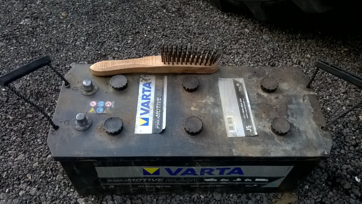

was going to tackle the ones attached to the battery compartment next, on t'other side, 'til I discovered the state of the leads and clamps and hauled said battery out for sorting the issues
fair-ish lump and took some persuading out the compartment, due to the so so nature of the steps attached to the lid .. but got it out, remade the lead ends with some nice new clamps and got it back in position just as tea got called by the tolling of the bell, as usual. :giggle:

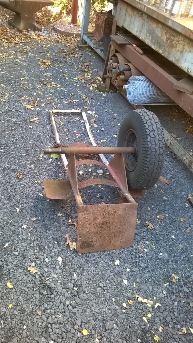

whilst I'd got me bar and the necessary out, I thought i'd also deal with a puncy, that's been 'inconveniently' disabling me bottle trolley sack trucky jobbie ... makes moving 'em a doddle on rough ground .....
the right tool for the job makes life so much easier ...
for sorting leaky round things ... comes off sweet as with the bar .... and back on without tube issues too .... simples!! :giggle:
job sorted and trolley back to a serviceable state (y)

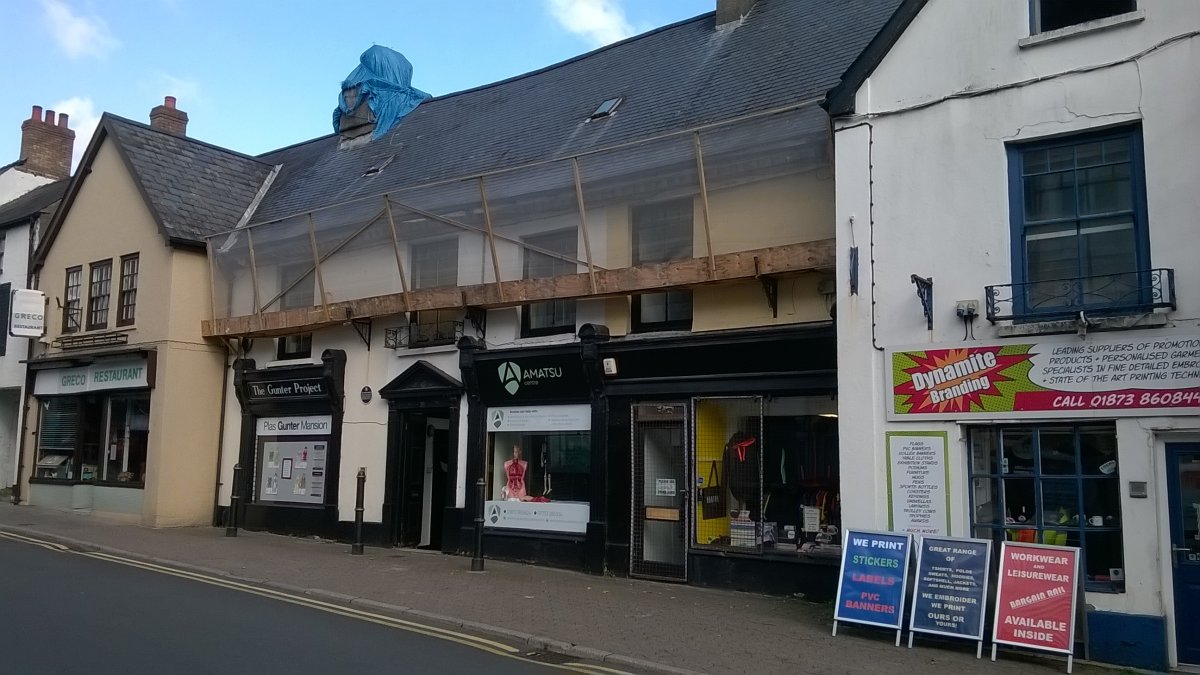

Thought we'd better go and have a stock up on the grub front this morning and needed to go into town for a few other issues too so that disposed of a few hours ... walking back down the street, towards my old site and noticed this ....
ferk only knows WTF they're up to .... but those crimbo tree brackets were never designed to be used for scaffolding .. I made 'em ,many years ago ... there's a couple of hundred of the things about the town ... they'm solid and solidly fixed ... but scaff brackets, they ain't :LOL: ... there's all sorts of metalwork, Druid related, lurking about the town
the building they're attached to is one of the oldest structures in the street ... all that facade was once one big 'manor house', which has gotten divided up over the centuries (circa 14 or 15 summat) ... the rear of it is a lot more 'original' :):cool: ..... don't know whether they're planning on restoring the frontage, and certainly looks like the chimney's in for some attention ... there's a big notice board in the one window (see top pic) and I should've gone and had a better look, but was in a hurry
Must've been 'some pile of bricks' in its hey day/prime :rolleyes:(y)
never seen the town so quiet .... not even on a grim winter Sunday ... like a ghost town almost ....... and have never walked into the main post office ... and been the only one in there :oops:o_O ..... very strange times :unsure:
I recon they are going to be working on the roof and it's to stop any falling slates so they don't have to close the pathway?
was my thoughts too ..... however .. unknown quantity, those brackets ... been up well over 20 years that i can recall and yon roof looked pretty fair from where i was stood.
From past experience of working on buildings in the street, the walls are pretty iffy, in most cases, rubble with about 2" of render ... nightmare to install steel into ..... a pocket used to end up being a gaping chasm .... a hell of a lot of these buildings have my steelwork in replacing rotten beams to the upper floors ... did one maaaany years ago with three levels of steel work ... built like a Christmas tree with a very big centre column and everything branched off it to the surrounding walls. was open from GF to the slates, completely gutted out - 4 floors.

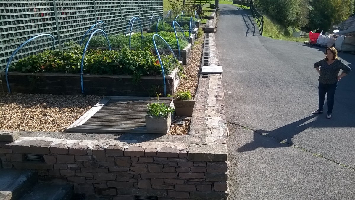

went shopping for flag stones yesterday .... came back with a grey sample and a brown stone roof tile as we were convinced we'd like the grey for contrast ....
took one look at it and we both said "Nah ... brown" .... stuck it back in the Golf and shot back to the quarry .... and grabbed/bought the three sizes they had in brown ... 'fore picking up Clara from school on the way back
both my shoulders are wrecked today from wrestling the 3'x 2' one into the boot :(.... so much for the metric system o_O... metres, 750s and 500s ain't on the menu :mad:... 18" x 24", 24" x 24" or 24" x 36" is the choice 🤬🤬 ....... having built the wall to suit 500mm caps I am now gonna have to cut down the 2 footers to suit NOT a happy Druid ... but i am only gonna spend on this once and we want it looking right :mad:
will now have to rework the requirements for the steps and top landing area to try to fit the imperial flags.
need to get this sorted PDQ 'fore we all get locked down again ... quarry's 4 miles-ish away .... t'other side of the border in England :oops: and Reo's 'sposed to be back Monday ... assuming they let him back into Wales ... and need to keep him busy, while we've got him back :giggle: .... he's gonna be well PO-ed that his truck's not been sorted, in spite of me chasing 'em every couple of days to come and get it to sort for him !! :(:mad:

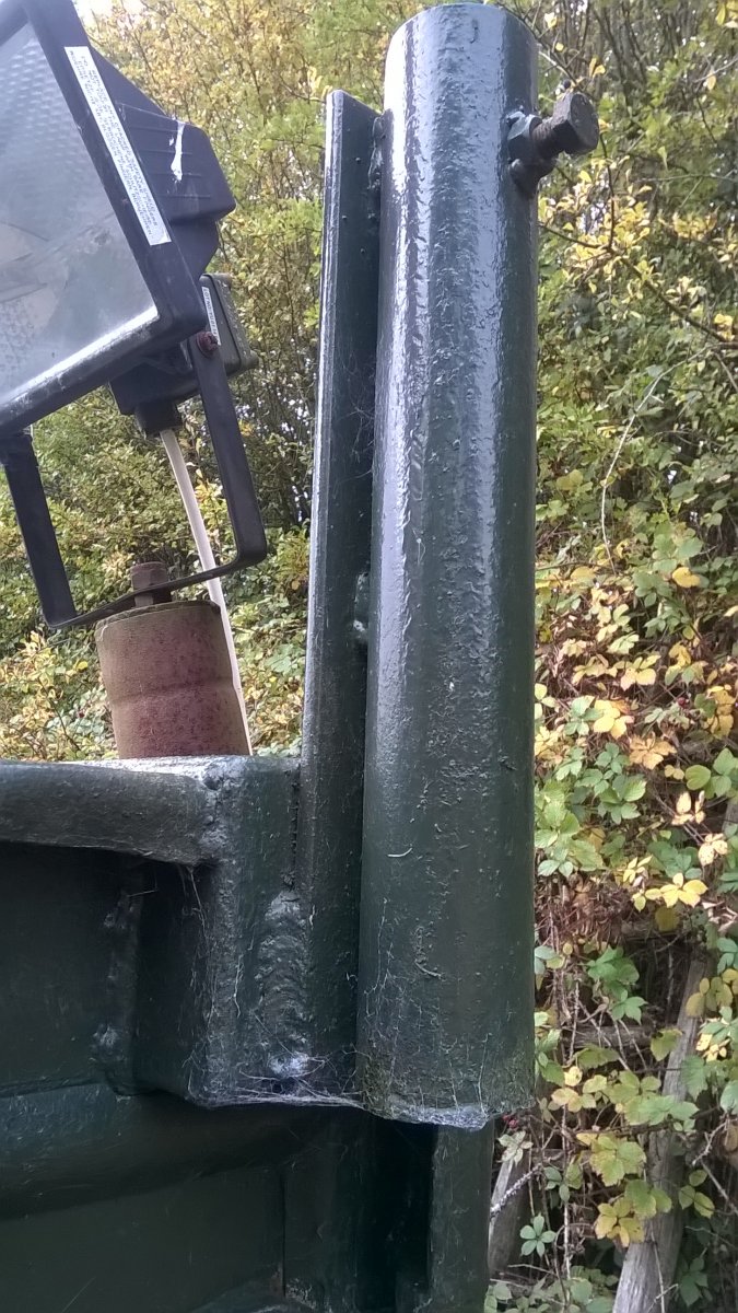

Anyway .... more box prep ... got a flood sat on top of a pole in this socket ....
covering a lift point .... so that had to come off today ... then ......

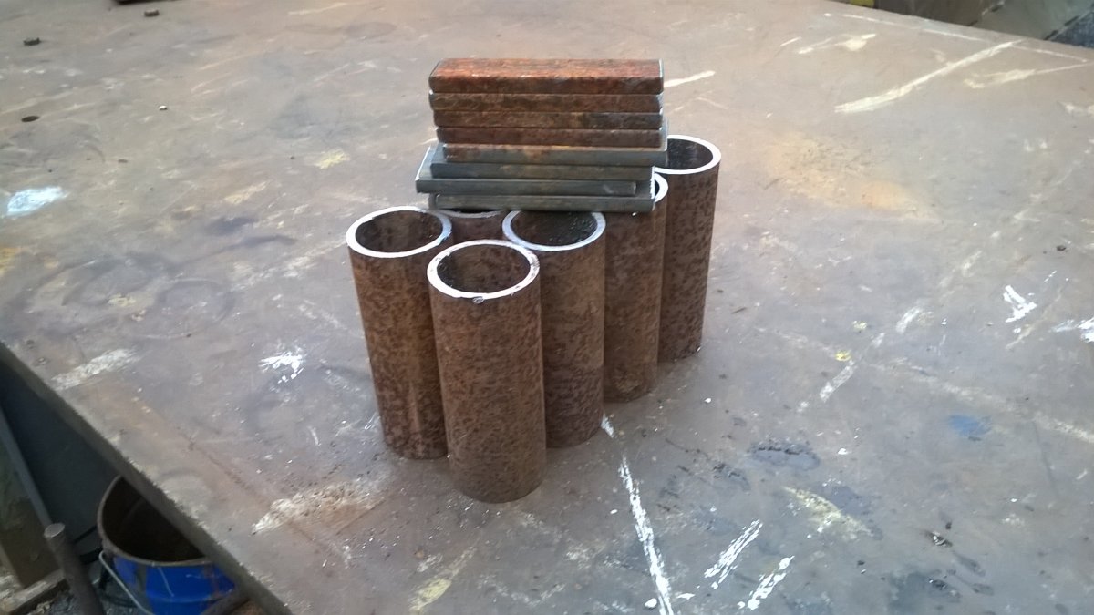

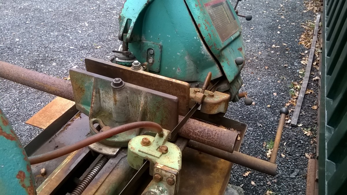

dragged a length of 60.3 CHS out
and chopped ....
these up ....
followed by a few more bits ...
ready to knock together tomorrow ...... any guesses? :unsure::)

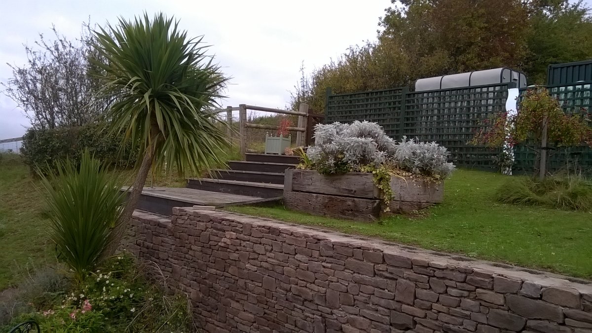

Are they natural stone? Quarried over here or imported. Looks nice. I wouldn't want to be cutting all them. Can't you just have them wider. Might look better than seeing cut edges. Make sure Reo uses sbr on them.
Now now Druid in one post your slagging builders using your ironwork for things it wasn't designed for and in the next post your adding a soil filled feeder to your timber gate! Expect the joiner to visit shortly to give you a bollocking and invalidate your warranty! Looks nice anyway!
'The joiner' put it on there Jim ;) .... that's the gate I rebuilt, beginning of lock down, back in March ...... it'll stick it .. the feeder isn't full ... half filled with polystyrene lumps, bit of soil and then compost .... plus it's supported both ends of the gate, vertically and laterally(y) .... she has got it looking nice though as you say:giggle:
natural Dylan, believe it's Indian :unsure: ... local stuff is treble the price and they're £55/M2 plus the Vodka :oops:o_O:( ..... looking at about 50M2 anyway :oops: .... with you on the cutting, with all the scutching, to bring an edge back.:cry::(

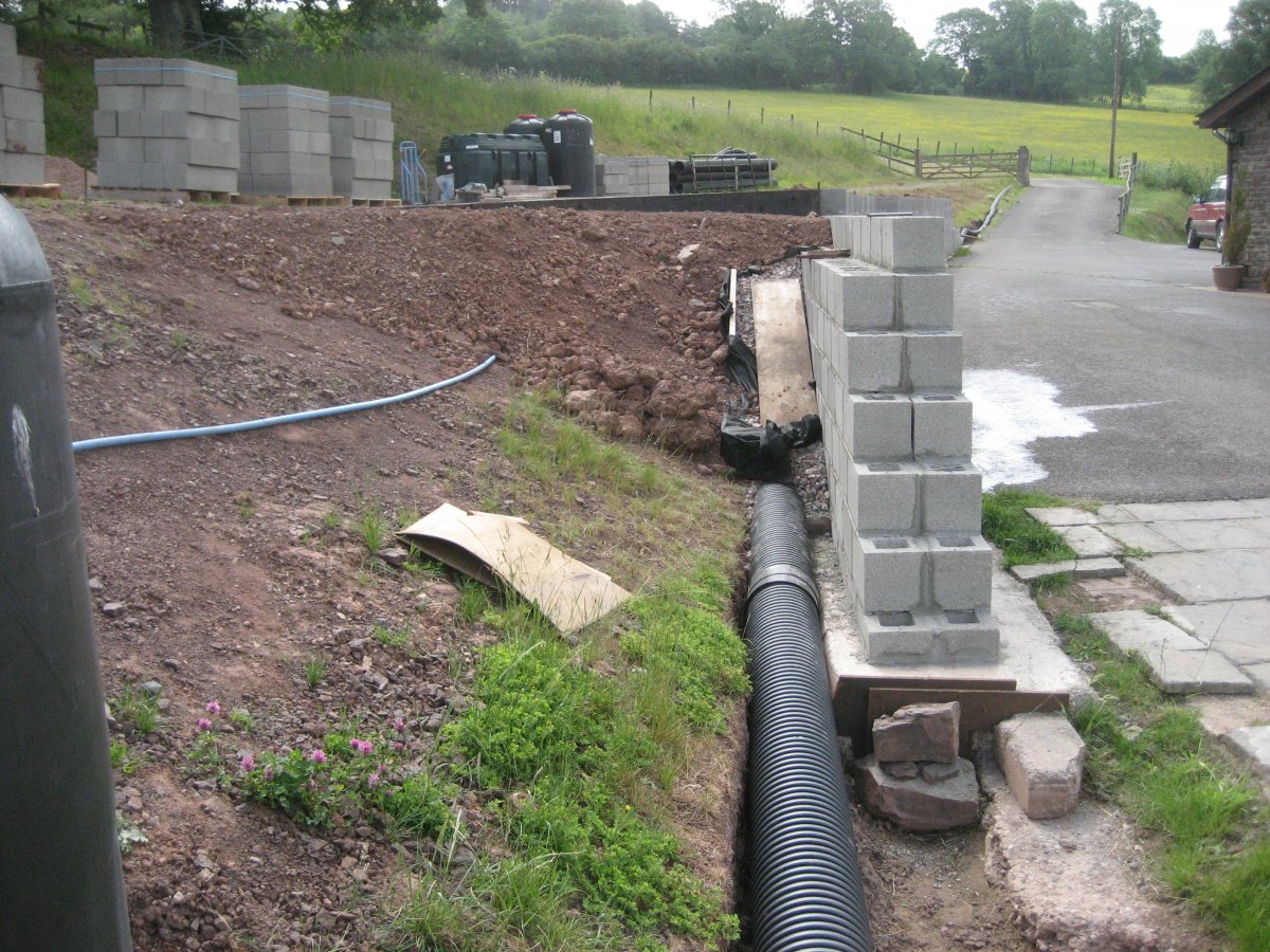

Have considered increasing the width by 3" inside at the back ... under the soil/stone fill, behind the block skin, is another 9" skin, one course down,
so could be uncovered and a 75mm block course laid to bring it up to top level .... lot of work, but do-able ... just concerned it might make it look overly massive. We're gonna have a chin wag with Reo and see what his thoughts are Monday, hopefully? :unsure::sneaky:

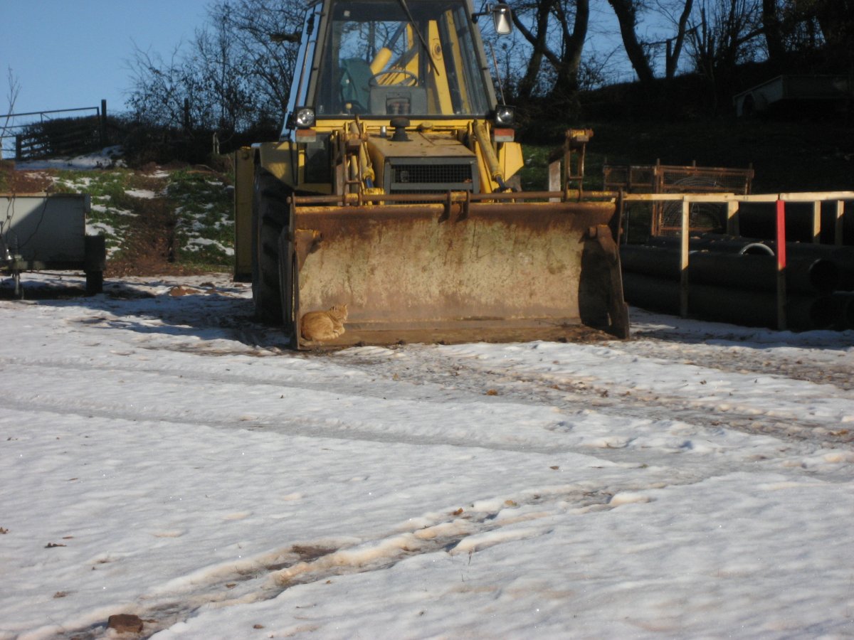

Looked out the window this morning and we had a 'stranger' sat on the decking ... hopefully not a 'harbinger of doom', but strangers usually turn up when we've lost one
looks very much like a ginger we christened 'Sausage' in 2010/11 .... after he liberated a neighbour's pack of sausages, through a kitchen window one afternoon.
he vanished in the snow that year .... he'd just started to settle and allow us to handle him ...
we had 3+ft of snow that year and 'Sausage' just disappeared ..... this un does have an uncanny resemblance though and was sat there like he'd been here before. Not bothered when I went out the door to take those pix:unsure::rolleyes:

What about 300mm wide flags
top of the wall is currently 450mm wide Dylan,9" of block skin and 9" of stone facing, expecting to put 500mm wide flags on top with a 25mm overhang drip edge either side

Sbr is a waterproof glue with a similar consistency to pva if you paint it on the back of the slabs (some people make it into a slurry with cement) it helps the flags stay stuck down as thin coping stones have a tendency to come loose
thanks guys ... will make sure it gets used ... how is it supplied? tubs/cans??
