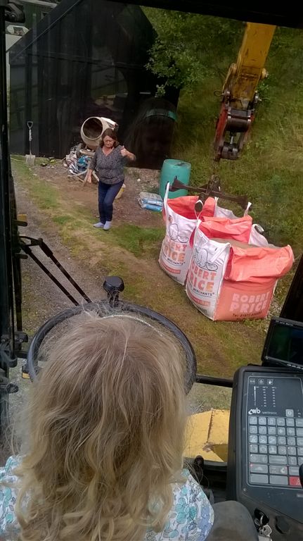

first time she's been in a 'live' machine ..... loved it ...... granny's real handy to hook the dumpies on the bag lifter, which makes life so easy for chucking 'em about ... and saves me a lot of climbing up and down ..... 'Drema's a long way in the air when you're in/out a several dozen times a day :rolleyes::unsure:

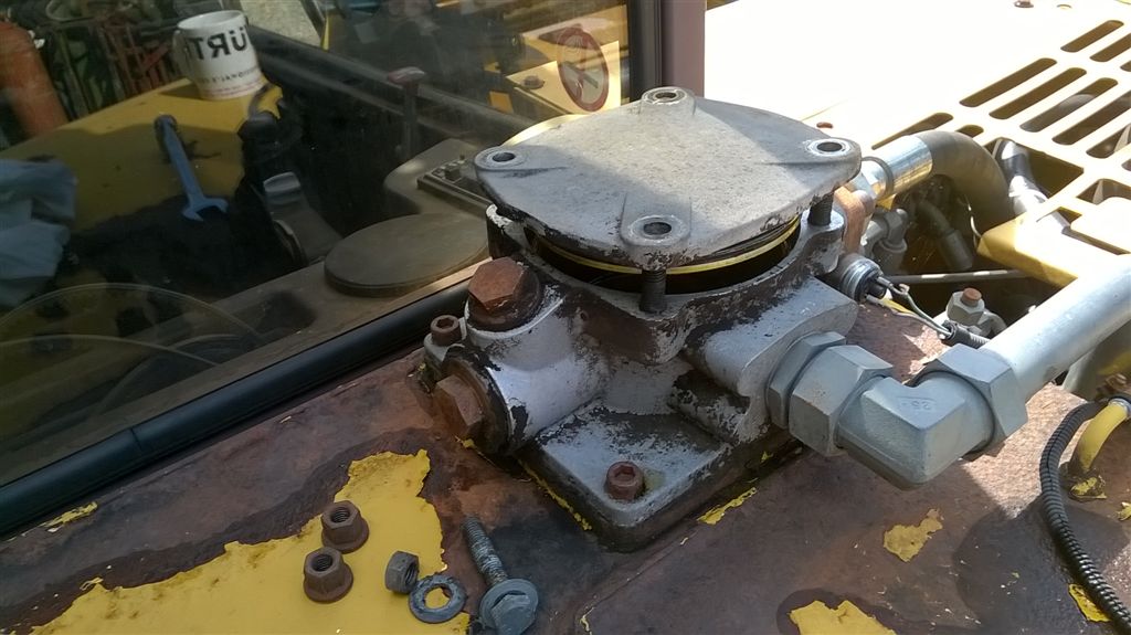

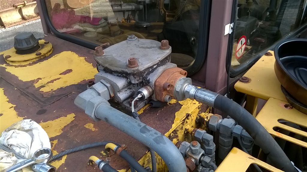

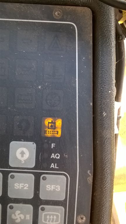

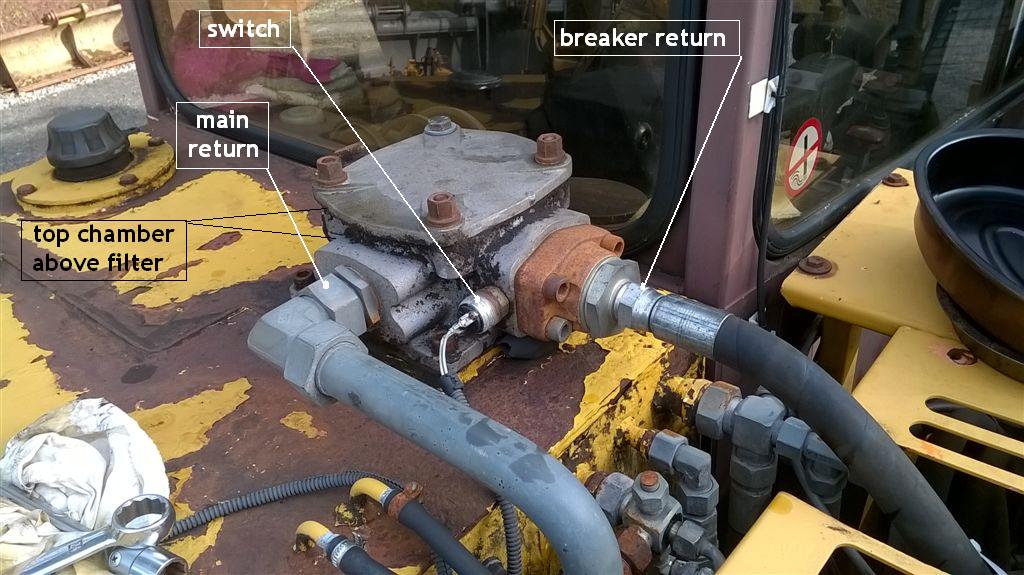

trundled back up the patch and got hold of that pallet of bricks to relocate them and'd just finished doing that when ....... "beep" ..... and this came on
never seen it before, so was all stop and go find the book to confirm my first thoughts of ... 'blocked return filter' .... no untoward noises and all seemed 'normal' ...
sure enough ... diagnosis/guess was spot on .
just enough time to get back up and whip this off, 'fore lunch got called .......
was a very cautious removal, expecting pressure, behind that lid, so it got quietly eased / slacked off, 'fore getting to this point and had to pry it up gently ... so nowt lurking in the way of the pressure, that I'd expect from a blocked return ....... Hmmm!

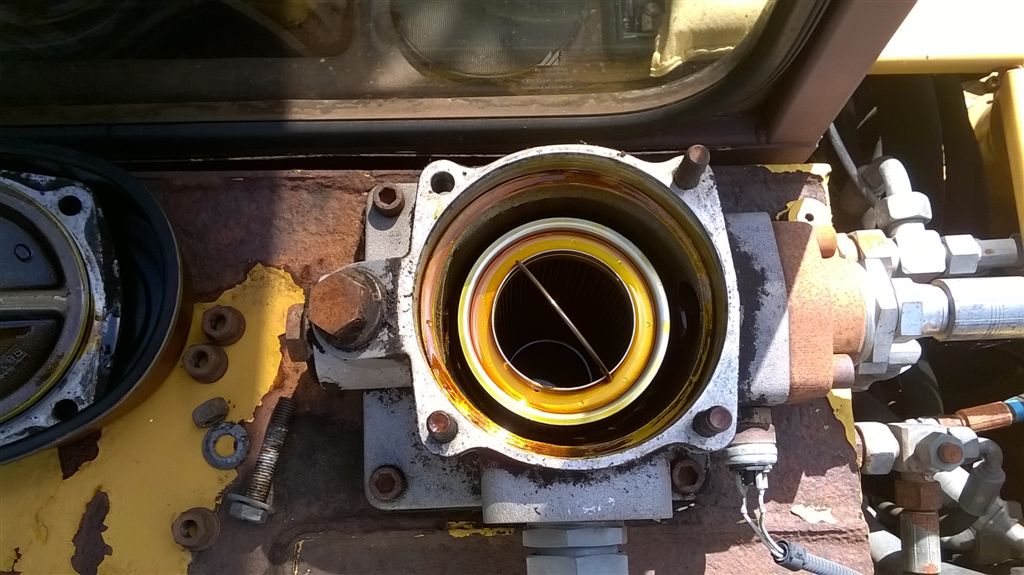

munchies scoffed and back up on her ...... accompanied by the new co-pilot ... "what you doing grand dad" she wasn't quite as clean after a few minutes up there with me ....... but then neither was I :giggle:

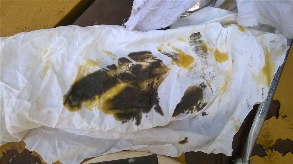

top off, complete with magnetic wand ..... hmmm! ... oil level in't filter matched the tank ... so tugged it out a bit and let it drain back into the tank
deffo no back pressure in the housing ..... wiped the wand off, but nothing spectacular in the sludge ...
but obviously metallic in origin ..... didn't feel like anything untoward ...... filter's been in there, circa 400 hrs and drained fine, running freely

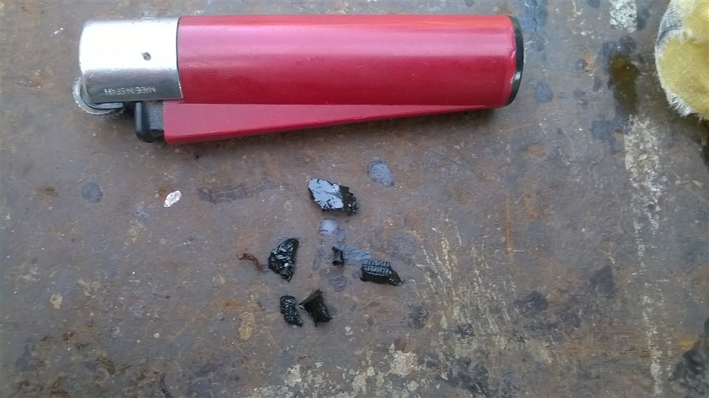

So ...... filter in a bucket on the bench and got a serious blowing out with the air line ....... with little effort ..... did find these rubber crumbs in the bottom ...
so doing its job (y)

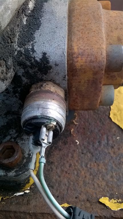

All cleaned off and dropped back into spot, I turned my attentions to the switch ......
giving some pretty peculiar readings with the meter TBH ..... varying from open circuit to closed and also going to earth from one pole, so I think we have the cause right there .... stuck it back in after showing it some air, and is now performing on/off tricks ...... new one required IMHDO ... that'll be expensive ... for sure !! :(:rolleyes:

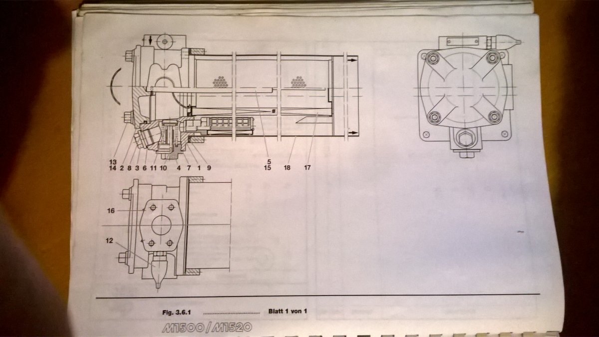

" Fig, 3.6.1. -- blat 1 von1 ... part no.12 001 528 .. Verschmutzungsanzeige " or to you and me "Clogging indicator" :rolleyes::giggle:
conversation to be had with Dave at Hydrema in Yorkshire tomorrow .. and we'll have a filter too ...... just in case ....... curiously there's no part no. for the by pass gauze unit ????? :unsure::confused::(

light is coming on/off intermittently ..... really can't see the filter being clogged at the hrs it's done and no horrible noises .... who knows??
new switch first and see if it still shows up ? ....oil is running back into the tank OK when you turn her off ?
anyone have any thoughts on the subject ..... oil is clean enough :rolleyes: :unsure:
that filter's well over 100 quid .... an expensive item for a max of 400hrs? :oops::unsure:

Maybe a cheap option first is to get a return filter gauge. Then you will see if it’s clogged or not via the gauge. If it’s fine then fit a new switch?
of course it depends on the cost of said switch......
Presuming the switch is there to sense back pressure could you remove switch but leave wires connected and put a blanking of plug in and operate for five mins to see if it still plays about

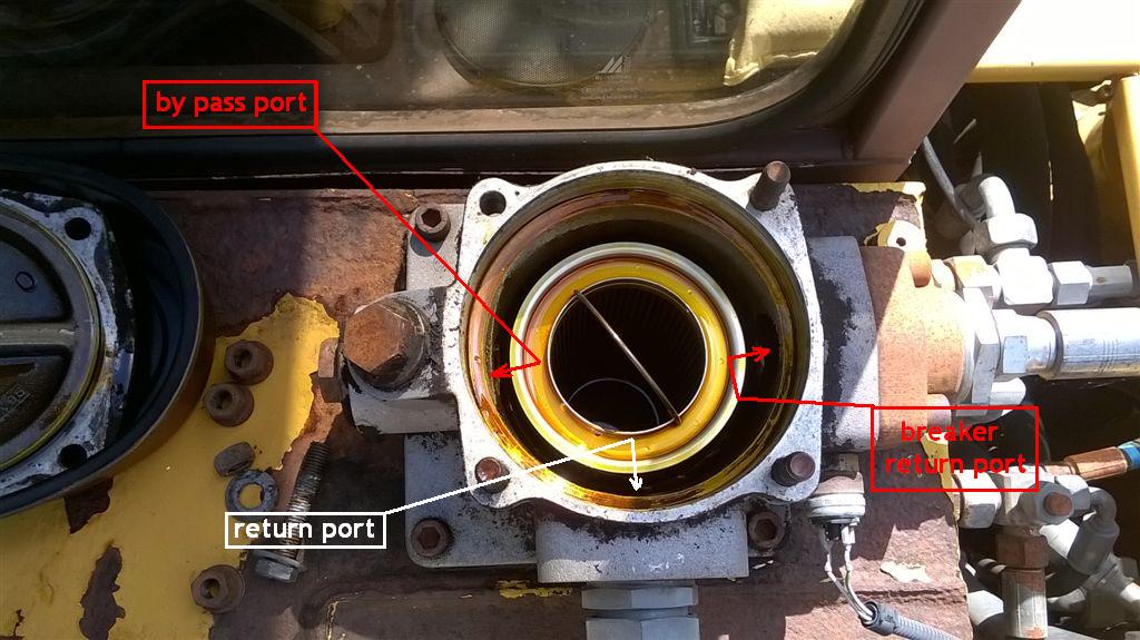

the breaker line goes in at the top of the filter housing. beside the steel return line James ... and it's a rubber, so'll hunt out a test tee, plumb it in and put a clock on it... got a 40 bar, 100 bar and 400 bar clocks so might start with the 100 and go to the 40 if i can get away with it, but'd be surprised to see a huge pressure .... any idea what to expect ... couple of bar max I'd have thought ............ when / if it stops pissing down .... just unloaded the second delivery and am now going to change ... 'kin drowned :mad:
some where I have a plug I made up a while ago, when the pressure switch on the travel valve let go, a couple of years ago ..... it'd certainly be a fair indication of the switch condition .. open to atmosphere .... might still 'clock' the return pressure though ... just to check ;)

No, fit the gauge in where the switch is 👍
not an easy one James:( .... tiny 10mm fitting ..... got now't like it to adapt a test tee to ..the breakers return line is in the same filter case casting, just at 90 degs from the return port and in the same upper chamber, with nothing to interfere with getting a pressure reading in the upper chamber above the filter ... both ports are direct into the top of the filter chamber, pushing oil through the filter .... and I've got a 3/4" BSP test tee I can mount a gauge up to in minutes ..... too 'kin wet ATM though :cry:🤬

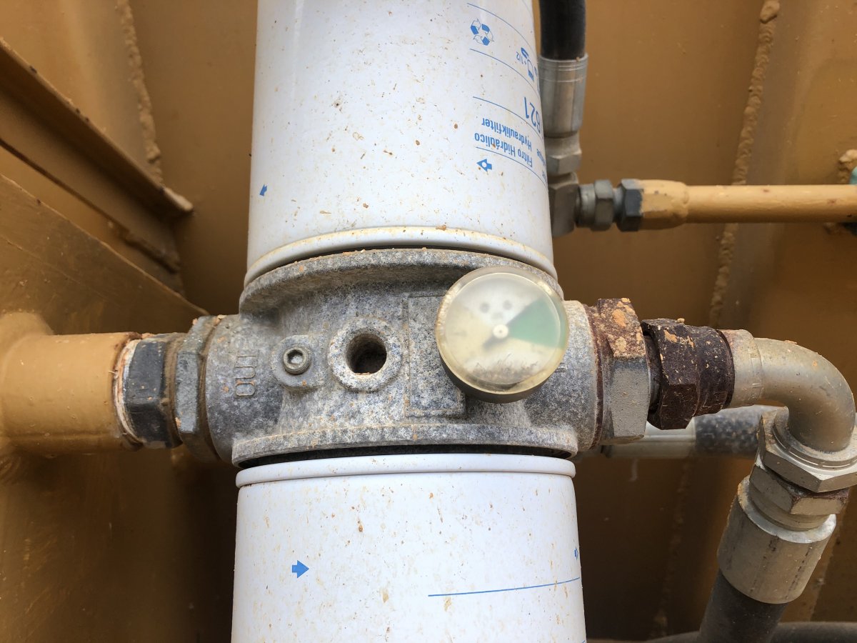

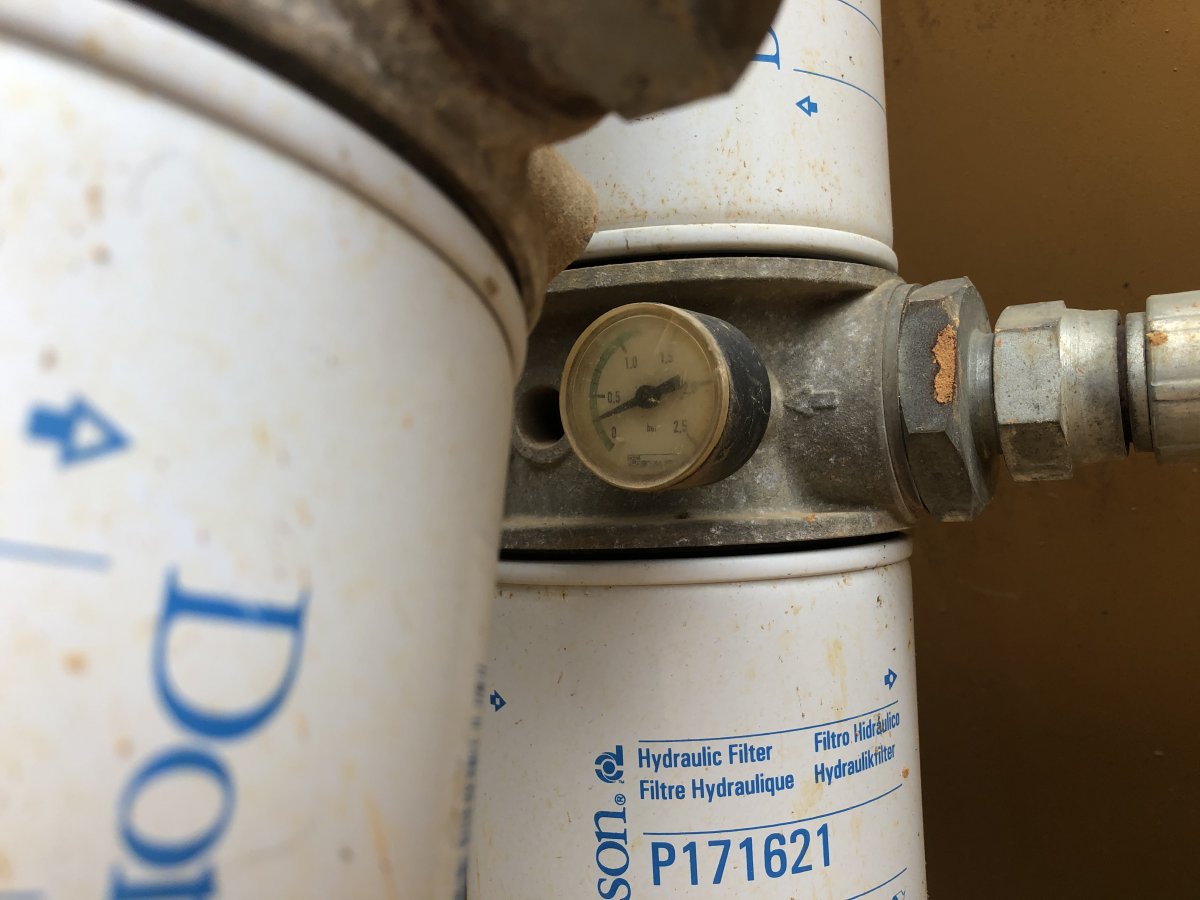

Can you not do it like this?

It’s no good using normal gauges, there will only be a few psi of back pressure.
unless it is blocked
my return is built into the top of the tank James
filter is lifted about 3" in this pic
looking at your gauge pic ... seems up to 1.25 bar is an acceptable back pressure ? one of those gauges seems a reasonable diagnostic and'd probably fit the switch port ...... see if I can find one, some where

There will be a bypass valve so it will never build that much back pressure. The gauge and your switch should let you know that the filter is blocked probably before it is enough pressure to open the bypass.
I would hope so James ..... can't recall if I said that the light is still on with the switch removed from its port ... I'm going with a switch fault .... ;)

Could be wiring gremlin also. Can you not test switch by either joining wires together or not?
with the wires disconnected the light is off Gaz ... the one pole is showing to earth and it's showing closed circuit across each pole on a meter .. oddly t'other pole doesn't show to earth so guessing there may be a diode in play in it somewhere ? .. I've emailed the guys in Hydrema, Ripon for a price for it, a filter and a couple of ram seal sets .... I shall be sitting down when I open the reply :LOL:
with the wires disconnected the light is off Gaz ... the one pole is showing to earth and it's showing closed circuit across each pole on a meter .. I've emailed the guys in Hydrema, Ripon for a price for it, a filter and a couple of ram seal sets .... I shall be sitting down when I open the reply :LOL:
Won't be a unique switch but sometimes it's nigh on impossible to find one that matches. I bet it could be surprising what they want for it!
no it won't ..... 'least not in a good way ... last one was 132 quid including freight ... plus the Vodka & Tonic :oops: .... hence the multiple parts inquiry ... shipping ain't cheap from Denmark .... get it all in one box .. leg seal kit was 100 quid, plus15 quid for the jiffy bag and VAT on top of all of it .... great tool but spares're not cheap
