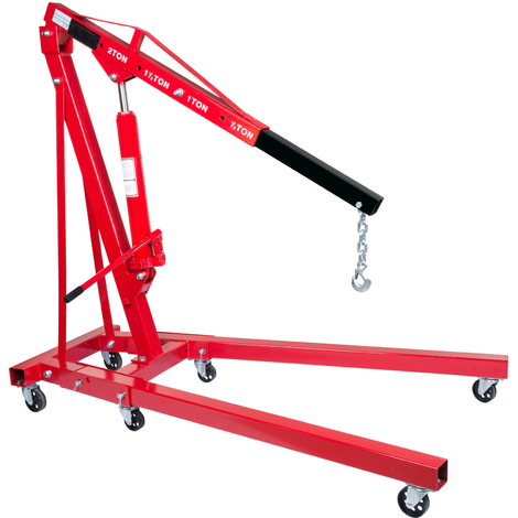

one here for 140 quid :oops:
https://www.manomano.co.uk/workshop...MIxerM5-rg4AIV1ITVCh1eqQBwEAQYAyABEgIrvvD_BwE
no way you'd make it for that and must be certified :unsure:
Makes me laugh when you see all these youtube 'projects' of shitty replicas of what you can pick up for peanuta brand new from China.
If you can weld good enough to be sure of a crane you build not failing, then your time is more valuable than the savings made by building something like that yourself.
absobloodylutely Guys (y) ...... what is the point :rolleyes: ..... and'll always be worth pretty much what you pay for it;) ... 'less you bend it of course.... but then hey, it's warrantied :cool::LOL::LOL:

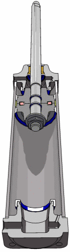

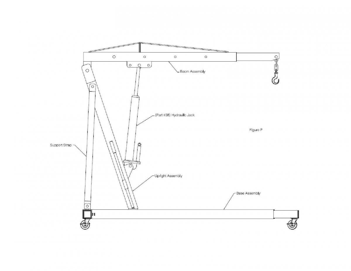

thanks for the precious suggestions, a friend of mine told me to pay attention to the hydraulic cranes the hydraulic pistons if not of good quality and worn could lower the piston and consequently the boom boom with the weight and load hanging, the What could be dangerous, the piston rod should be chromed and not ground or turned as an external surface. right observation I think, you agree

the rod makes little difference really as it's not double acting :rolleyes: ..... there should be no oil above the piston ;)

I always thought the reservoir was above! If it’s not where does the oil come from?
it is all to be assessed on the quality of the materials used, if they use pressed cardboard seals and the piston rod instead of being chromed is turned is adjusted could leak the oil causing pressure loss and causing the arm to drop suddenly with the hanging load, depends on the quality of the materials used and the degree of precision in realizing them during mechanical processing and assembly, it is necessary to consult the tables for basic shaft basic bore of mechanical turners, am I wrong?

the hydraulic integrity is between the piston seal and the bore .... the rod has no contact with the oil in a jack and there're no gland seals to leak at the top of the cylinder, as it's not double acting ;) .... so no seals to be damaged by a non-chromed rod :rolleyes: (y)
I think that in the cap where the piston rod runs there are bushings of the gaskets and dust caps, I happened to disassemble a hydraulic piston I do not remember now, I changed gasket package to make up for pressure loss, if I'm wrong I invite you to correct me and so much that no repairs in the yard thanks, I'm sorry if you get bored with my puerile questions, thanks for your teachings and your life experiences, I treasure it gladly thanks again
might have a dust seal and a bush in the top of the cylinder, but no hydraulic seals, as there should never be oil in that side of the piston ... if there is, the piston seals are bollo-ed ;)
