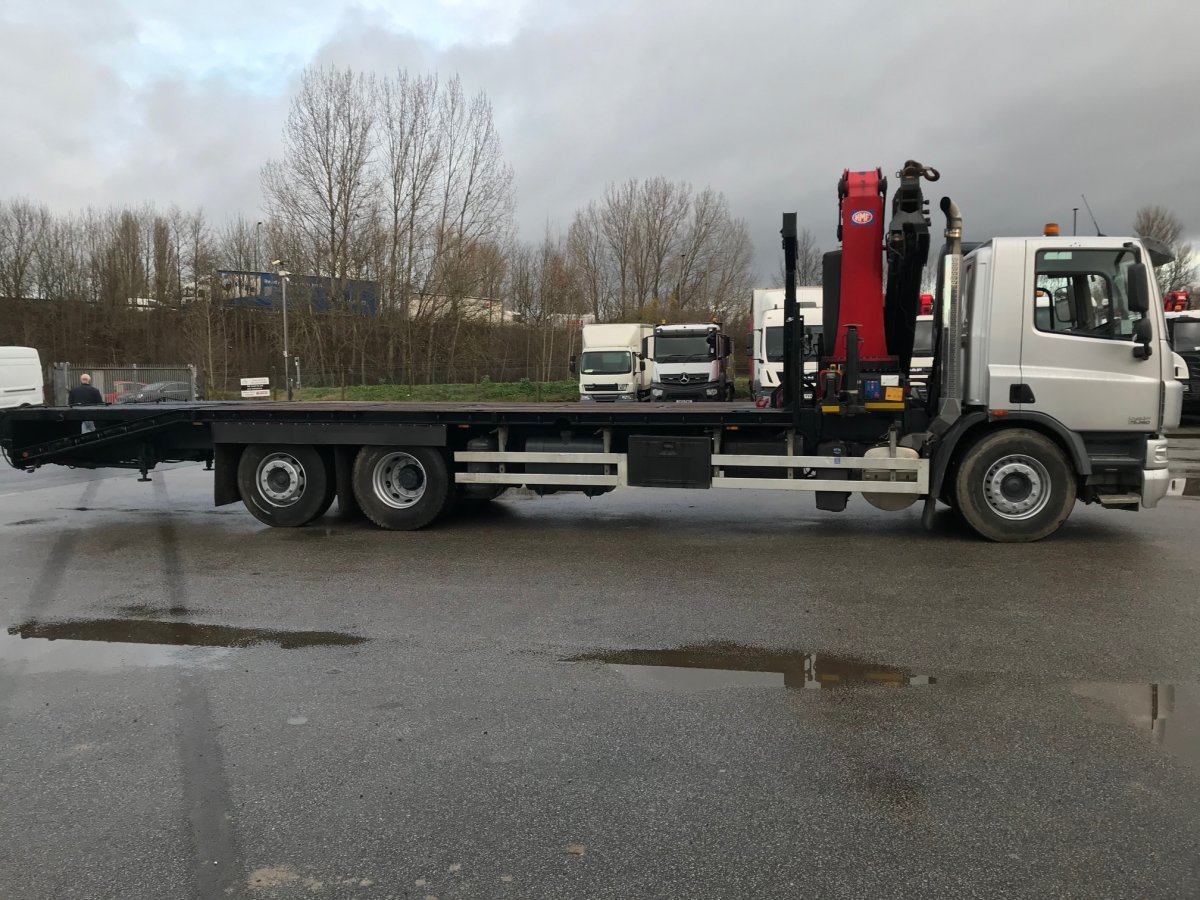

Up the M1 over the A66 Up the M6,M74 into the A9 and back across the A95. If you see me give me a wave 👋

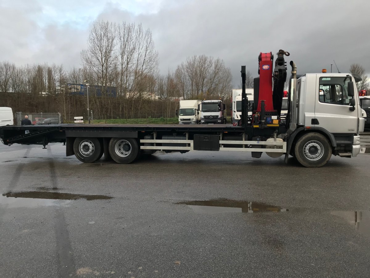

I'll be driving we're new truck up the road 🚛
Quattromike
Quattromike
Well member-known
looks a tidy rig mate what size crane is it? I suppose it has a 7.5 tonne front axle with the super singles on
HMF 3220, 4 extensions. 9ton front axle, 11.5 ton drive and 7.5 tag.
9 tonne that’s a proper set up then
I think them HMF cranes are very underrated just look at the slew ring😳 well over engineered for a 32 tonne meter crane what make of remote has it?
sorry for all the questions but there is something about lorry loaders that get me excited 👍
Well, you know what, we looked long and hard trying to get the truck that did what we wanted had the right bits for the job and didn’t cost the earth and wasn’t old as f*#k but I have no idea what the remote is. I think it’s just an hmf remote with the EVS system. I’m getting a crash course on it tomorrow.
