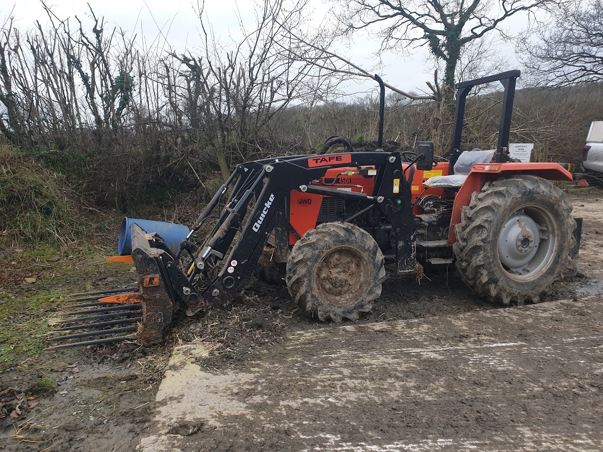

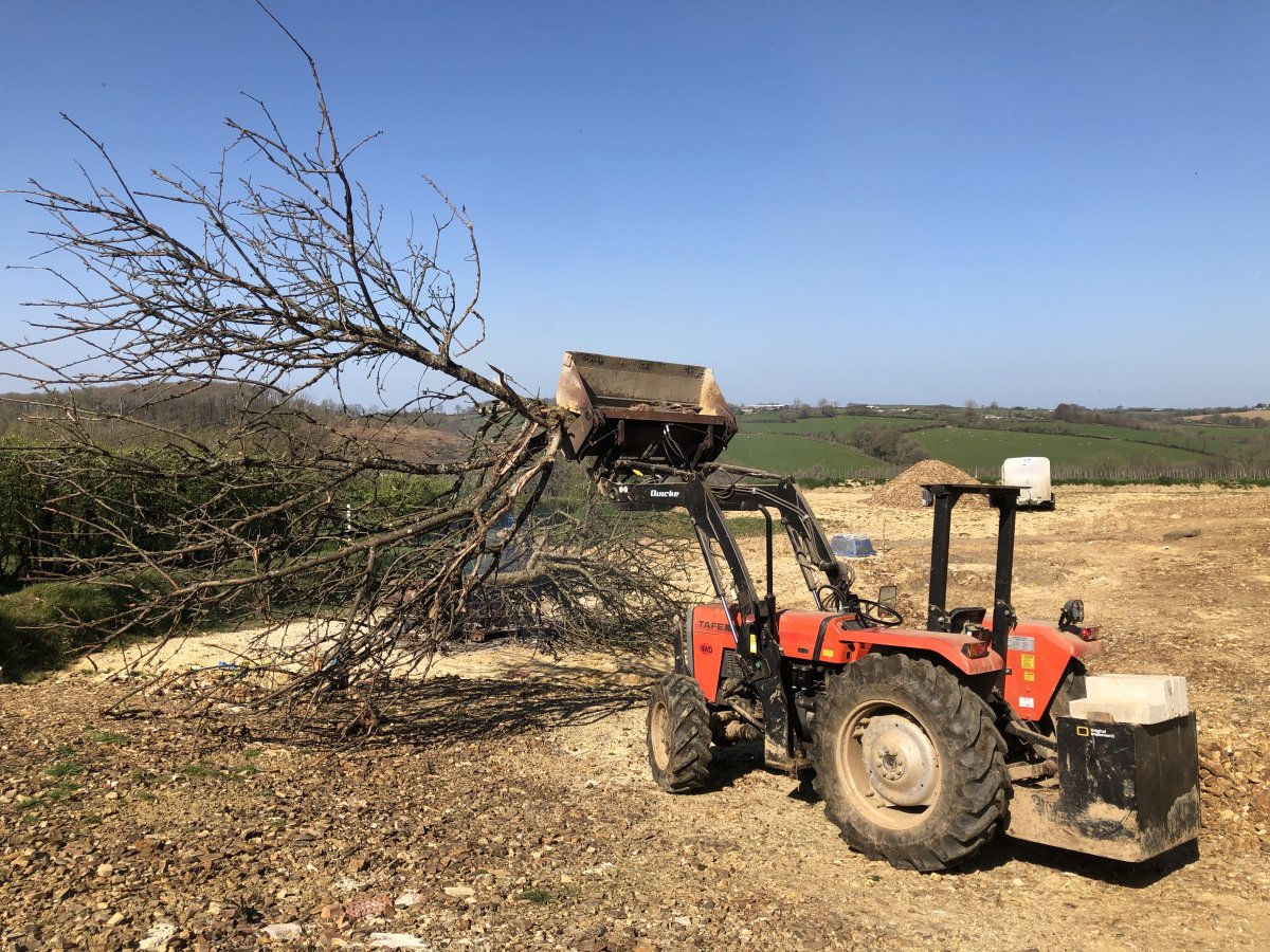

Looking to upgrade the trailer for the Tafe 45di. I’m thinking to get a dropside tipper trailer to suit the tractor better. Trouble with the dumper trailer is it doesn’t put any/much weight on the tractor due the design of it and the long drawbar.
Tractor doesn’t have a braking system, so looking to size the trailer to suit the tractor. 4WD/45hp and weights about 2500kg or so plus whatever is on the front of the loader.

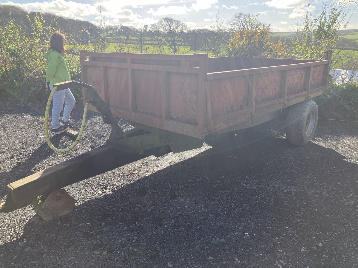

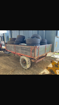

I’ve got a vintage Pettit 3 ton trailer sat in my shed that a neighbour is storing that I’ve been offered for £750+vat.

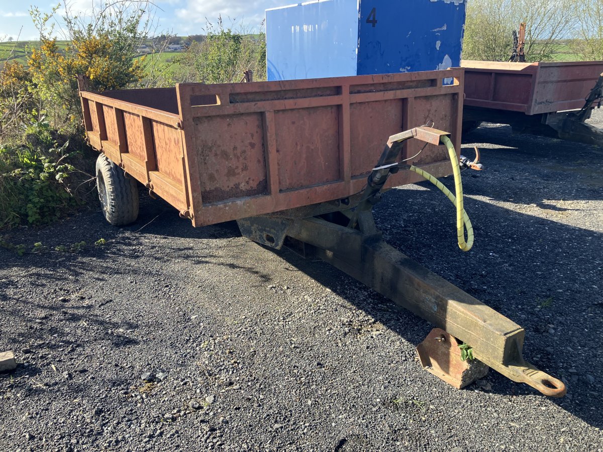

BIL has offered me his smaller dump trailer which is steel dropside and much more robust. 10ft x 6 ft ish Will take 5000kg of stone and has a tailgate that will hinge top or bottom. He built it and to be fair it’s very solid. Wider axle (6.6ft) than the little Pettit trailer. He wants nearly £2000+vat for it. Also it needs a jack as no pick up hitch on tractor 🙄

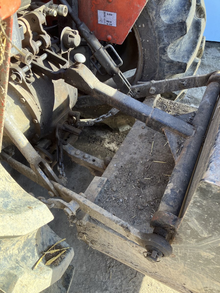

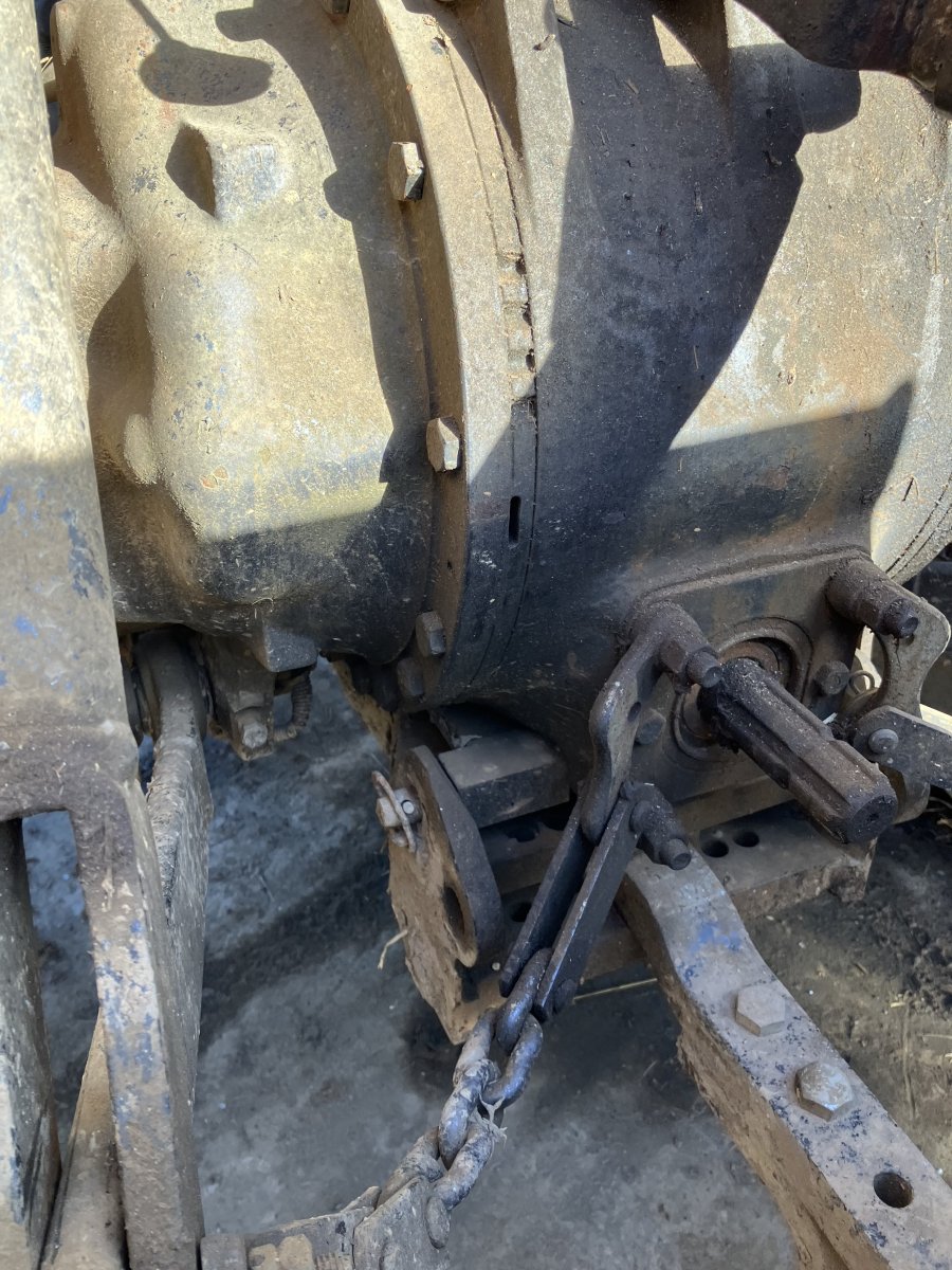

If your on a clevis drawbar, it could get interesting, wheelie wise a PUH would be a lot better. Tafe`s are Massey based, I would think it wouldn't be too hard to find something and make it fit.
I need to investigate the PUH. Tafe do an option for it but It’s a bit complicated because the tractor has a large rear weight on a quick fit frame that’s on the link arms and top hitch. We have a new local TAFE dealer so I might have a word with him.
Ballast the rear wheels, wheel wights and or fill with water, and do away with the 3 point weight?
Rear weight about 900kg I think . Not going to be straightforward replacing that with wheel weights and nice to lose the weight for topping works in moist fields if you drop the loader off and the rear weight it almost floats:)
Rear weight is easy to drop on and off but the frame that holds it may get in way of PUH.

A pickup hitch off a 200 series MF should plonk straight on. Possibly likewise off a MF65/35..... I may have some of it, take a photo of the gearbox underside.

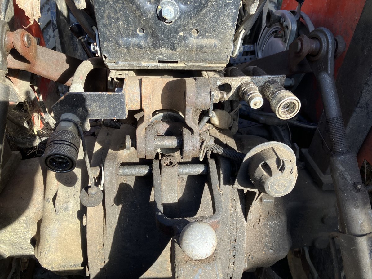

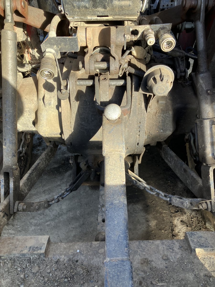

What are the 3 hyd connections, one double acting and free flow return?
the one on the left is the tipping spool, as factory. The pair on the right are ones I added. There is a pair of 3/8” hoses running upto the loader spool and I can plug these in to provide a 2-way connection to back end (needed for my dumper trailer as that needs power up and down). Also plan on using it for a hydraulic top link for my leveller, and when I find a nice PTO powered brush / bucket with hydraulic tip. Not much flow rate though so can’t power anything meaty with them.
The tractor has a hydraulic diverter under the seat to send flow either to the loader or the back end, so a little bit of faffage required at times .
Sounds like I need to add another one (diverter) to make the spreader brakes work as well as spreader lid

When I was a lad, I pulled one of those Pettit 3 tonners for miles behind a Dexta, on the pick up hitch. No weights on the tractor, no hydraulic brakes, never once had a jack knifing episode, and the 3 ton bit was very conservative. Soil you could get more like 4 and a half. A modern tractor with modern brakes would piss a Pettit, barring operator error, if you want a no-frills, blacksmith repairable trailer, that is.
