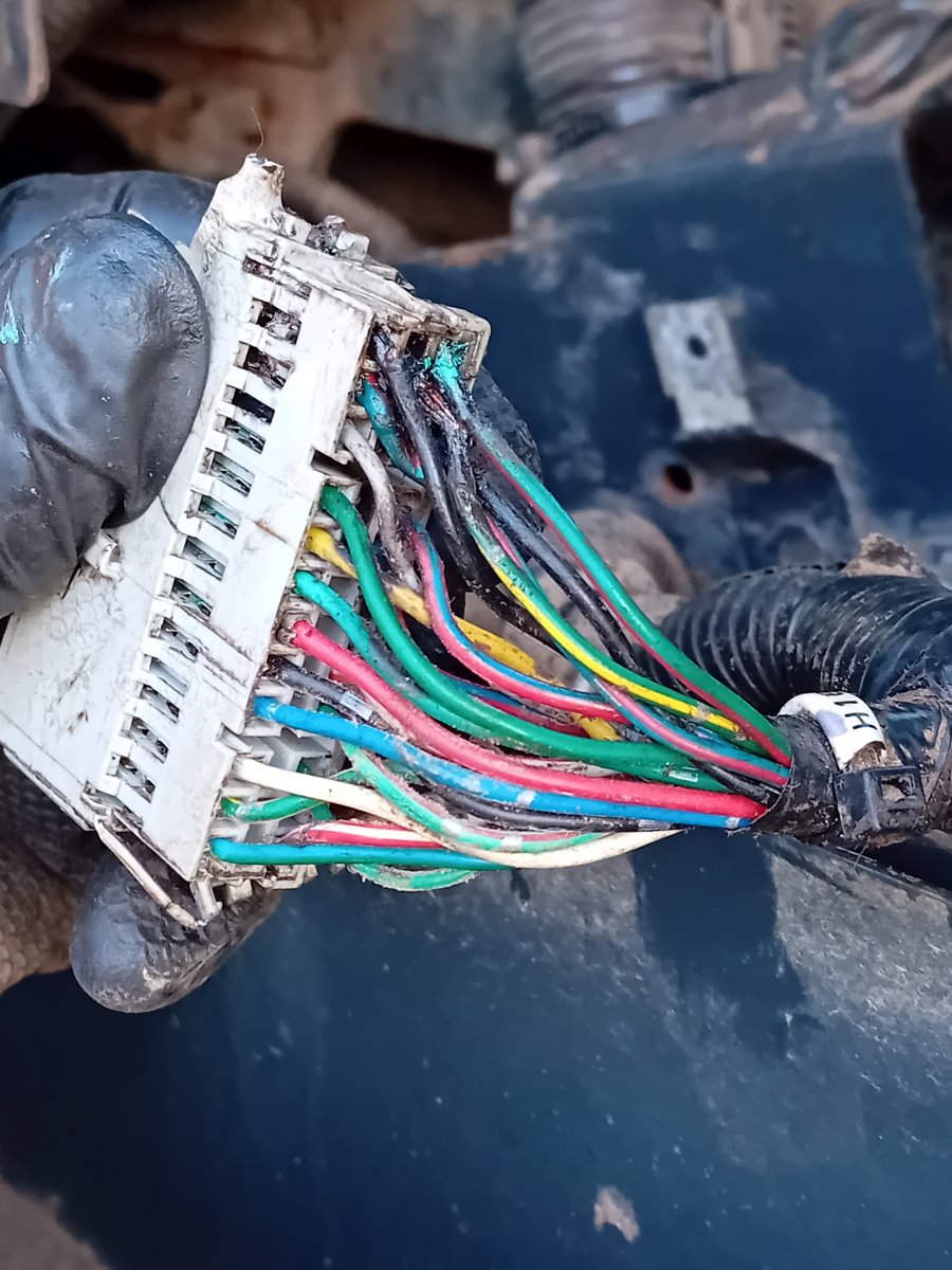

Finally think I've found the source of all the problems thanks for all the suggestions, seriously corroded connector behind the seat under the heating duct

well this repair didnt fix the problem,had m b k down harness f***ed pump controller cables and plug melted,broken slew restrictor wires all connectors green with water ingress . i paid 38k for machine done 400hrs and been on stop for 5 months,got quote from m b k to replace harness as requested by supplier £27500.00 no guarantee to fix problem ,absolutely fxxkin fuming
huge sympathy with your plight Martyn, but it's the 'aftermarket' installs that've let you down badly here ... Think I'd be going down the unfit for purpose route and looking to the dealers to sort the entire issue ... very VERY annoying
