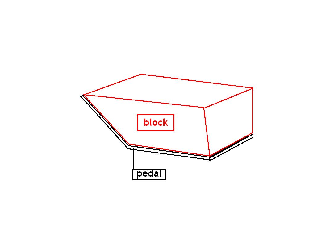

thanks for all your replies to this just a bit of update on my situation a joiner pal said pot blocks on pedals um! so i said go ahead he has made two so they are in same level as cab floor flat its worked smashing as i dont have to bend my feet up now im in heaven now the simple things eh!

neat idea ……. so basically your feet are flat on top of the blocks, instead of an ankle breaking toes up at 45 deg.s :cool:(y)

yes thats it he made me like two wood wedges i bolted them through the pedals as mine are one piece not the fold-up ones, i just lifted seat a little to compensate sorry im not very tech savvy to take a picture on hear , but it has made things so much easier

summat like this ?
had to go back to steam power to sketch that :rolleyes::unsure:..... tried on't new 'puter and ............. gave up after ten minutes faffing in paint :mad:

thats spot on . dont know why i didnt think of it myself me dad used to do it years ago on some tractors and other vehicles when he could not reach the go-go pedal but he was a right short arse . ps my mate shaped it well even saw him with sandpaper
