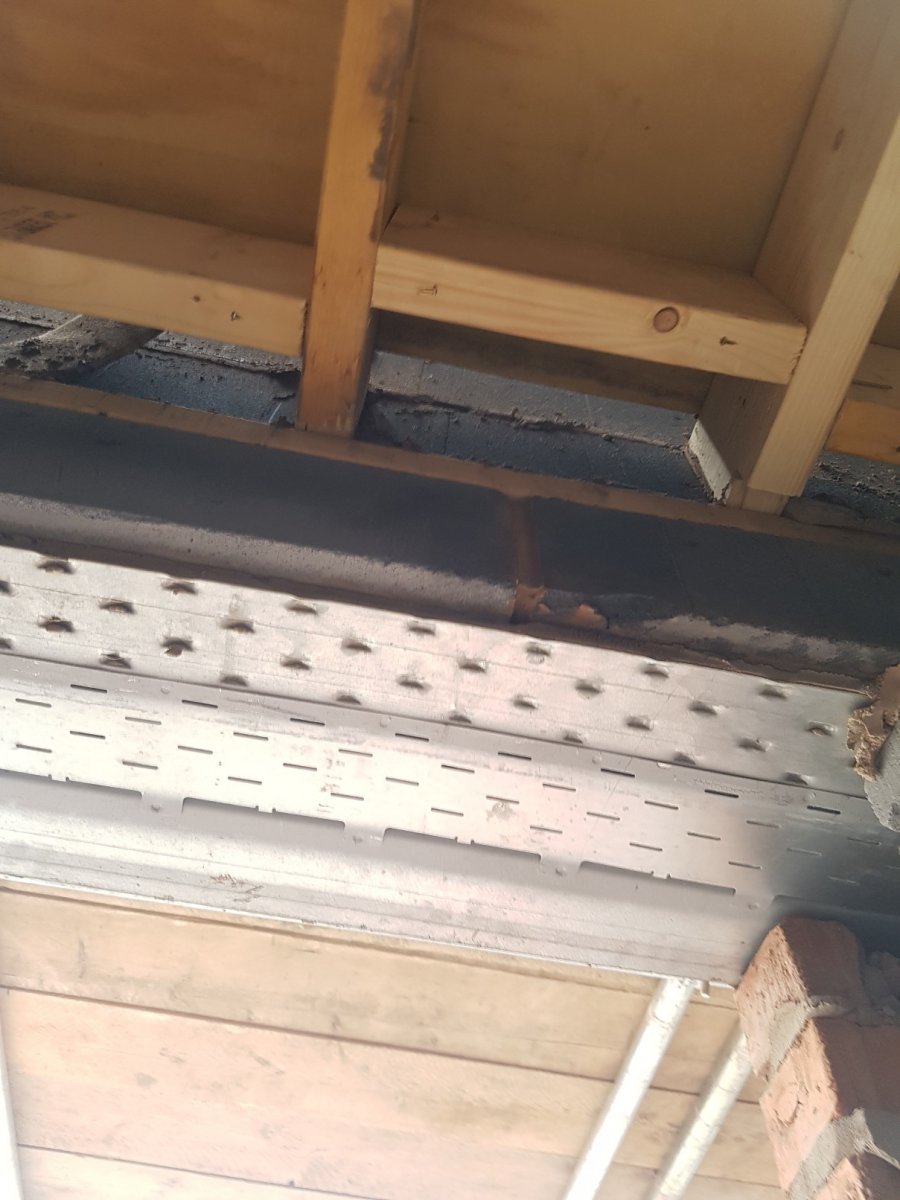

It's definitely unrealistic timescales. That's what knackers this game. I've worked on some student digs this year my god was it a joke. Think i've got some photos on my phone. Don't know the BCO but they weren't getting paid for much. First floor joists on a wall plate with the rest of the whole buildings blockwork (3storeys) built off that, just because they were 2" different to where the old floor was. Client pushes for ridiculous timescale, contractor agrees then its just madness and rough arse ness. I'm building a newun now people ask me when it will be done I say spring/summer. I'm not going to fantasise about some specific day then rush like mad to get it done

Worse than I remembered 1" low so stick a 2" wall plate on and notch an inch out the joists. This is a respected regional outfit too
OMFn'G :oops::oops::oops::eek:
