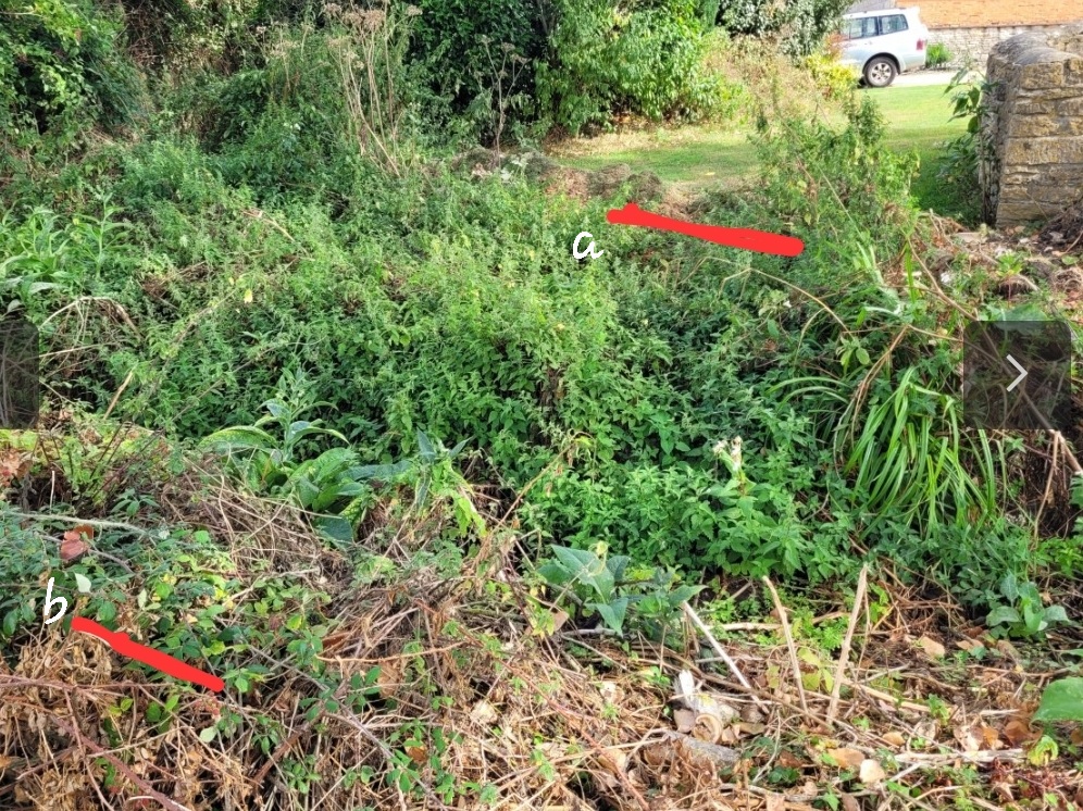

I d reckon go for twin wall there and form the headwall and outfall out of concrete. Bed the rest in stone type 1.
Be handy if we knew how wide the gap was to bridge and what construction the brooke is to begin with. Fair few gutters crossed on farms round here with concrete panels, its handy there are 3 panel manufacturers within 25 mile of here.

It appears as though its equivalent to an irrigation ditch, soil is heavy clay so would be surprised if its lined with anything, hard to tell with all the vegitation and neglect. There is a short section near the bridge where the sides have been build up out of stone and channel bed is stone.
Point a to point b (where the bridge is required) is approximately 8-10 meters The banks would need some building up to form a proper chanel and reduce the gradient of the slope leading on to the bridge I would think so the span would ultimately be more like 3-4 meters.

At that kind of span its too wide for panels and its either a proper bridge construction job or pipe it. The thing you need to know is what sort of flow there is in bad weather, no good restricting flow with a pipe.

If you make sure you use a pipe where the top of the pipe exceeds the height of water at maximum water flow then it won't be a problem. This is assuming that any pipe used will have less internal friction than the mud based ditch and the pipe will have the same fall as the rest of the ditch essential using the culvert pipe as an arched bridge rather than a pipe.
I think I'll need to watch how much flow there is this winter, it does pick up quite a bit after heavy rainfall.

A client of mine wants to build a bridge over a small brooke. It will provide vehicular access to a field and will need to support the weigh of a tractor. The brooke floods in winter. I think the cheapest and easiest way would be to use large a large diameter pipe and somehow encase in concrete. Anyone have any experience with this and can suggest a design/material choice?

Cleaned out large stream layed geo grid mesh down bank, under water then up other side put large dia pipe in then sand bagged the sides filled with clean 40mm up to top of pipe then anothe layer of geo mesh grid more clean stone and sand bags till at height then another layer of geo grid mesh followed by teram layer and type 1 then tarmac to put a road across while bridge deck was renewed for higher weight limit
If permanent you can put dry concrete in bags and moisture will cure it making sides hard

Making a change to a watercourse is proper hairy in the litigious age we live in, I'd be wondering about creating a concrete bottomed ford or possibly piping the drainage ditch and putting concrete cover over but below the general ground level (restrictions free weir) .Maintenance or lack of always seems to be a problem with culverts when upstream property gets flooding 🤔
