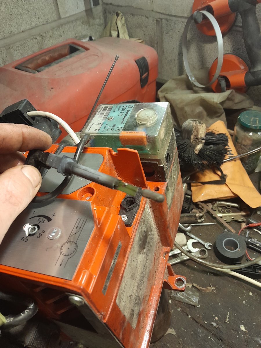

1 of my rentals boiler not working. Get there at 2.30 boiler won't take any water but says empty on the readout. Spoke to a mate as my usual plumber didn't answer. Mate phoned back about 18.00 , I'll meet you there. Leave the house steering felt wrong pulled over a screw in the tyre
my boy brought Compressor up managed to get air in to get back to the house. Swapped vehicles got down there mate had it opened up cleaned a sensor full of crud re pressurised the expansion vessel and way to go
Tenants were over the moon as knew Christmas was looming and mate never charged me. Hopefully get the tyre done in the morning
