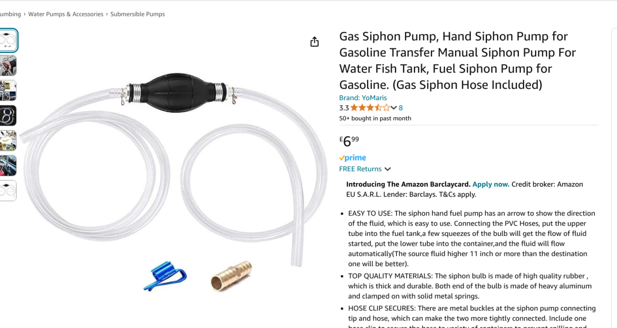

i have one of these type of things as i have a customer who runs out of oil and airlocks the feed pipe

airline and blow it back thru to tank ?
