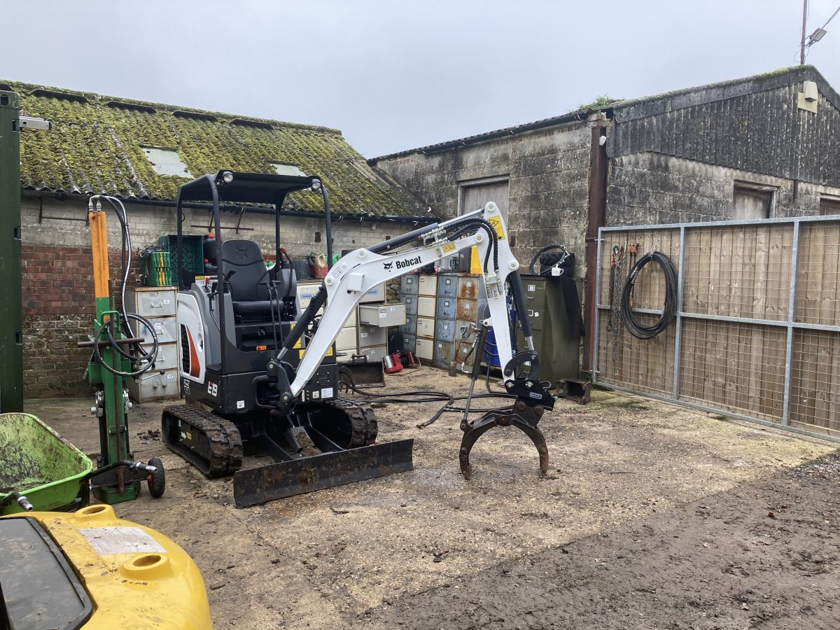

Bobcat E19
I don't know if it's just the picture or being a canopy machine but it looks seriously wide and squat in comparison to some 1.9 machines looks like it will be stable
They are just over 1400 wide if I remember correctly with the tracks out. I find them very stable

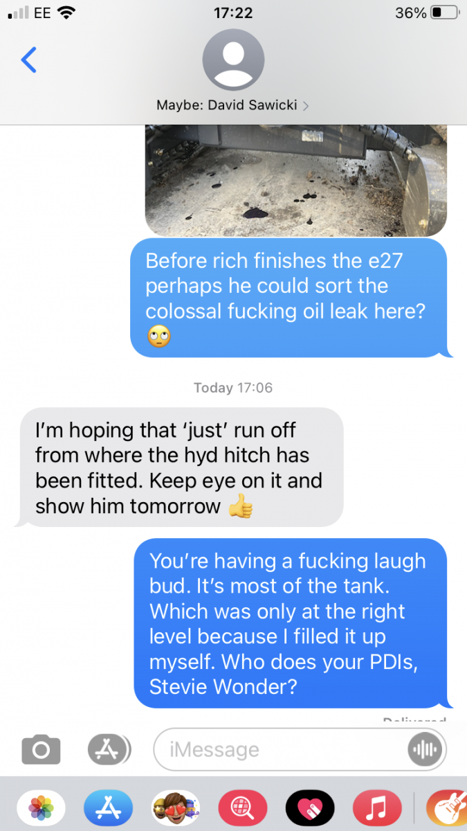

So it's finally arrived. And done 5.6 hours work before parking it up with a massive oil leak from somewhere in the valve chest. :rolleyes: That alone wouldn't be so bad, you could call it teething issues, but the mechanic still has the E27 in bits to replace a valve section that was stopping the blade holding proper pressure. At least he's back first thing Monday I suppose.
Not had much of a play on it (obviously) but so far the good:
I specced the comfort pack (better seat and rollers for aux and offset) and let me tell you- I am proper comfortable. It's bloody massive- definately a 2t class machine rather than 1.5t. Acres of floor space, a big storage cupboard under the seat, bottle holder, other cubby holes and tons of space behind the seat. The tracking leavers are easily removable and the pedals fold up- superb design as on the E27.
It handles the Tigergrip with the rotator much better than I thought it would. Quite comfortable with it so long as you're sensible. I've fitted my grapple to it for versatility as a lot of the time a heavy rotating grab would be too much.
The grading is really, really good. I specced short arm. Grading was my main concern as the E27 isn't the best despite a mod, wheras the Hyundai the E19 replaced was an absolute peach. But this thing is brilliant. Really nice to use, and cleans up fairly well against the blade (long blade specced)
The twin aux setup works well, and you can select from three flow settings on the main aux.
The blade extensions seem strong and well built.
I've not had much chance to test digging power. It ripped a small stump out far easier than I thought it would come, but that could have been ground conditions too. Seemed to struggle a bit with a 600 in mudstone but that can be hard going as you try to get the initial scrape in and thinking about it, it was lifting the front end up easy enough.

trick of the light, it was virgin hydraulic oil. Loose hose connection, all sorted. Taking it to a small job tomorrow.
