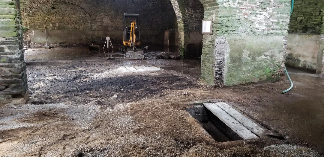

Also water runs in all along back wall of building and across existing slab (building it is very deep compared to behind it and has a stream that runs along back wall at approx 3m higher than our internal floor level)so we are running a drain right along back wall and leaving it gravelled to surface to catch water before it goes on slab.
Client doesnt want channels.

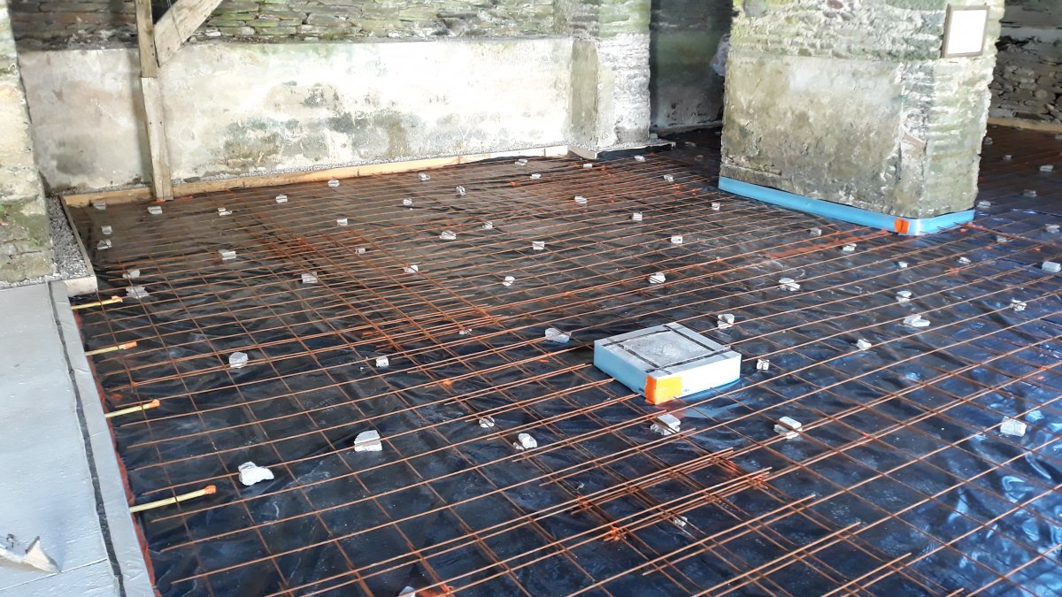

It looks like this slab might have to be poured in individual rooms, either end room then the center room to work our way out - which gives us things to consider for the joints.

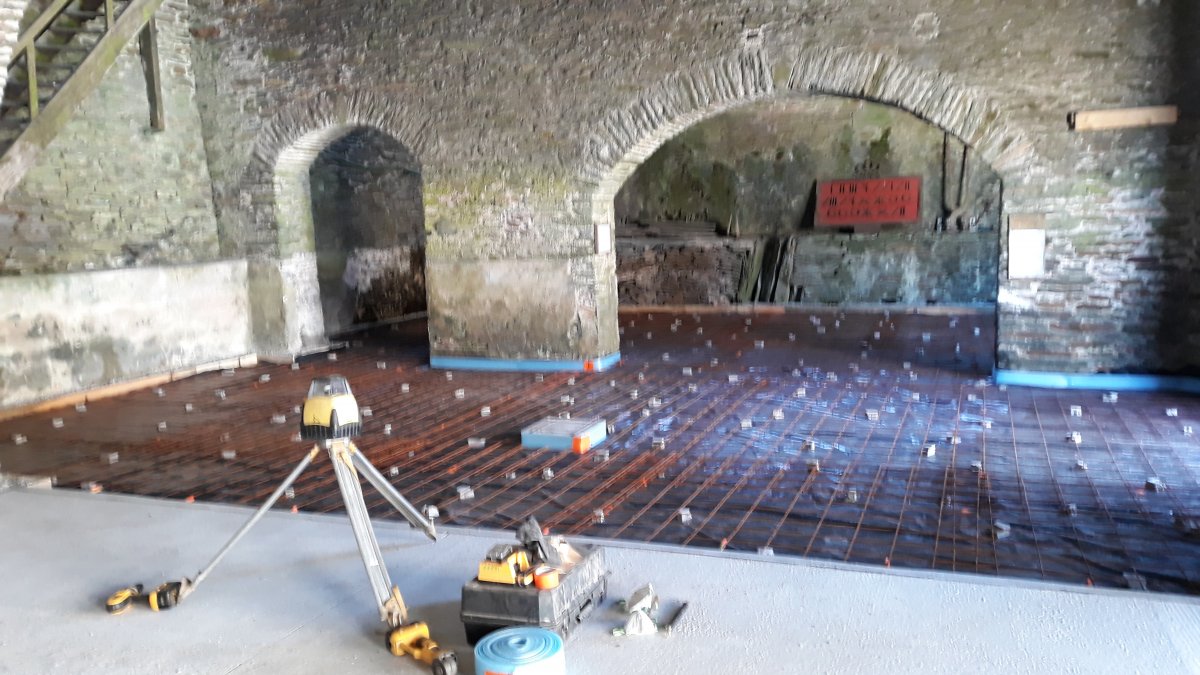

Without wanting to over complicate it, I was considering drilling dowels through the wooden shuttering and tying it to the mesh and not treating it as an expansion joint - the whole area is is covered and damp and wont be subject to extreme temp swings from direct sunlight etc - or can we sleeve the dowel at the one side with DPM ?
Whats people thoughts ?
personally I’d deffo mesh/dowel it straight through, I think your expansion will be minimal given the constant temperatures down there, contraction cuts in the door ways and it would be sound.. in my unprofessional opinion.

If it's to.be done in sections I'd shutter it with k-form then you can dowel through them with sleeves on one side timber shuttering with dowels through it is always a nightmare to strip and usually involves smashing it out
Its prepped up with wooden shuttering and dowels .... like you say we envisage a bit of a chew on to get it off :rolleyes: - cant get hold of K-form.

try putting the sleeves on the dowels, with a bit of release oil inside the sleeve, then when the concrete is set, draw the dowel out, remove the timber and then insert the dowels. Just make sure the sleeve is against the shuttering or just into it, so you dont concrete the bars in. Have done this many times when its going to be awkward to remove shuttering.

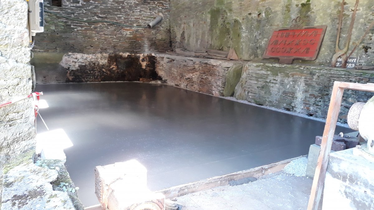

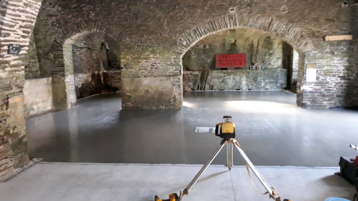

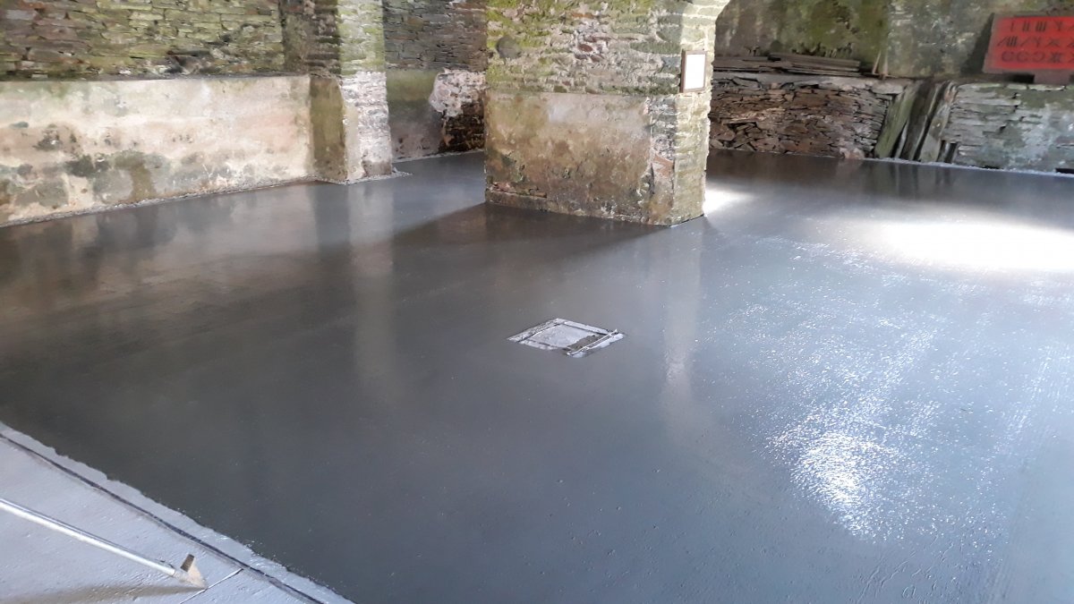

Finished the second pour today - the spec was a light tamp finish so we got a satisfactory result, the only bit I wasnt happy with was we had a long wait for the last wagon which left us a bit of an job to blend the two pours together,but I kind of expected it so made sure the join was in a dark out of the way area despite between told a couple of times there would be no delay :mad:

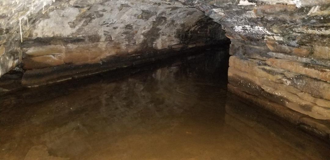

Lots of hidden work, we put a drain right round the outside walls as there is a stream runs above head height on the outside of back wall and this ran down internal walls and across old slab at a fair rate so our drain cut this off and we run this to an underground culvert (see photo)
Wooden form work came off the dowels o.k with some cuts with stone saw and we sleeved the second pour side.
Interesting job and a bit of a challenge for us as we dont do a lot of concrete work but I took it on because we do lots of work for the same estate and he wanted us to do it.
Anyhow thanks for the advice from everyone and it showed that there seems to be lots of different ways to do joint/form work etc etc o_O
Photos attached - photos show first pour done b4 weekend and todays pour.
Cuts to be put in it soon as I can get on it.
EDIT: Added the culvert pic I forgot - this runs underground to a lake - its quite silted up but used to be able to walk through it to the lake;
Nice tidy job that 👍🏼

Just to put the thread to bed

EDIT: Added the culvert pic I forgot - this runs underground to a lake - its quite silted up but used to be able to walk through it to the lake;View attachment 14997

beautiful job Boyo ... and amazing place to be working .... that culvert is some drain :love::oops:
