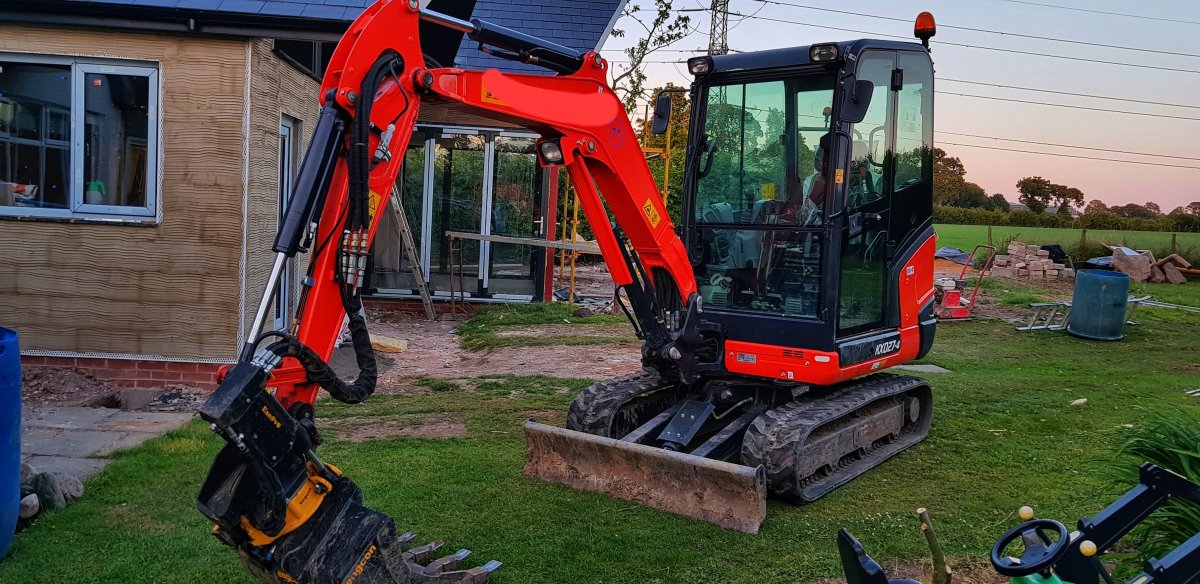

This one...mate of mine likes his tiltys.Pedal on hammer circuit.. correct. What machines that size have it on the sticks?

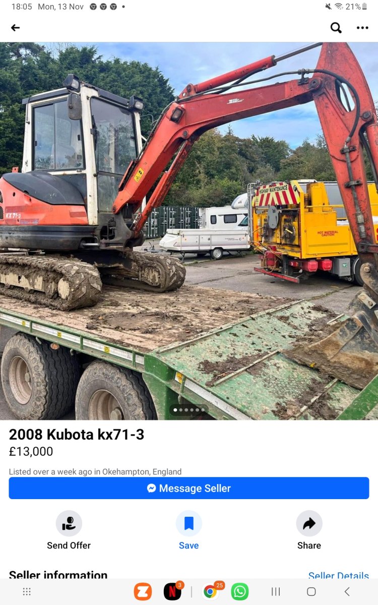

This one with 7000 hours definitely a bit hopefull on price then (Local)Still not much to go wrong to be fair. And remember things perish with age as much as use.

Think this will be high on my purchase list once extension is builtThis one...mate of mine likes his tiltys.
Bucket was a tad ott
But had rollers etc on the sticks.
Lovely little machine
