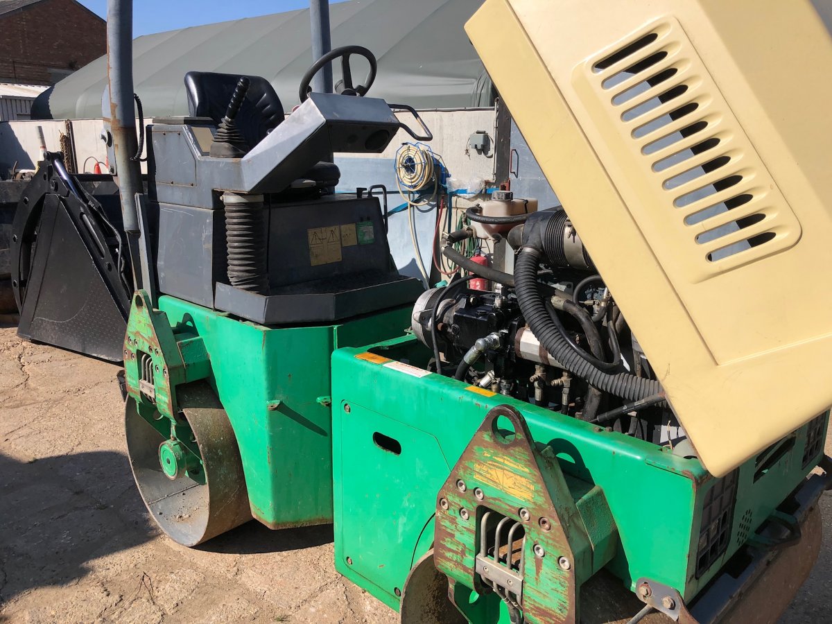

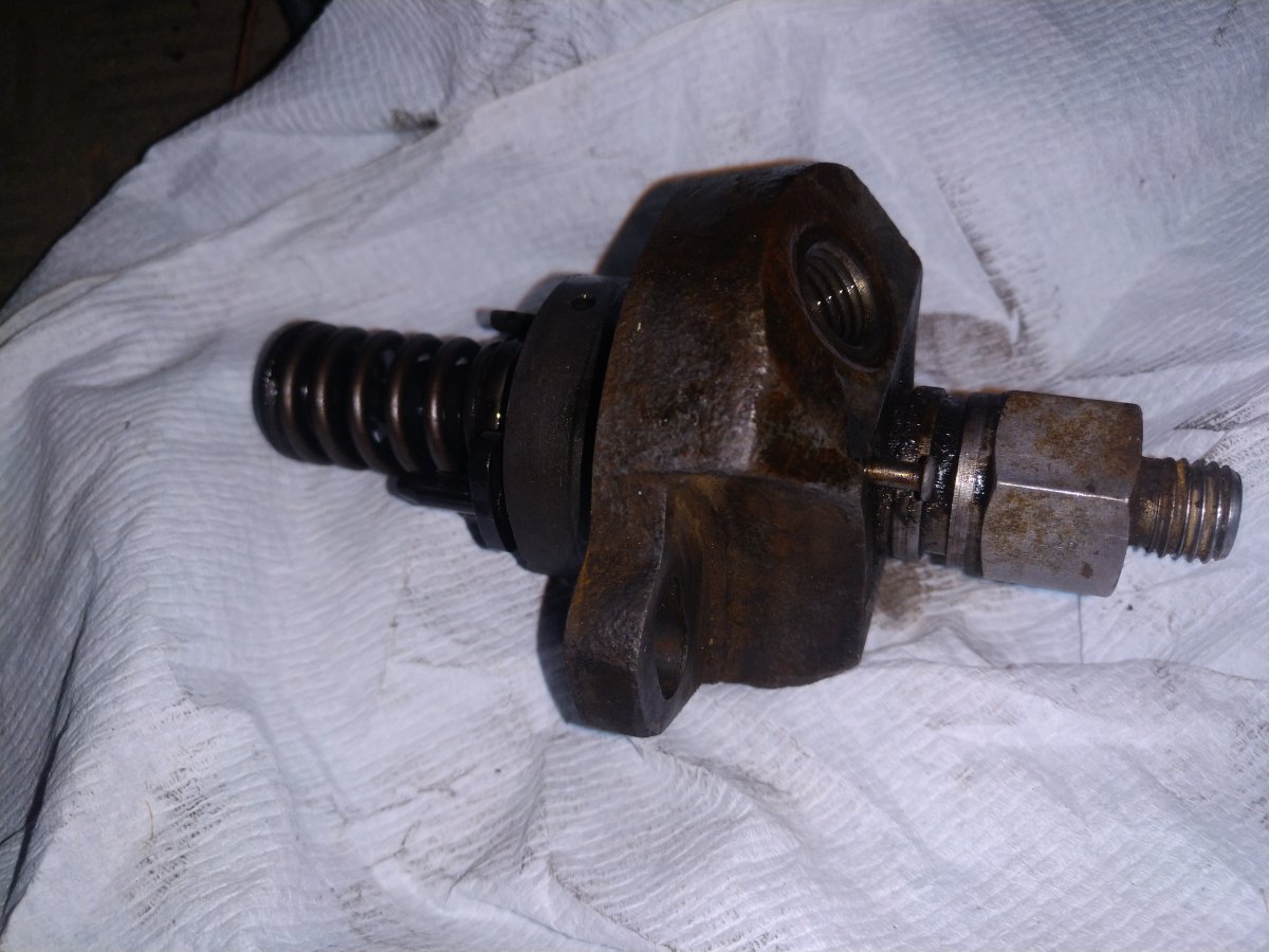

Just to button this one up. Pump came out several weeks ago. Tank off, clean out, new filter etc.
I sent the pump away for an overhaul.
They confirmed the suspicions that the bearings had collapsed in the swash plate, you nailed it @CPS 👍
Anyhow, it returned the other day, after parting with a large sum of hard earned money 🙄😔, bitter pill to swallow but it’s no bloody good to anyone busted, chalk it down to experience and it’s just one of those things.
And I got her up and running again this morning 👍

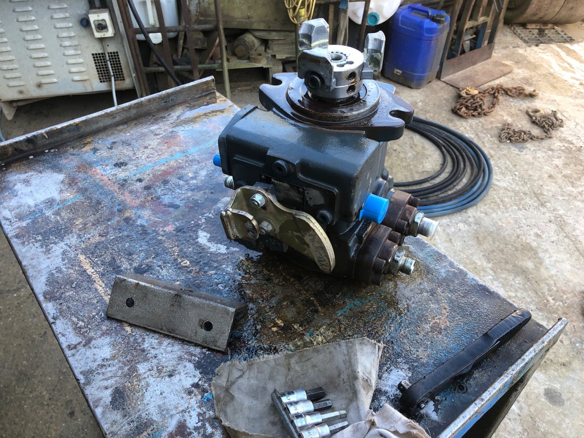

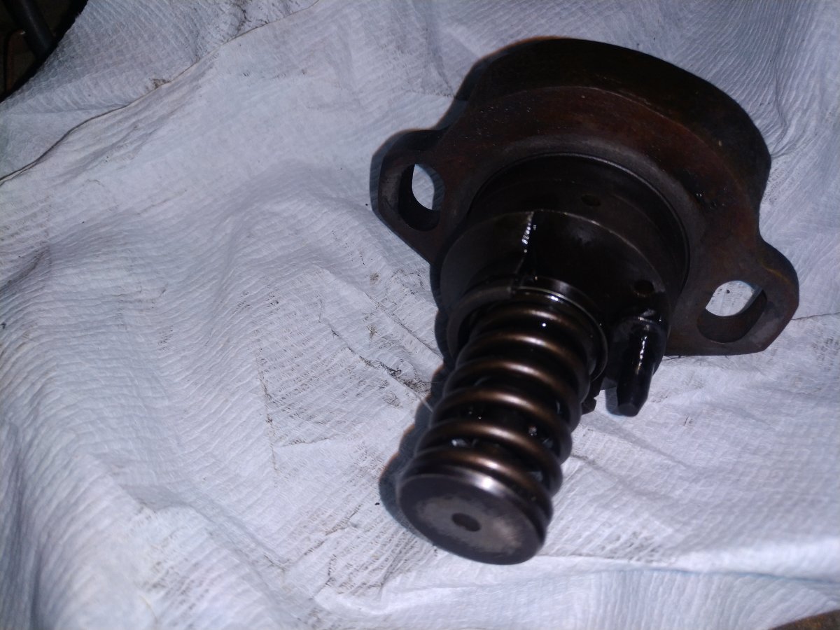

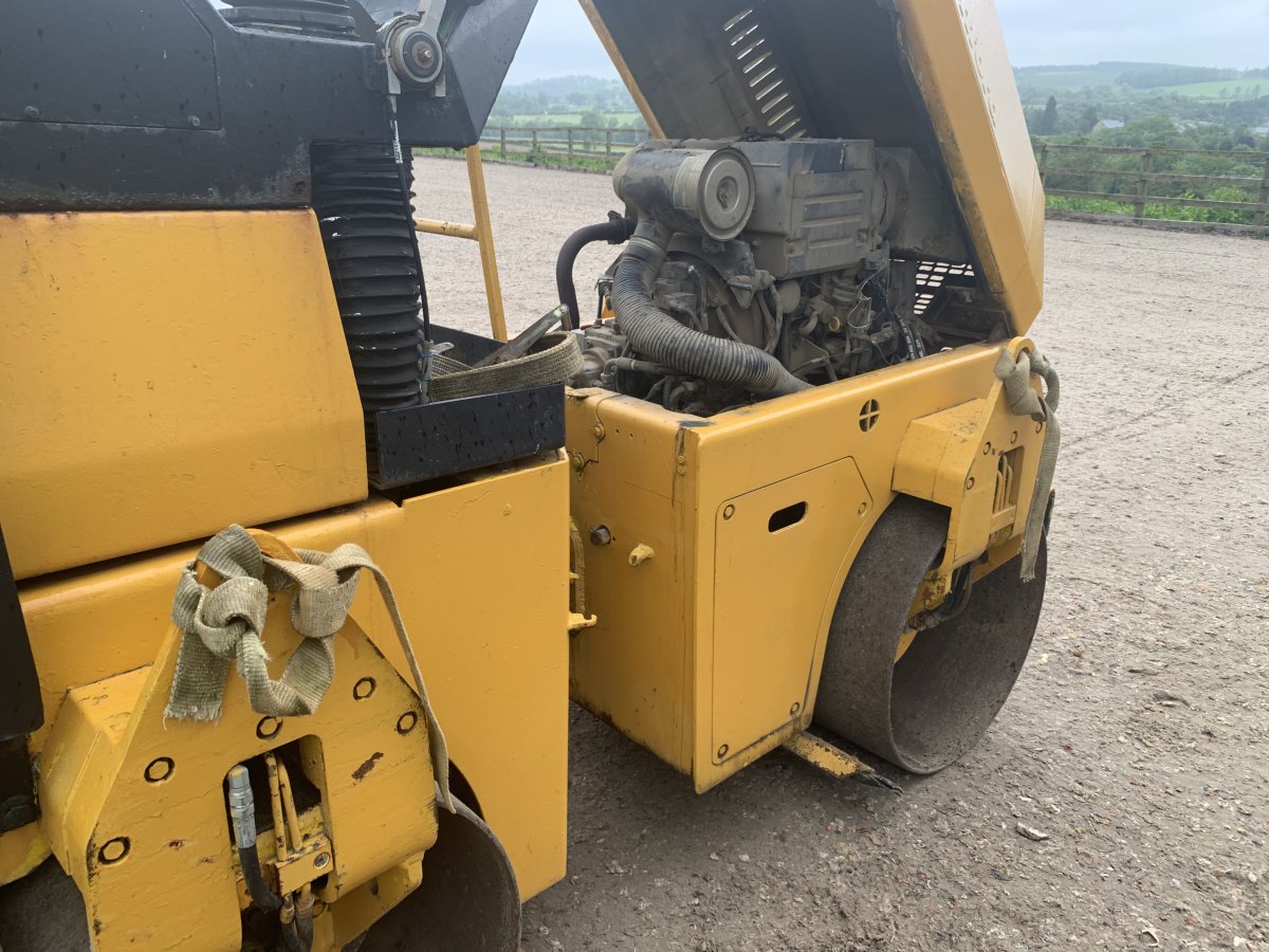

I sent the pump away for an overhaul.View attachment 14054
And I got her up and running again this morning 👍View attachment 14052View attachment 14053
