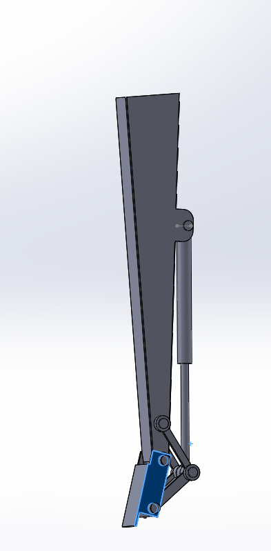

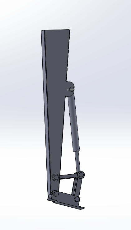

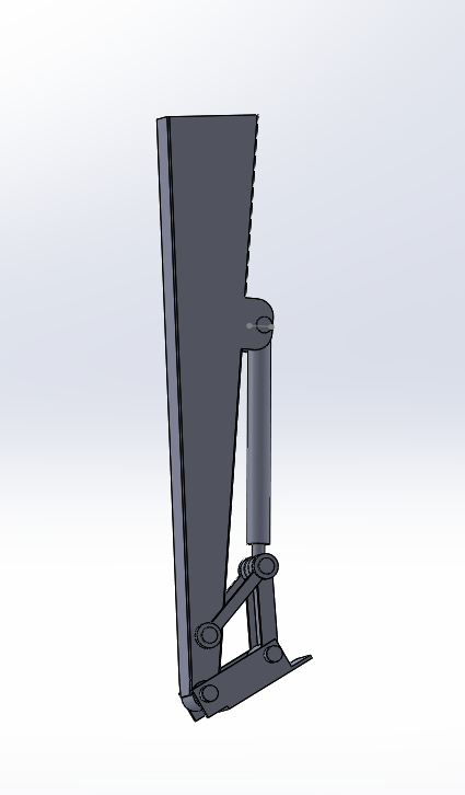

Yesterdays evening project - Modeled the dipper of the jz70 in solidworks. Still got to do the main digging bucket and finish the quickhitch though. it doesn't seem 100% right got to doublecheck the placement of the bucket ram but else seems good.

Normally I totally make it up as I go along or a small sketch beforehand that changes 20 times throughout the project but I wanted to see what it'd be like to draw it all first, learnt all this for my DT a while back can just about remember it.

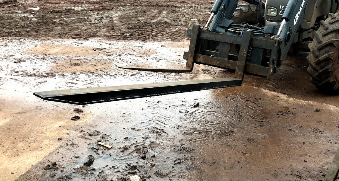

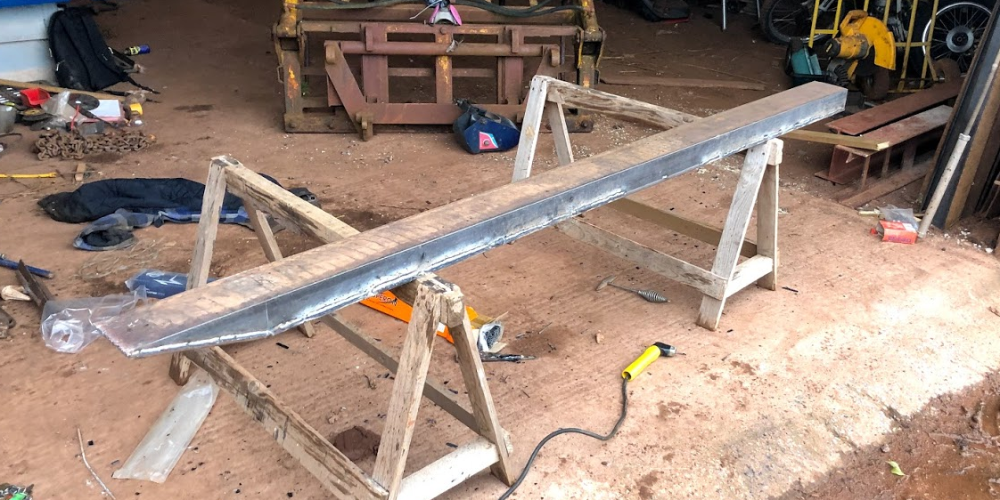

While looking for a photo of some quick connect caps I found a couple pics of some fork extensions I made a few months back, after someone bent the old ones (just rectangular box) into banannas lifting things they shouldn't done.

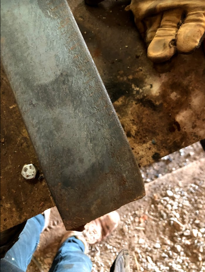

Scabby bit of steel this was, funny shapes in the milscale and not totally perfect, not square end and stuff. This doesn't capture how bad it was.
No photos of the fabricating but its none too complicated to dream up how I did it ;)
Didn't think about weight when I made them, probably should've because they're bloody heavy.
That bit of weld was finished too!
Still need to add two tabs with holes in for pins to keep them on the forks at the far end.

used to make a lot of these for the timber frame outfits I did a lot of work for ..... 150 x 90 PFC ... didn't put a full length under plate on them though ... just three tags for the forks to fit into ... thick ones ... kept the weight of 'em down ... and as said, couple of ears for retainer pins behind the fork heels
they must've had 10 sets of 'em littered about the factory .... saved hunting for a set when they wanted 'em ... 2 acre site full of timber frame panels and stock .... extensions were on/off like a whore's draws :ROFLMAO:
