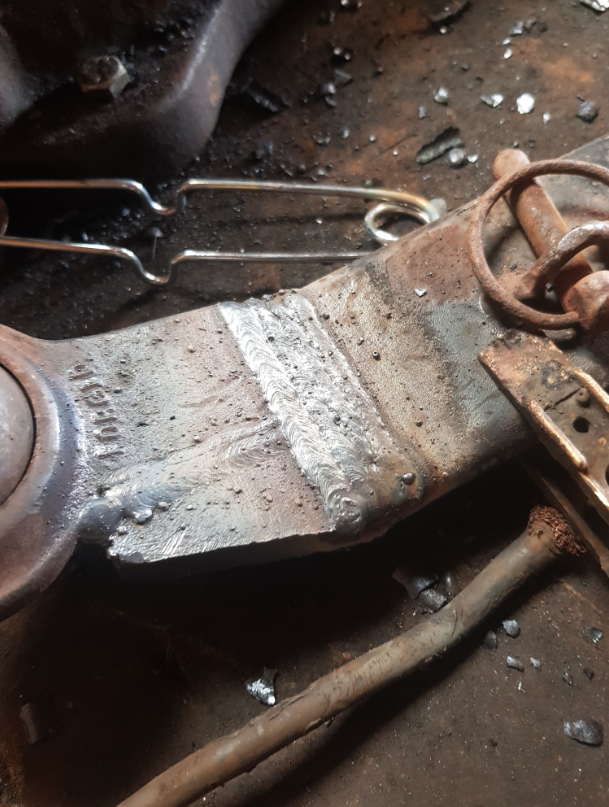

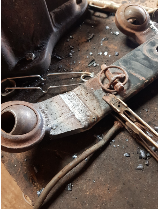

I thought no point messing with the image I'd already uploaded so here is some more work I got up to back in the summer... Same tractor, came with category 1 balls on the back, was swapped to category 2 balls years back, the 'slightly' oversized cultivator made the old welds fail. Time for some new welds and a bit of reinforcement, provided by the extra triangle I welded in at the top (bottom in the photos). All done with an ancient air cooled transformer buzzbox, before I got my new welder...
(still only at the beginning of the long path of learning to weld... any advice welcomed!)
Cut some nice long bevels with the torch and welded it up. Shouldn't drop off I hope!

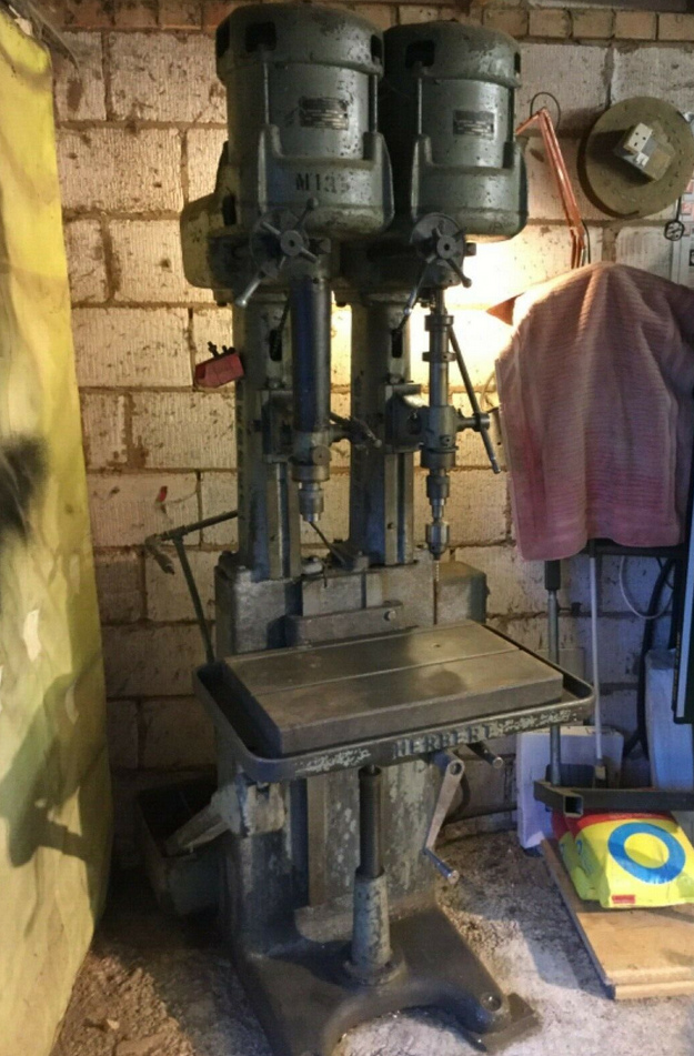

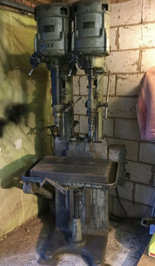

Brought a big ol Herbert 2 bank pillar drill today off ebay, sent the chap a message and it turns out he's got no way to load the bloody thing. Going to have to figure out how to load a 2 bank drill thats undoutbly a lot bigger than it looks into a 3.5t van. Hopefully the chap knows a farmer or someone near who can come with a telehanlder or tractor for an hour....

typical
gonna wanna be a hi top ..... most of those Herberts were about 8+ft tall !!
got a link .... some of the Herberts'd split at the table
where abouts you have to collect from ?

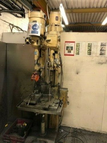

these perchance ??
going to be heavy ..... and very top heavy .. power feed on the one head

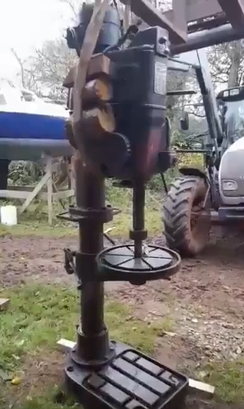

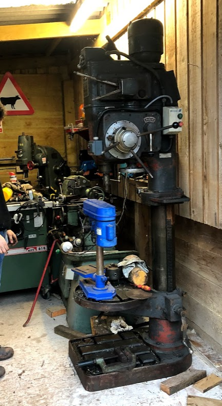

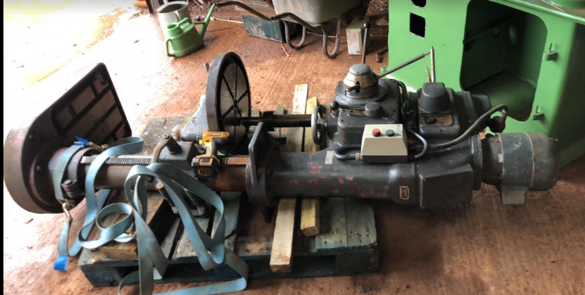

Not those. He's deffo going to have to be laying down. Moved an progress on a 'can you just' for a mate a few months back, He goes 'can you just get this pillar drill for me', about an hour away, turned up there and drill was 8ft tall about 400kg and the guy moving it didn't have a clue. wasn't what i was expecting whatsoever, gave me a bit of a shock when i turned up hahah.
Top heavy, gear driven progress. Lovely drill, prehaps oversized for his applicaton though hahah.
Was an interesting move thats for sure.

Worcester, this is the one.

Thinking that the plan is going to have to be find someone who can lend a machine up there, either that or I'll have to try my best to take it apart and move what we can by hand.... Will be a fun weekend out I daresay...

looks like either a 3 or 4E ....3E I think ...... bloody good drill
That sounds about right. Possibly a bit of envy that made me get this herbert... :oops:
Told myself I wasn't going to buy any more machines until I'd put the lathe back together... :ROFLMAO:
My thought is that they built stonehenge somehow so how hard can it be to load a few hundred lb of drill into a van...
hard enough ... without kit or damage :( .... good luck with it Boyo .... Pix please :giggle:

Get it near the van on rollers then roll it onto its back into the back of the van then slide it forward with ratchet straps and rollers?
