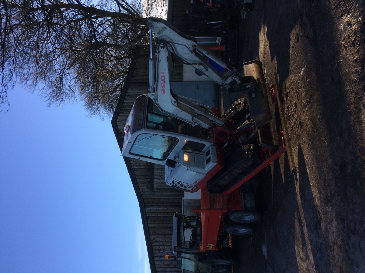

Devon. Yeah the Herbst ramps are lethal imo, it’s even worse with a 3 tonner as the idler wheel actually drops Slightly between the ladder rungs.. I had a bit of a technique to do it but coming off the trailer I’d always use the bucket to lower myself off the trailer on to the ramps- thing the digger would tip if the bucket wasn’t making contact with the ground! You have the bigger Herbst which is a bit higher still but slightly longer ramps.

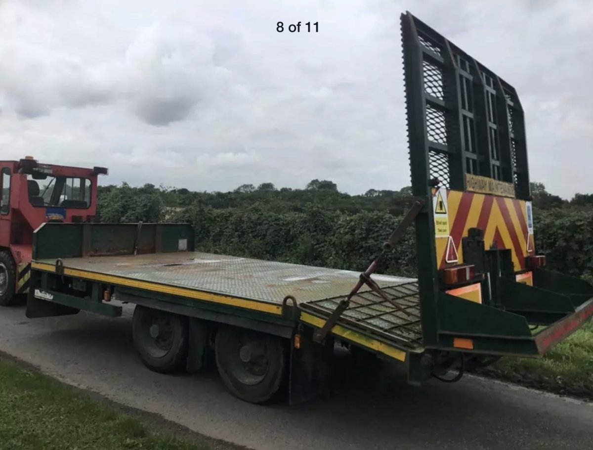

I bought this for moving 3/5 ton around local area

I’m sure that will be a pleasure to use after the Herbst! Thing is the multi purpose dump trailers are bloody handy! The 11 ton JPM I’m thinking of getting has 3.5meter ramps as opposed to 2.4m like the Herbst so I’m hoping that should be a good enough compromise for me over having two trailers.
Must be quite a lift getting that full width ramp up Giles? Is it spring assisted?
It’s hydraulic off tractor or 24v electric pump if on wagon, it’s a chieftain. It’s not landed yet so will tell you when it’s here lol
Oh yeah- just spotted the lift rams. Chieftain make good trailers IMO.
