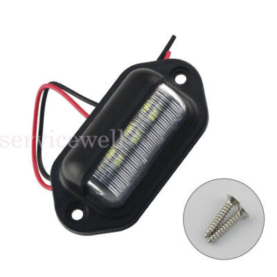

I'd bang an LED number plate light (or two) on there Shaun ... those festoon bulbs just DO NOT last or corrode so quickly they never work much more than a month
