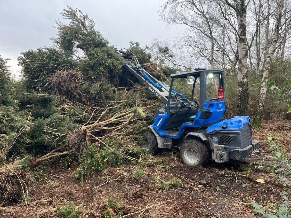

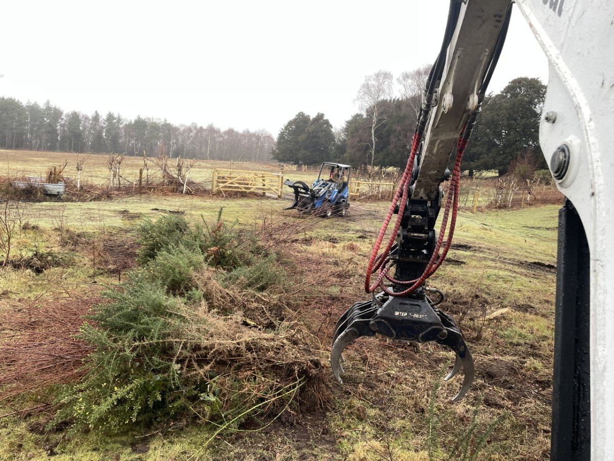

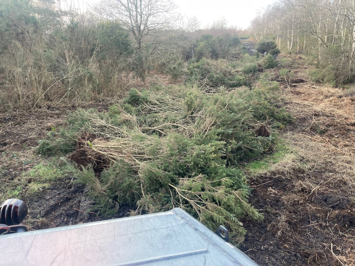

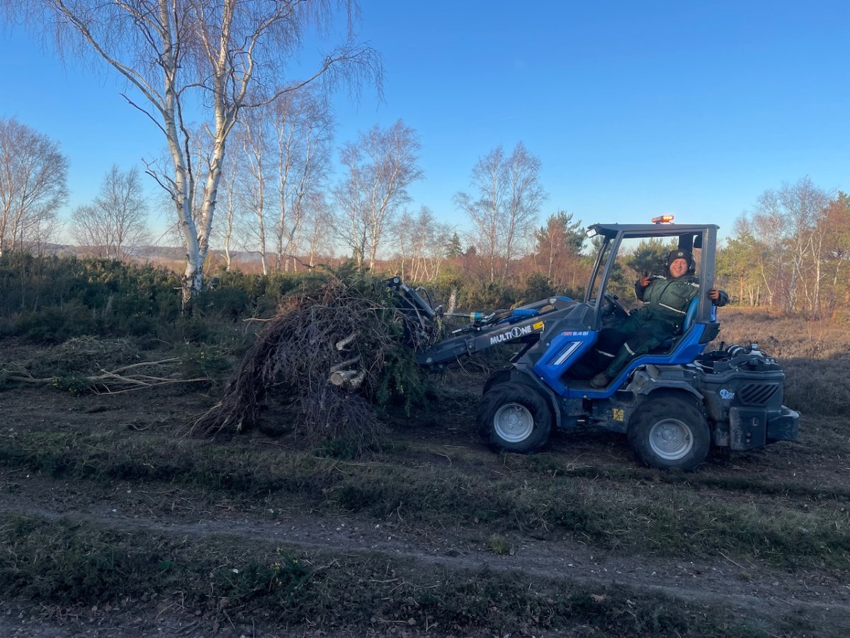

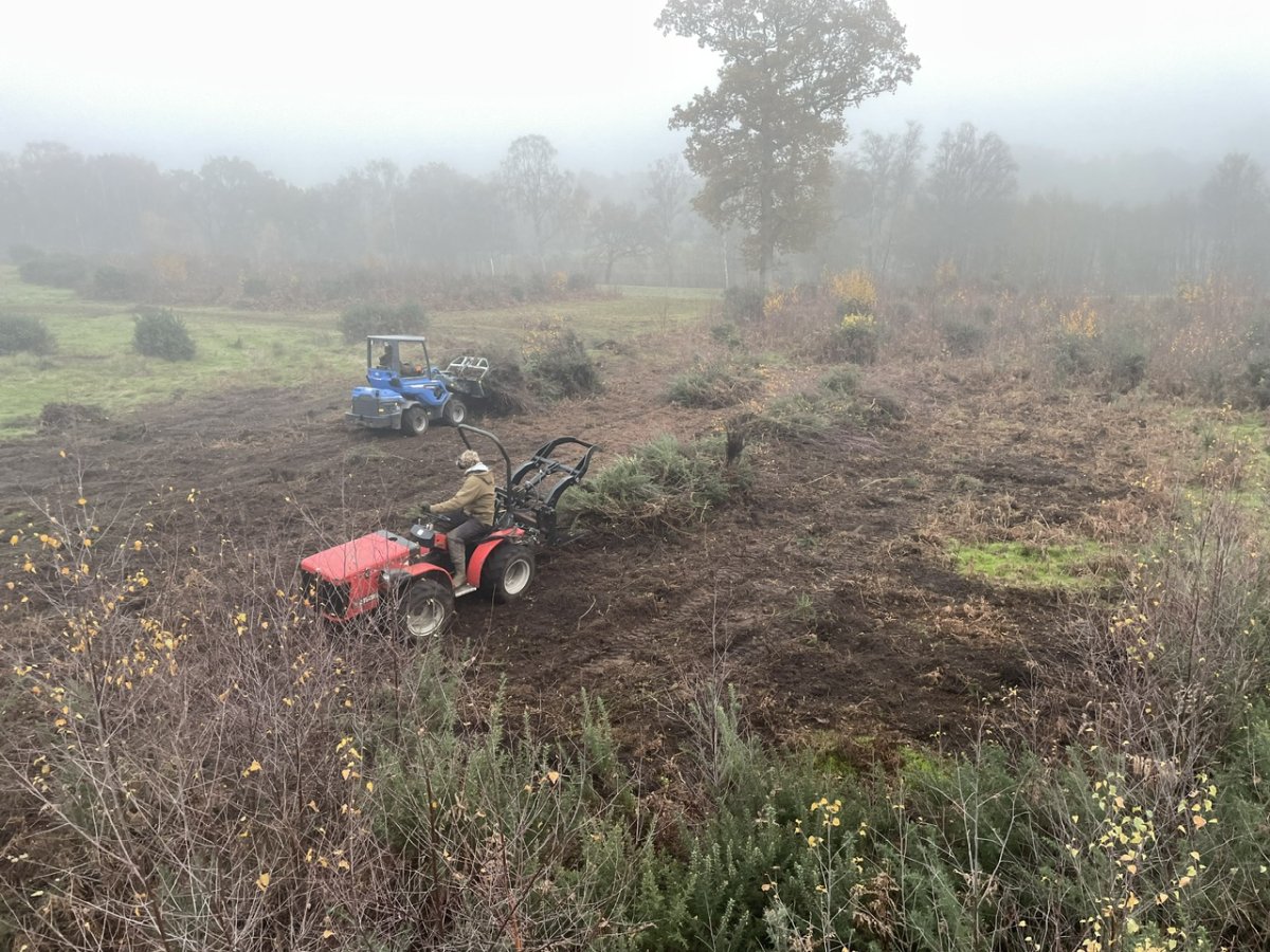

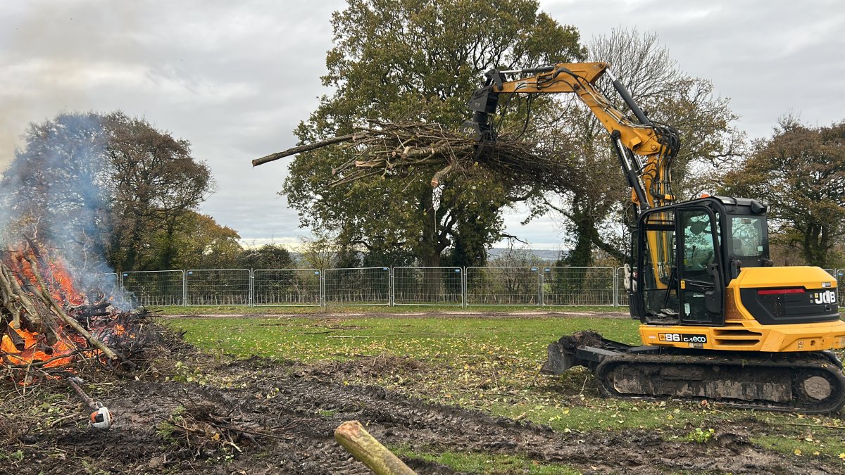

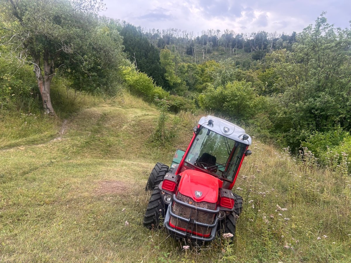

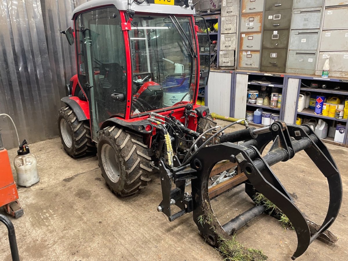

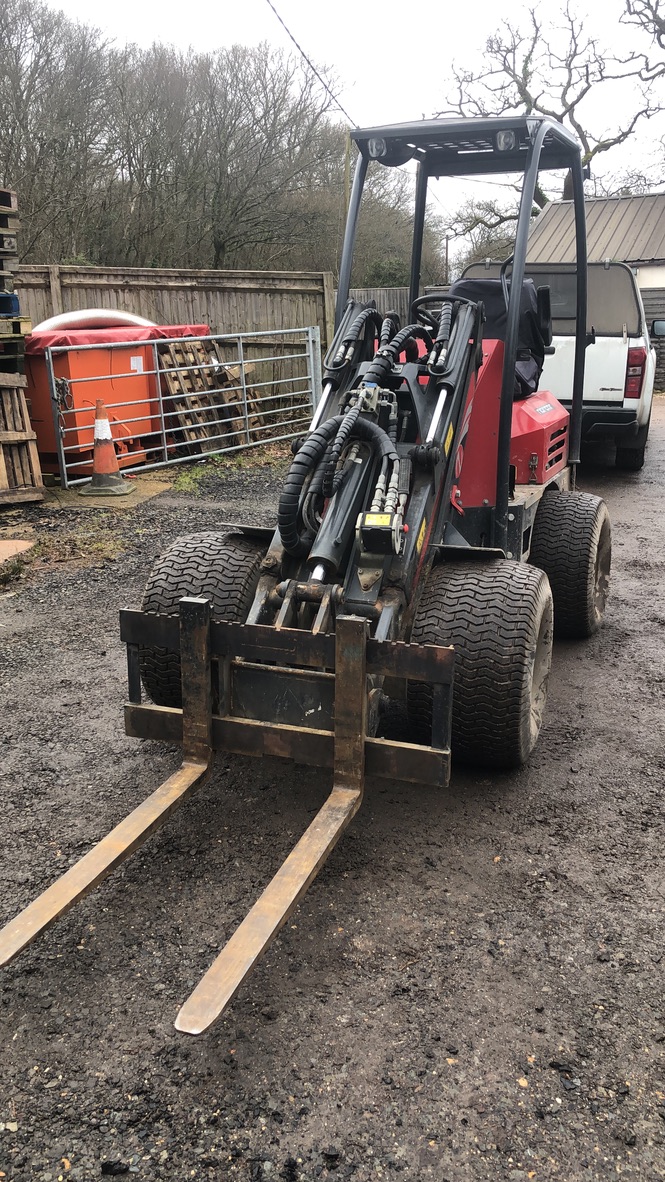

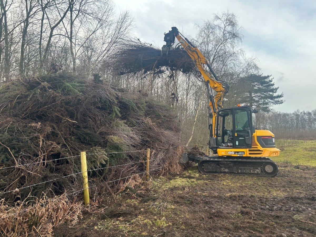

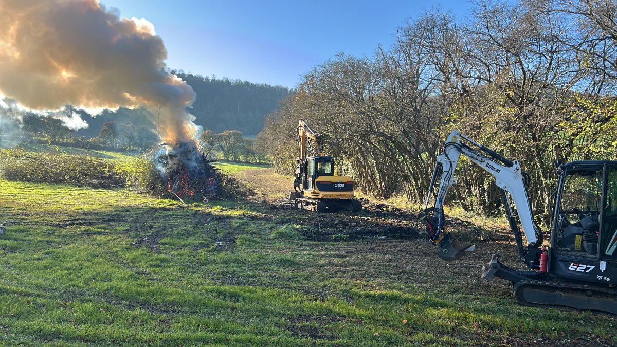

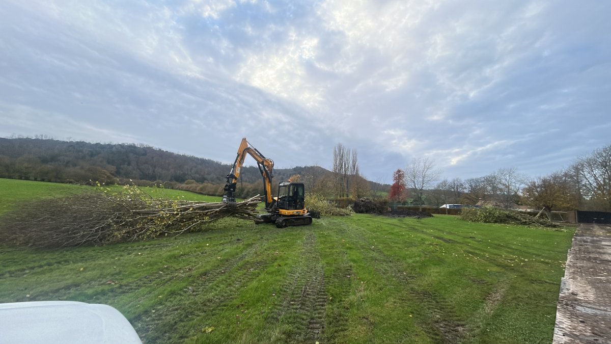

I use the multione a bit for that and also a euro adaptor on the alpine. They come into their own on heathland clearance when the stuff is around 8 feet tall and the drag distance a long way to a dump site. Especially the alpine which is much more comfortable- although the Multione can stack high, so swings and roundabouts as they say.
However neither of them will handle skidding whole trees or bundles of them and then hoofing them over a fence and stacking them neatly. Or placing them on the fire just right and then adjusting the rest of a fire bigger than the machine.
I’ve got double wheels for the alpine which help in slopes a lot. But you generally try to work down a slope, and if you leave brash bundles to collect it’s a nightmare to try to get them picked up again without the digger rotating grab. And it’s also generally a lot easier just to use the digger and grab full of brash to counterbalance yourself than to try to use a wheeled machine on slopes.
You also get a ‘bonus move’ when using a 360- the slew and reach at both ends of the drag can be performed whilst on the move and is a large component of the total distance on a shorter drag.
Basically it all depends upon the length of the drag. But brash needs a grab of some sort to move it, and a dumper shouldn’t even be up for consideration. I’m happy to change my final drive oil every time I change the engine oil and buy tracks a bit more often for the efficiency gains.

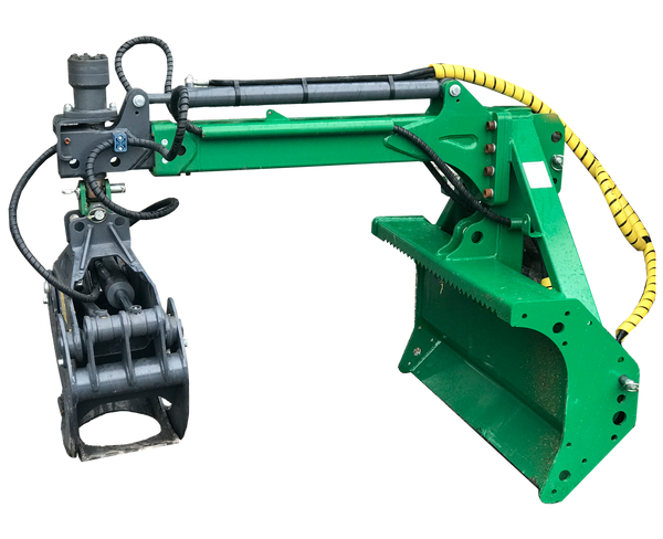

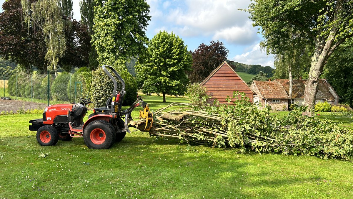

As an aside, have you got a skidding grapple for your alpine. That would be quite useful on the whole tree stuff if you have a second person with you.

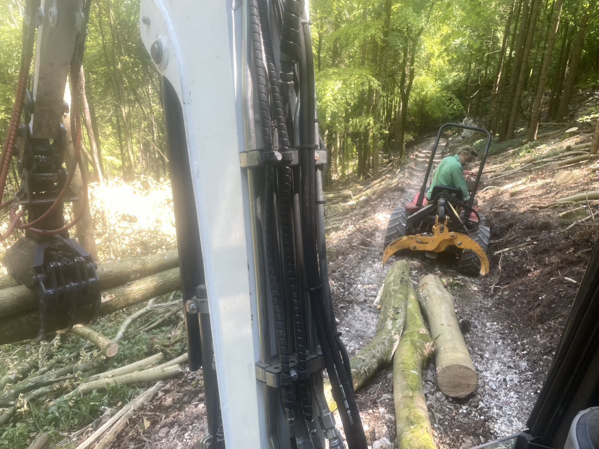

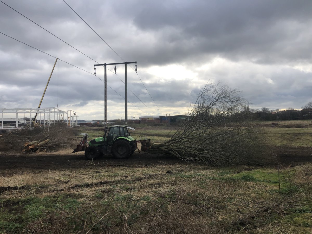

I use skidding grapples quite a lot on site clearances - can move a massive amount very quickly, and it’s really fast if there is someone else on a machine stacking.
Yes. Big fan of the grapple, also on large garden type jobs with a central chip/burn location. Very little mess. It’s good for tree length stuff or tight drags.
But with pulled brashy type stuff a larger grab lets you get a lot more in, so long as it’s all windrowed parallel.
I have a ‘Trigger’s broom’ grapple that has been bent/snapped/modified numerous times (the only original part left are the actual tines, which have proven to be incredibly strong!). It opens really wide and doesn’t ever let go - will take much bigger bites than any grab mounted on a sub-30 tonne machine. That in combination with a tree shear clears and ‘forwards’ an incredible volume of material in short order.
Definitely the way to do those kind of clearance jobs!
Most of my jobs are smaller and less of a drag.

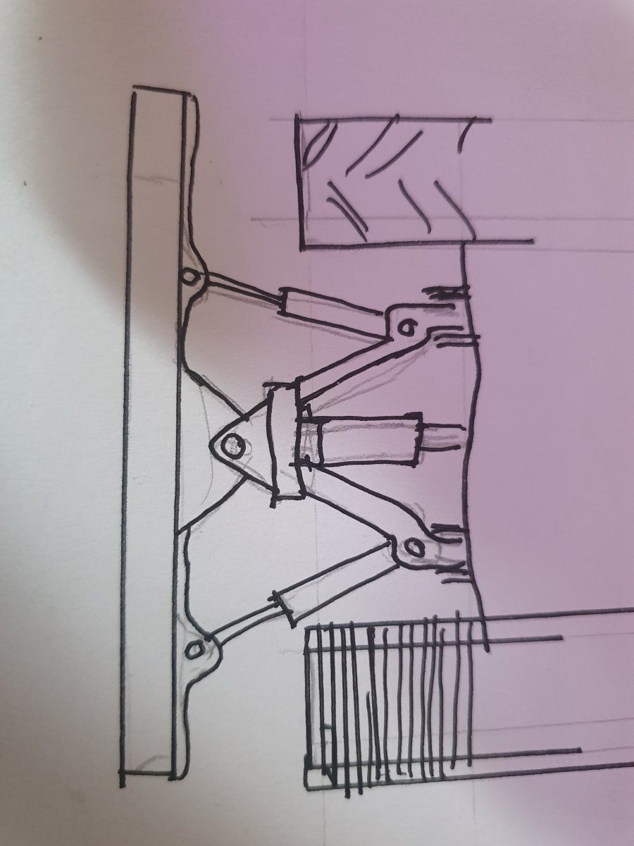

I'd be doing something like this 🤔
The machine is a keeper, the JCB design is not at all elegant, and ideally you want even tracks with no restriction on the functionality of the blade 😀

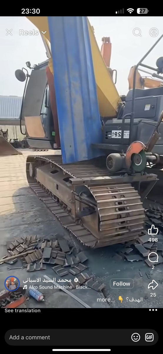

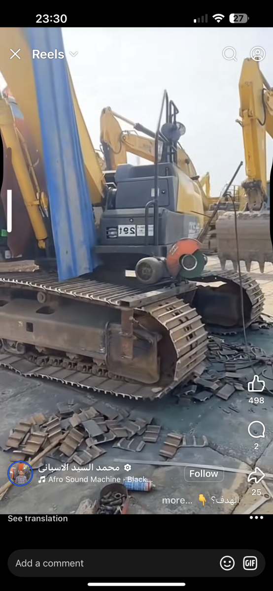

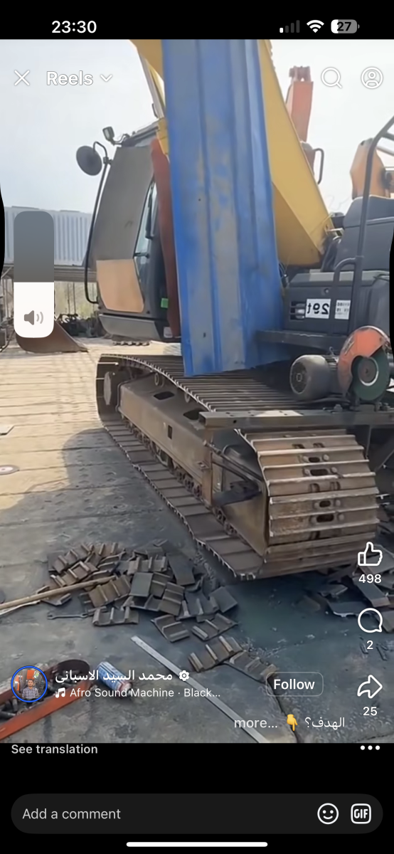

Saw this thought of you for cutting tracks down
16 ton is on 800s and that does pretty well on the soft stuff but does sink on seriously wet stuff
