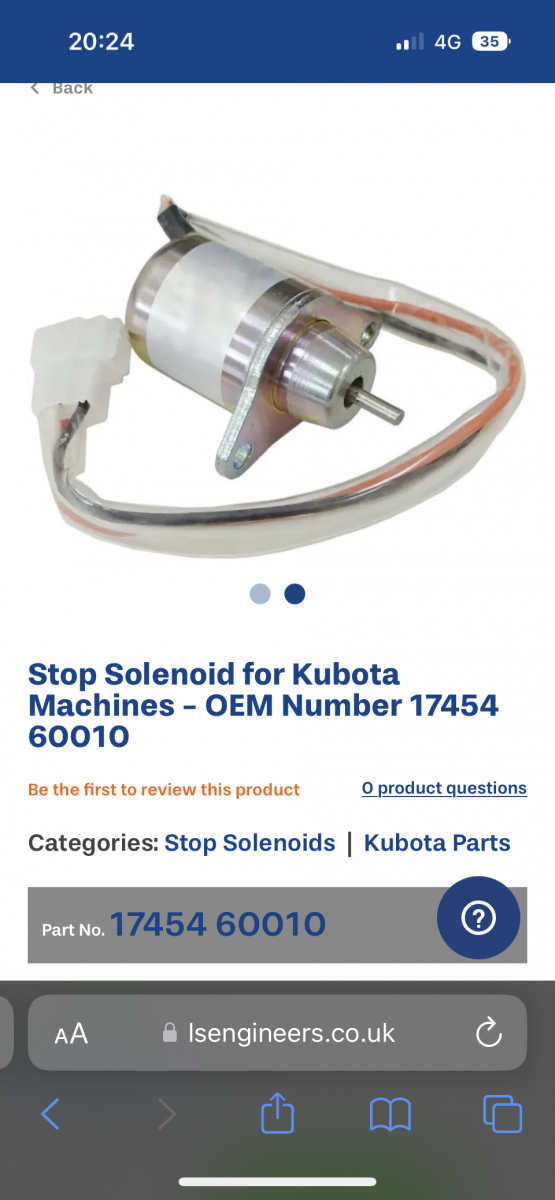

4000 hours is still a fair bit if not maintained well. It would be considered long in the tooth for that size machine.Normally takes 30 - 45 mins to clear in the morning then once it gets hot and starts stalling it’ll chuff now and then there’s a injector man just up the road so drop them off and get them all refurbed and I’ll order a fuel stop solenoid see if that does the trick

Fuel rack stuck? Did something go wrong with the solenoid install, i'd be checking both parts are the same dimensions?So finally got the new part put it on tonight and the machine is running at full revs? Turn throttle down still full revs lift the arm still full revs any ideas? Or is it just wearing it in?
