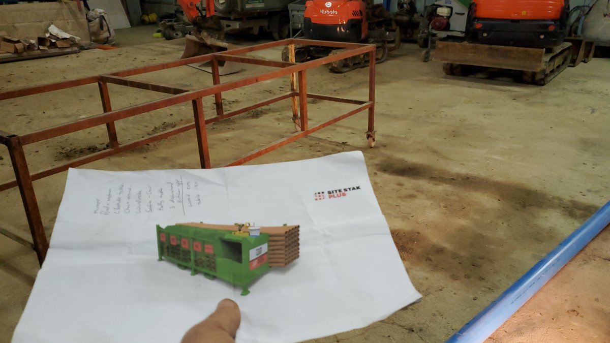

Like the idea and quite a saving on the site Stan.View attachment 32408

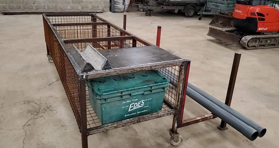

Nearly there ....bit of armco for the 'u' of a pipe holder works lovely and nips the pipe up and grips it when your mits on the pipe and push.
Made it into 5 mesh bins and the open end to put that plastic box we keep small fittings in.
Paint next and lifting eyes when I've messed about finding the best points to put them when it's loaded.
Might not be quite as posh as a "site stak" but it was 200€ a few rods,disks and a couple of rainy days messing.
Will test the concept for us without a 2k spend.
Left the wheels on because although not ideal on the job it means can you roll it around workshop.
Nope but then if 3t won't then the 8t should ....if not I'm bolloxed getting it to siteLike the idea and quite a saving on the site Stan.
just not sure the 1.7ton Kubota will be big enough to move it around!!![]()
Nope but then if 3t won't then the 8t should ....if not I'm bolloxed getting it to site![]()
it'll be fine ... just don't fill the bloody thing to the gunwhalesI get it I get it .... too big init![]()
Might end up at yard as storageit'll be fine ... just don't fill the bloody thing to the gunwhales![]()
'til you bang yer shins on the bloody thingsMake some hooks on it so it hooks over the blade it’ll be grand![]()
Getting it off on the hookloader will be the tricky bit but yep maybe some that would do for 3t would maybe work, thing is with lifting eyes is the variable weight distribution depending on whats in it....and not easy to lift from each corner because the legs for the pipe rack part wouldn't last long being pulled inwards towards à central lift point.Make some hooks on it so it hooks over the blade it’ll be grand![]()
Retractable ?'til you bang yer shins on the bloody things![]()
