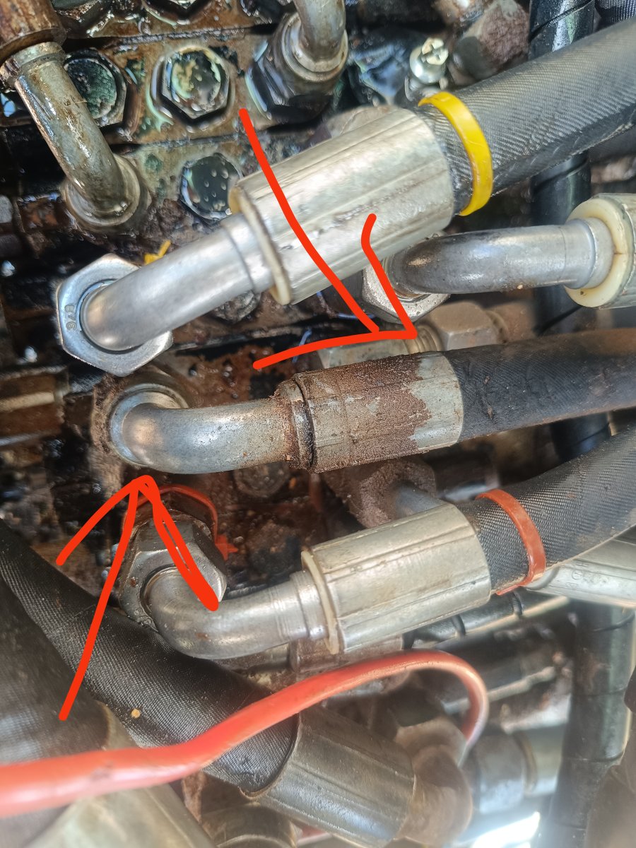

Sorry for late response,i had some guys from Bosnia to repair it but they didnt want to tell me what he real problem was,they just said the angle on the hydraulic pump was set wrongly
