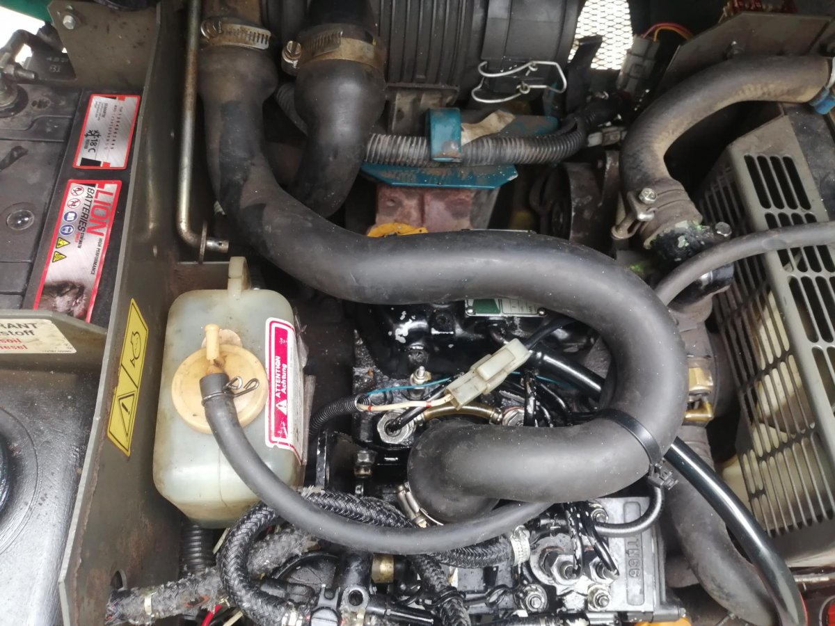

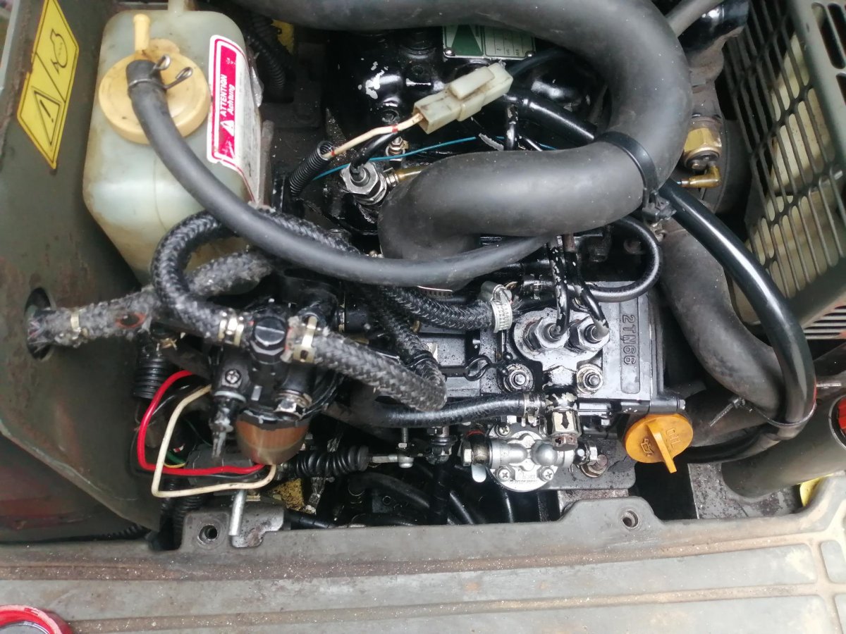

machine side of the solenoid. so earth and then the other 2 must be as you said. That green wire runs to the electromagnetic relay switch shown below...
in this pic we have the relay switch with the cover off (the one i manually operate for solenoid) and that on the left is a timer apparently, according to diagrams online:
so far im thinking that this timer may be the issue for not sending signal/power to operate the relay switch. can't see any breaks in the cable. I don't get why it suddenly stopped working :confused:

had to read this a couple times :LOL: yes that sounds right. it seems that red/white wire is not doing its job in activating it. I will try putting a live feed to it as suggested. in the mean time here are some images of where some of the wires lead to...
starting with the HD relay as you called it (what does the HD stand for?)
following the red...which is spliced and taped to 3 other red wires....
2 lead over to near the battery...1 goes to this other type of relay thing
and the other goes to this fuse
the 3rd red dissapears into the footwell and im guessing goes up to igntion or something
sandbags89
now following wires from the other 'timer' relay
the back 2 go to the hd relay as shown in previous images. the black is just earthed to the body...
the yellow w/red strip...leads to here where it is crimped with 3 otherswhite white
white and black leads to mystery device
the yellow and black on the rightside of the crimp goes to the solenoid connection...
the yellow and black on the left side of crimp goes back up to this connection for the fuses
i hope those images made it clear enough
