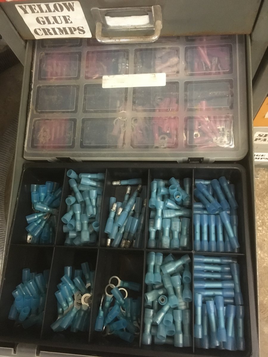

What you need are heat shrink connectors.
Costs a bit to get a full set together but then they're there when you need them. They have solder inside, and glue filled heat shrink on the outside. You crimp them, then use a heat gun on them. I've never had one fail. First time I tried them I made a ring of wire up, joined with a butt connector. Pulled it apart with my hands- the wire failed, the crimp didn't. From then on I was sold and have used them ever since with no issues whatsoever.
