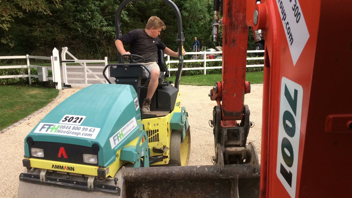

I cant find a picture of it, but pretty sure with most of the whites hitches I've used, the bucket ear to ear measurement isn't as wide as the actual machine itself. So if you wanted to direct mount it, you couldn't. All the JCB stuff I've got would fit under the hitch or direct mount, and the extra width really helps reduce play.
Edit - found a pic of what I mean. Bucket looks narrower than the dipper? I have a video of this machine. 300hr U17 with inches of play in the bucket.

That’s just ridiculous

Like Nick says, thats mad. I wouldn't be buying one anytime soon
I recon it might fit on. Just look at the gaping casum on the dipper to the hitch.
If you eye down the actual dipper to bucket it doesn't look far off...but I'm only looking on my phone so might not be as good as those looking on a pc.
Also the hire firm may have had a mix and match hitch done??

If thats right its an odd one ........you can pin whites buckets straight to onto my - u17.

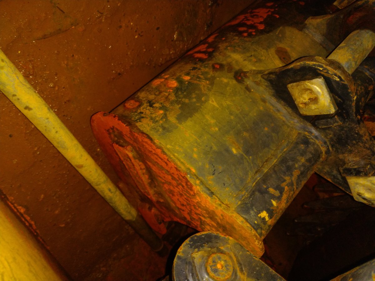

Not the best pic but couldn't get at it (didn't realise the skips were full of water till moved them earlier 🤔), mine is just a straight bar with a circlip near the end, although don't know why they bothered going to the effort of fitting it, as it doesn't even go deep enough into the hitch to touch the circlip 🤔
The rhinox one is alot easier to mount somewhere.
Not really anywhere to put mine on the micro, suppose I could cut it down and put it in the manual holder.
Have seen a bobcat with similar one to the rhinox mounted boom side of hammer pedal and the tb210r I had a look at 3 years ago had it fixed to the side of the boom.
