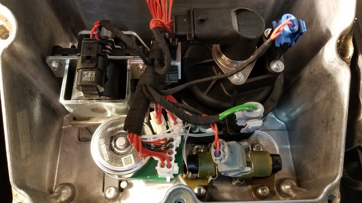

It just shows how dealers can be robbers the real question is what would they have tried to pin it on when changing the pulp didn't help
Well I think their quote
meant changing the whole unit - inside the unit is the pump/filter /filter housing and some other gubbings - so the question is I suppose is would they have opened it up and spotted the fact that it was just the filter housing and replaced and just charged for that ? ... the guy gave me the impression that they unplug and change the lot.
Photo shows inside the housing ... pump - filter etc
Well I think their quoteView attachment 11380 meant changing the whole unit - inside the unit is the pump/filter /filter housing and some other gubbings - so the question is I suppose is would they have opened it up and spotted the fact that it was just the filter housing and replaced and just charged for that ? ... the guy gave me the impression that they unplug and change the lot.
think that would be far too technical a job for today's 'box fitters' that pass as garage mechanics ... the days of a diagnostic fitter are long gone, :cry:as i have said before elsewhere:rolleyes::( ... fit what's in the box .. if that don't cure it, un-box another bit :mad::mad:

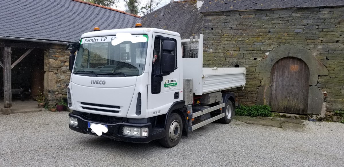

Only had it a year Its not a new truck 2010 - euro 5 - 160,000 kms Got it made up from a chassis cab - (previous life delivering between depots and was well serviced up) had a new jimeca hook and skip put on it -good paint job and and a general going over - and items replaced where needed ( but looking at the adblue filter not sure if that had ever been changed)
Didn't really want iveco but as I've said before on the forum over here we really struggle over to get what you want and have to take what's available.
Does our job nicely - very handy been able to put skip on floor .... one of those no going back scenarios- Use it daily but dont travel far - 45mins is max - done 13k kms this year.
Nice not to have to trail the trailer round every day as I did with 3.5t tipper

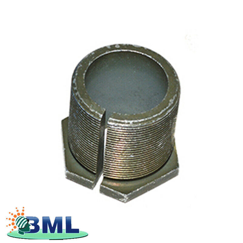

and not just the dealers ...... been pricing a little collet nut for the P38's swivels ... LR only .... no one else does/makes 'em ..... got prices ranging from 22 to 48 quid, each, plus the vodka, for the same item. ....... LR's price is over the ton for the same thing ... :oops::oops::mad:
M30 x 1.0mm ... can just get a finger in it and about 34mm long ....... bloody ridiculous price for a mass produced part ... and was a bastard to get out

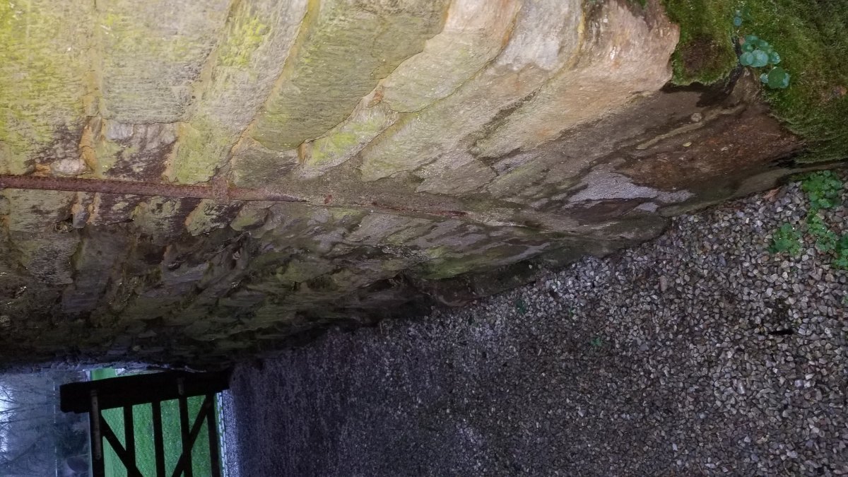

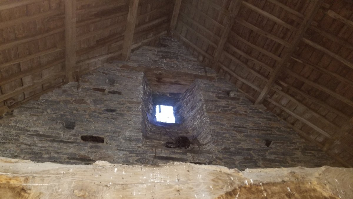

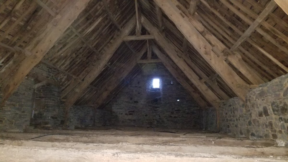

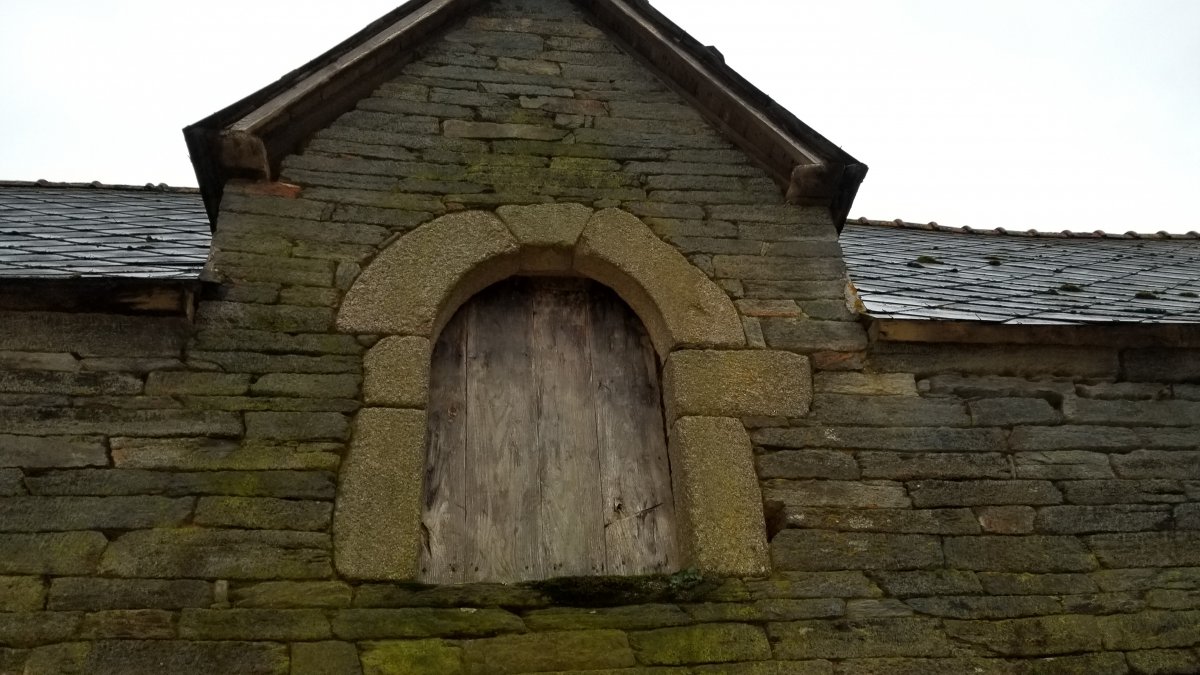

this looks to be an impressive bit of stone masonry too ??

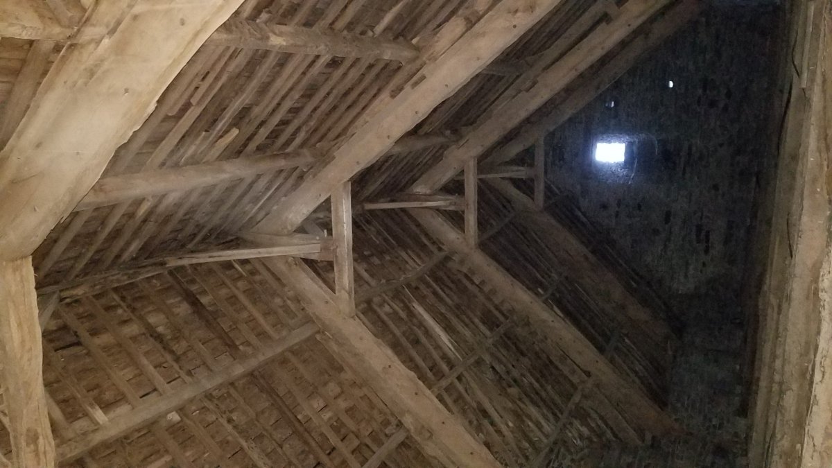

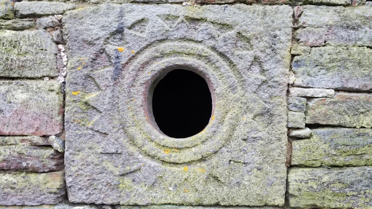

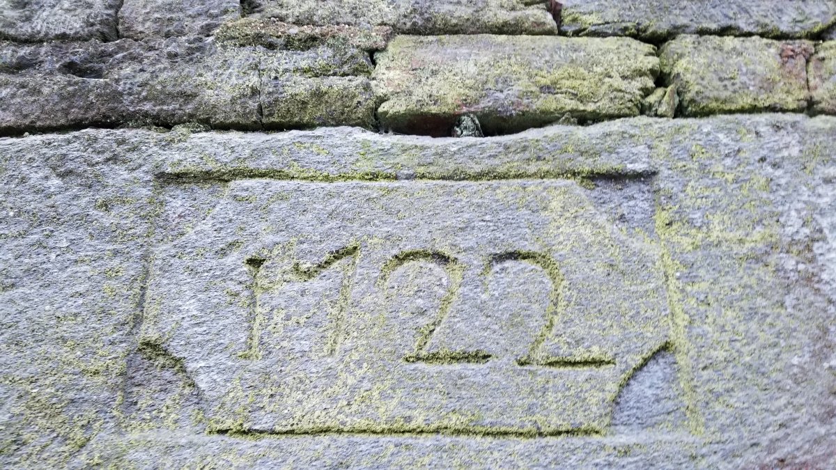

Few outbuilding pics - there is an inscription in the Breton language that tells that it was built (commissioned) by a woman in memory of her husband.
Used to be thatch which I believe shows in the way the trusses have been built upon to compensate for the lack of thickness in the slate construction.

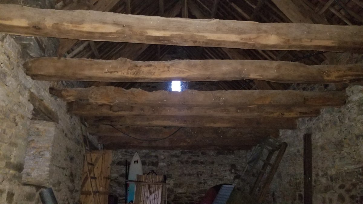

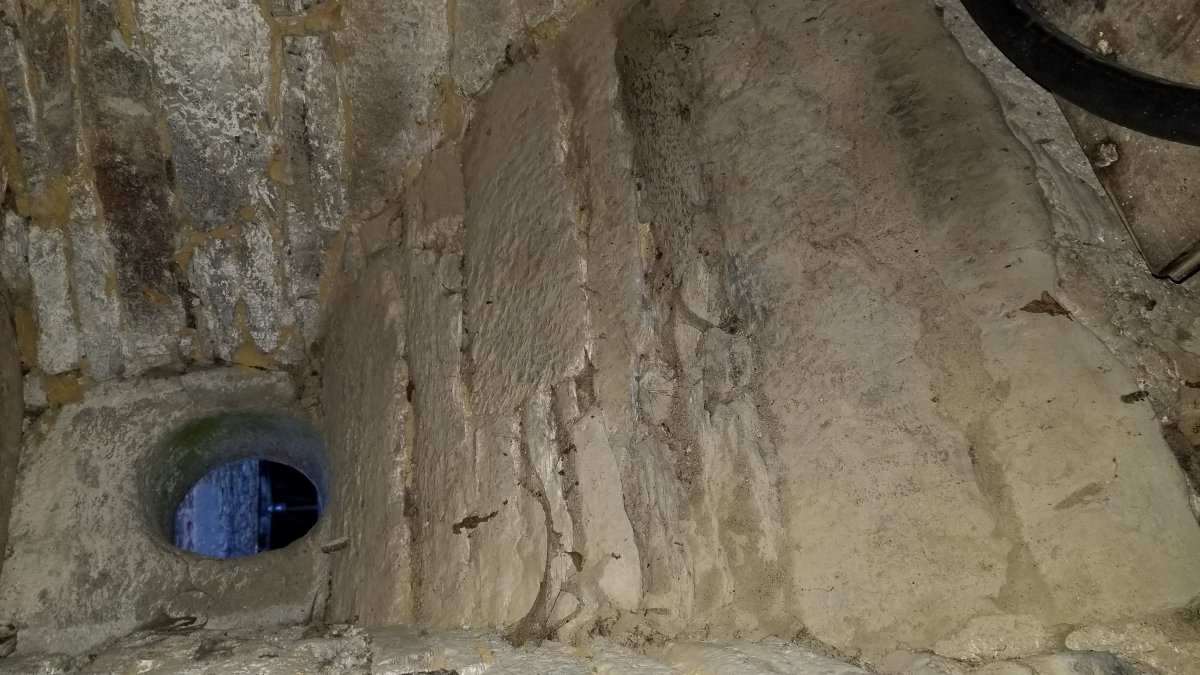

The hole was apparently there for feeding the stock inside - the inside is sloped down so food doesnt stick and ends up in a trough which was below.

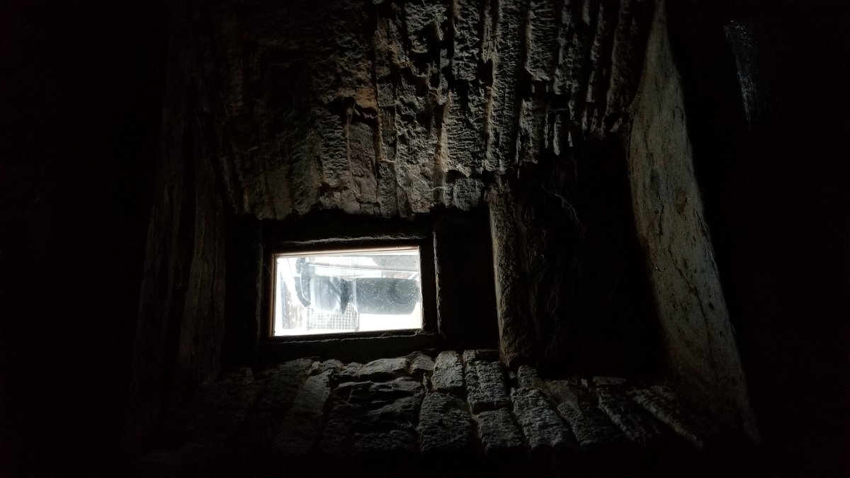

Farmers that came after had no real care for the building and knocked some openings in the back wall and shuttered them in concrète - occassionally I get a bit of time to try repair what was done - knocked all concrète render off inside to let it breath - repaired an opening at back that had been a small window with granite quoins - they had knocked it to twice the size but done the other half in conc..... I removed the conc and redid it in reclaimed quoins off a démo job.
Some photos
